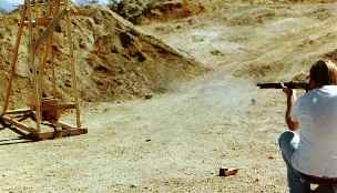

    Over 30 years ago I was sitting around with my Dad and some friends and we were discussing the subject of hitting power. We decided we would experiment a bit. It gave us an excuse to shoot! We went out in the yard, nailed an 8 foot 2x4 onto a log that weighed about 20 pounds and hung it from the clothesline. We shot a few guns into it and were mildly surprised that none of them moved it very far. The .300 Winchester Magnum only moved it 6" or so! (all the bullets stopped in the log so it soaked up all their power) Dad took a 20 ounce claw hammer and whacked the end of the log as hard as he could and it moved it about 6". So we concluded the .300 Magnum hit about as hard as a whack with a 20 oz. claw hammer. Now that is nothing to make light of. But it isn't nearly a ton and half as the kinetic energy figures would lead us to think.

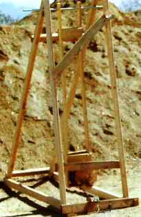

    I decided to get serious about this - this was in the ancient days before personal chronographs - so we built a frame from which we hung a 48-pound mesquite log. It was hung on a 6-foot long arm and had a tape fixed to it to accurately measure the movement of the log. The log stopped all bullets fired into it. We figured out what loads we were going to shoot beforehand and had bullets of equal weight on the log. When one was fired into the log, one was removed keeping the weight of the log the same. It probably was unnecessary, but that is what we did. What we found was that some handguns hit just as hard as rifles. This confirmed observations on game in the field.
    If you watch the Anite Productions video DEADLY EFFECTS, the producer of the video takes a point blank shot on a vest with .308 Nato ammo .. WHILE BALANCING HIMSELF ON ONE LEG! Just to prove that the actual hitting power is not all that hard. It don't knock him down. He actually does it twice on the video just to make the point.
    I know someone will bring up the fact that the energy is "dissipated" over time and distance, or other such arguments. Think about it. The bullet STOPPED on the vest. All energy was expended. The .308 has over 3000 ft. lbs. of muzzle energy. Over a ton and half. Even if the bullet "lost" a ton of energy magically, somehow dissipated into the vest, it still should have enough power to knock over a 175 pound man balancing on one leg!
    In our tests shooting the log, the log absorbed all the energy the bullet had, even if it did take a few hundredths of a second. Don't try to argue that X amount of energy gets turned into heat, while X amount of energy moves wood particles or peels the jacket back or whatever. It's all inside the log and happens in an incredibly short space of time. Even if 3/4 of ton of that hypothetical ton of muzzle energy was siphoned off by the bullet coming apart in the log, 1/4 ton of energy should still move it more than an inch or two!
    We did not actually prove anything. However it was fun to do. What we were measuring is called "Momentum Energy" by those who are better at math than I. Momentum is the amount of "push" a moving object has. Obviously the weight of the moving object is a big factor, influencing the results more than velocity. With kinetic energy figures velocity is the big factor which influences the
    Above - a much younger Jim Taylor firing an 1886 Winchester 45-70 into the log.
    The pendulum
    results. There are other methods of figuring hitting power, such as the "Taylor Knock Out" theory. It favors caliber. All such theories have their drawbacks and limitations. They are part of the quest to find a way to put down on paper what we observe in the field.
    And... all the different ways of measuring a bullet's power are interesting. The best way though is to get out in the field and do it up close and personal.
    Recorded Movements of a 48-pound pendulum on a 6 foot arm.
    (All shots were fired at 15 feet from muzzle to the pendulum)
