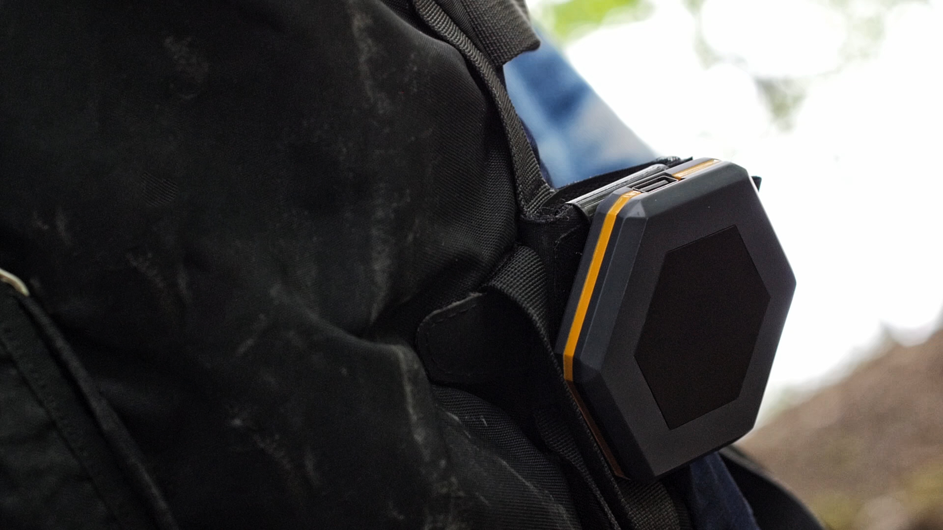

    We invented the Sonnet. Without relying on any infrastructure, Sonnet powers on average 5km communication to:
    - send text and voice messages (privately or in a group)
    - send image, data and files
    - share, mark and track GPS locations
    - for free!
    Our mesh-networking function can also increase the effective range by multiple times.
    Sonnet is $89 per pair. And again, no further cost.
    Sonnet will allow us to always communicate with each other no matter how harsh the conditions are. Multimedia+GPS will also improve our communication efficiency for better team coordination. With mesh-networking, Sonnet allows people to build personal off-grid communication networks that are robust and free of charge, independent from goverments and corporations.

    Yes. Sonnet, BearTooth, and GoTenna (plus Gotoky from Netherlands and Telewolves from China) are similar kind of device. Some of them, like Beartooth, never delievery their products many years after they took crowdfunding money from backers/customers. GoTenna delivered their last product and their new mesh-networking product has just been out.
    Here comes a detailed comparison between Sonnet and Beartooth:
    1. First and foremost, we are different people.
    They were severely delayed in delivering the product. A quote from their website back in April 2016 says "By placing this pre order you acknowledge that units will begin shipping in late 2016…”, their current website says that it will be delivered by August 2017.
    Our CTO is a PHD who used to work in senior r&d position in Motorola. All the Sonnet engineers are graduates of University of Waterloo and University of Toronto, two top STEM universities. While on Beartooth's side, it turns out their CTO is a fresh graduate from Montana State University-Bozeman. (ask me for the linkedin page if you want to see).
    2. Sonnet uses Wi-Fi instead of Bluetooth
    a. App works right in the browser (Web app). This means that you don’t need to download any apps to use Sonnet. Prevents catch-22 cases where you can’t download the app that’s required to use Beartooth because you don’t have Internet (But why would you use Beartooth when you have Internet?).
    b. Allows multiple smartphones to share one Sonnet instead of one smartphone one Beartooth. useful if people travel in groups.
    c. Works with both smartphones as well as laptop computers
    d. Feature we plan to implement in the future: Sharing Internet access between smartphones. This is not doable with Bluetooth.
    3. Physical Characteristics
    a. Sonnet has IP66 rating.
    4.App
    a. Supports image transfer as well as ALL forms of files
    b. Can be used within a Web browser without installing any app
    5. Mesh communication protocol
    a. Sonnet is built on top of open industry standards which is already deployed in millions of devices (well-tested)
    b. Sonnet Supports IPv6 (Internet-sharing between devices is possible)
    c. Lower cost
    d. Longer effective range: our protocol allows messages to be relayed up to 16 times, vs 3 times max for GoTenna’s protocol. Unknown how many times Beartooth can do.
