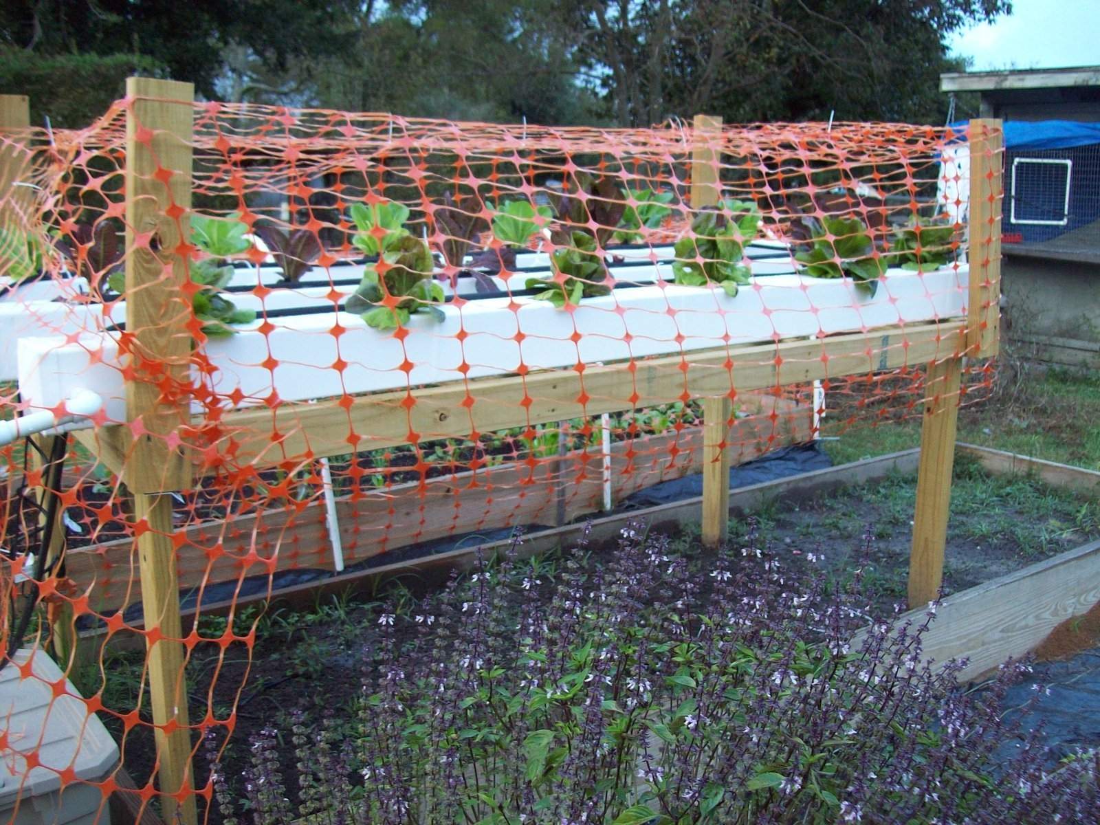

    Ok, mental note, I started the rail system up this morning 10/11/15. Using Rabbit compost tea, 3 gallons and
    17 gallons of well water , and 1 good handful of Epsom Salt. All seems to be working fine got a filter bag on the return pipe and an old nylon wrapped around the pump. Planted Radacio, Red Romaine and reg Romaine. 18 Plants total.We'll see what happens.
    Before anyone gets to it, NO, it's not my Nylon it was my wife's!:eek:
    Motomom34 and Mindgrinder like this.

  17. Gopherman
    Day 4; had to put mesh up so I wouldn't have to kill all my chickens and turkeys for eating my lettuce!
    All seems to be well, no dead plants yet!

  18. Gopherman
    Progress report on Hydro Rail System:
    Still no dead plants! It has been 17 days so far so good! Earthbricks 2 004.JPG

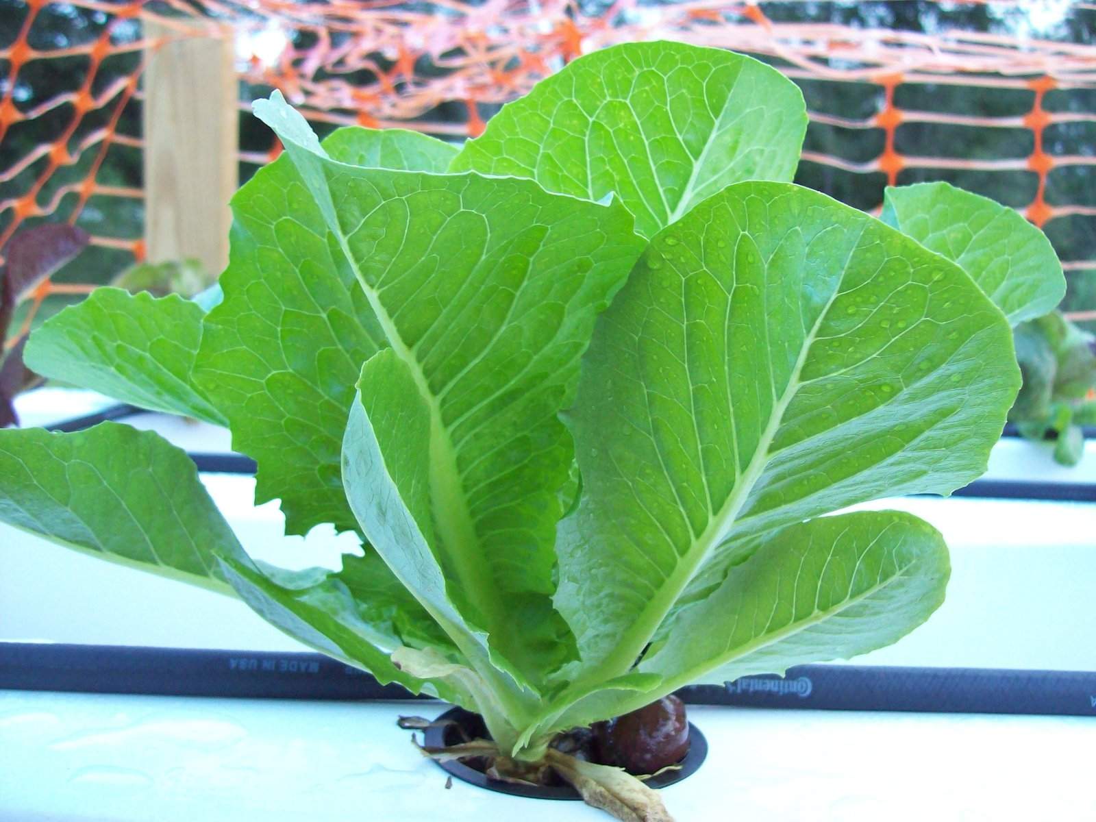

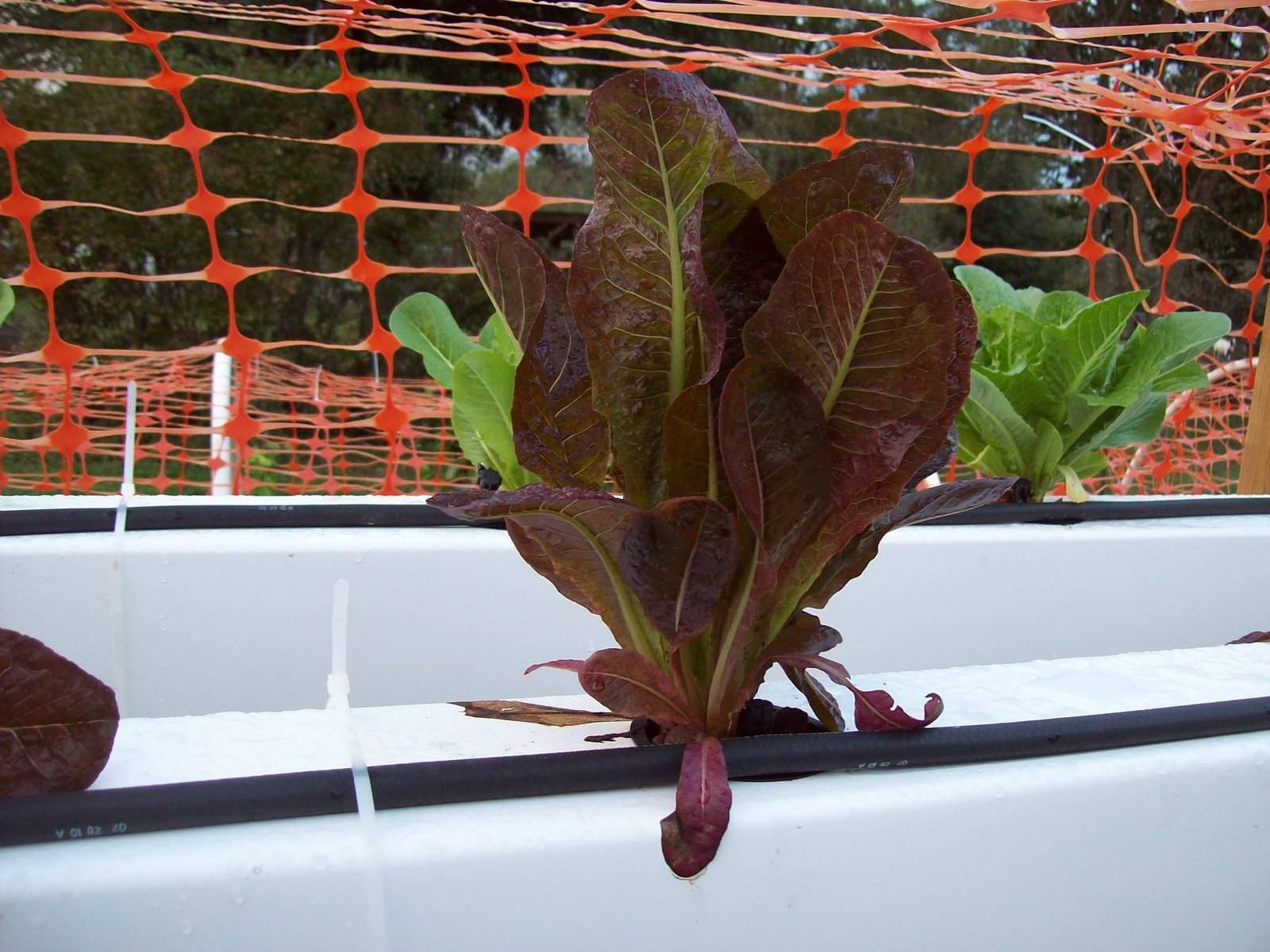

  19. Gopherman
    Third week compost T and a little Epsom Salt. They are definitely outperforming the leftovers I put in the grow boxes almost 75% larger.
  20. Motomom34
    @Gopherman that is beautiful looking lettuce. It is healthy with no spots. Just love it. Great job. Very envious.
