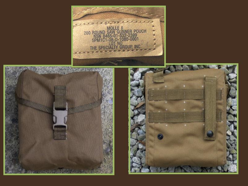

    I have a Blackhawk Patrol vest system and I added these. They fit on pretty much any Alice or Molle system and will hold an AK47 drum or about (6) 5.56/AK magazines, They will hold 7.62 NATO mags too
    For shotties I use a slightly modified SKS chest pouch. Holds about 80 12 GA shells and they are $10
