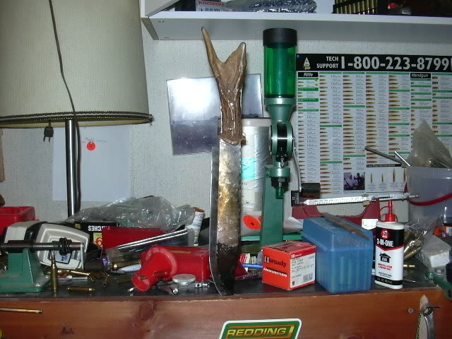

    Here is something I have been workin on for a long time.This is my first attempt at it so please bear with me..My grandpa used to make knives out of sa blades,files,car springs..You name it and he was good.Well I figured I would try to carry on that old skill.I made this 11 inch BOWIE blade from a broken machete..I got her glowing red and dropped her into motor oil...It frickin worked.This thing is harder than a preachers ****.
    The handle is a broken deer horn that I found..Really unique sort of thing.
    So where can I find a big peice of brass to make my hilt,(handguard) from..
    Here is the knife..I named it the "Iron Mistress" after that old movie..
    It is built to be functional and I plan to put it on my belt with my pistol when hunting hogs..In case one of these big fellas decides he wants to scrap and I`m out of ammo..

    BigUglyOne..It has not been tempered..Only hardened.What is the best method for tempering knife steel?Like I said this is my first one and my grandfather is dead.I wish I would have asked more questions of him about this stuff.He was a quiet man but had a wealth of knowledge about hunting and knives,etc

    Hardening the blade will make it hard but brittle (as I said). If it was done right it will be like glass (I have dropped one and had it shatter). Tempering will soften the steel and make it much tougher. Heat your kitchen oven to 400 degrees and place the blade in there for 1 hour then turn off the oven and let it cool slowly, when it is done the steel will have a yellowish straw color to it. It should be hard enough that a file will slide off of the edge but you should feel some drag from a sharpening stone cutting it.

    Big Ugly One..I tempered it as you said in the oven..Appreciate the links also.I found a peice of big nickel I like or brass...

    Big Ugly..Thanks for the temper tip..I did it let it cool,then put the blade on an Arkansas stone,followed by a big porcelin stick I use to final finish my skinning and boning knives....
