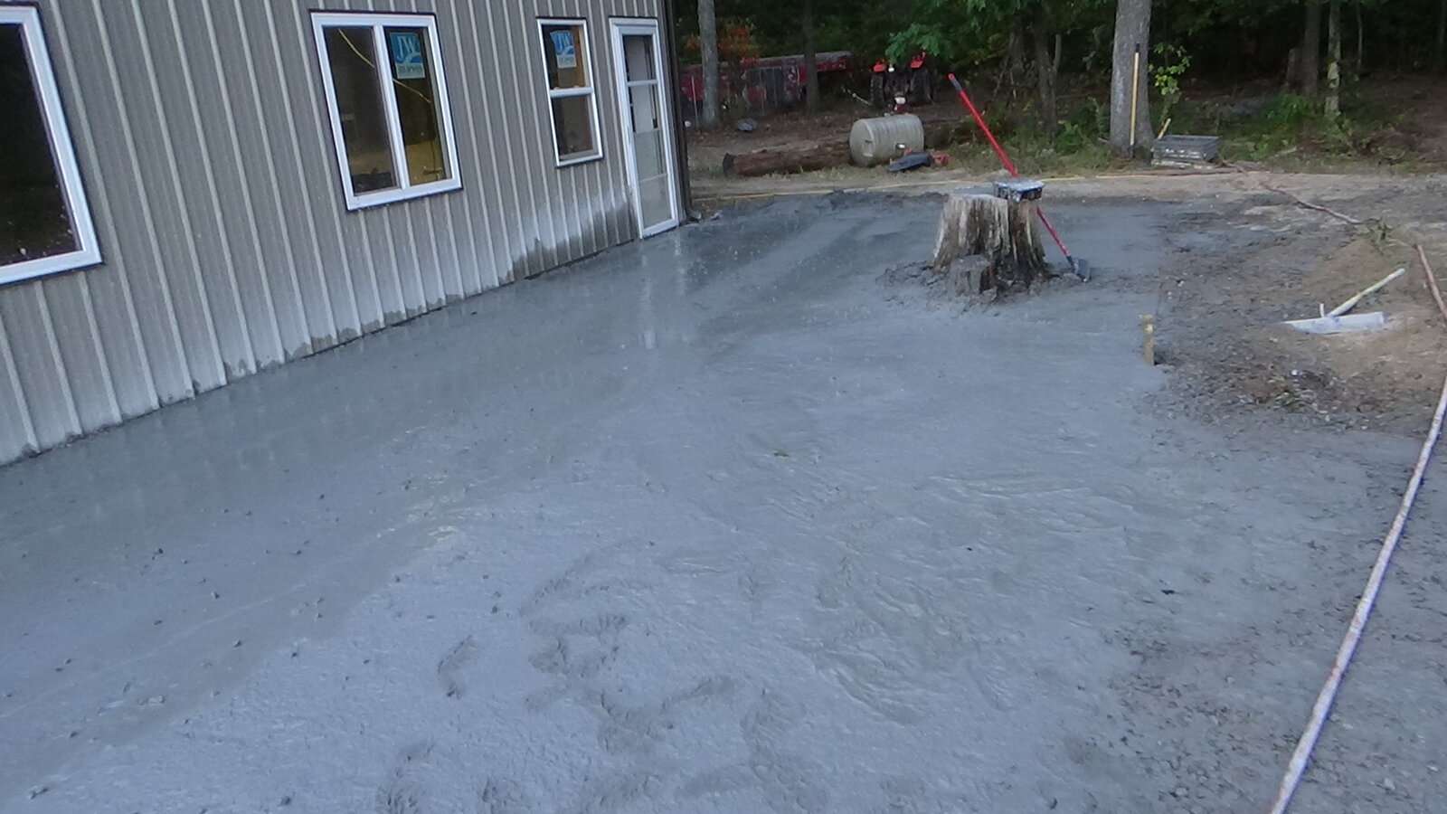

    I always have and I always will :) I am the reason they created self leveling epoxy concrete surfacing!

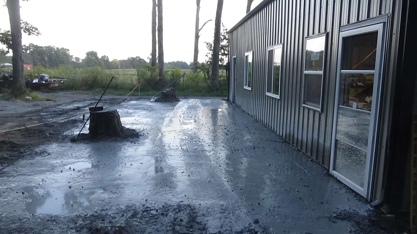

    I have seen worse.... I thought I had one more concrete job in me with the bull float, push screed and puller..... I just didn't half way through working it I was dying and sent Mrs Krap to the rental place to get a power trowel. By the time she got back with it the concrete was setting up good and the rental trowel was old than I am and in just as bad of physical condition LOL. But It did get the ridge knocked off. The mud puddles I will have to fill with my little mixer and epoxy over in a year.
    I did smooth out my foot prints after taking the picture! Not perfect by a long shot but better than spending $8,000 for a pro finishing crew.

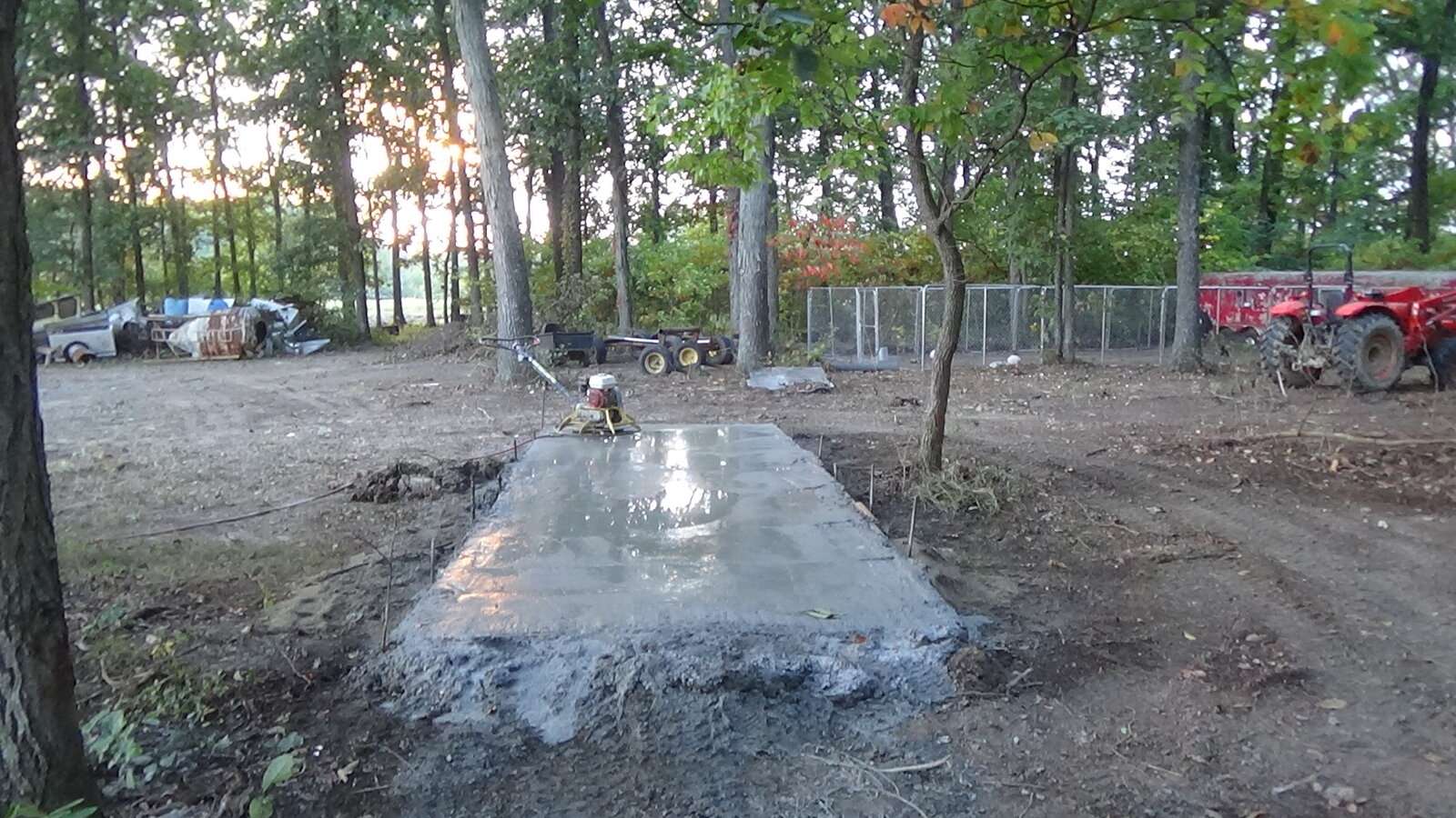

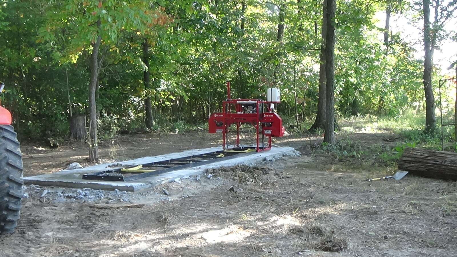

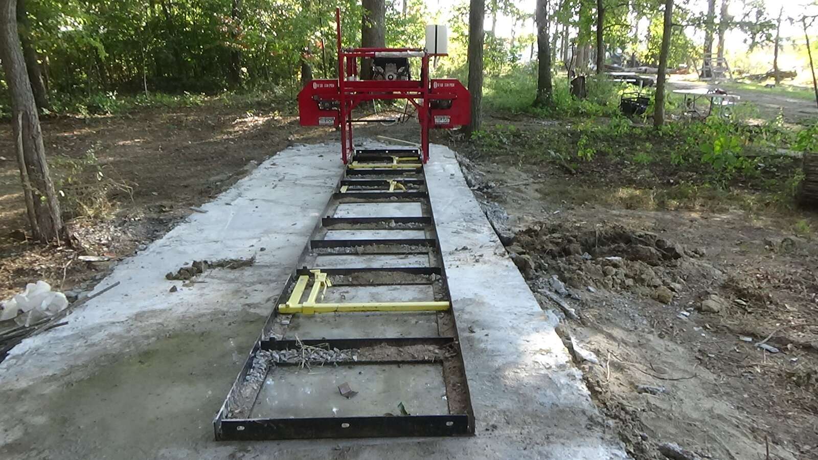

    The Pad for the Mill went a lot better than the patio. 8'x24' 6"thick It is actually dead level with a dip on the right side to drain the water from the band lube off to the side and out. In 48 hours I will drill the holes for the inserts to bolt the ground track down with and put the track on and the head. In 28 days after it is well on its way to being cured and hard I will start milling the mountain of logs.

    I was dying half way through the patio! The Old Gray Man just ain't what he used to be LOL. Took from noon to 6:30pm and it getting to hard to do anything else with. LOL you can see the sun getting low in the mill pad pic. The power trowel knocked the ridges down and made it nice and level in that regard. I have wanted a mill pad forever. It gets old constantly having to level and relevel the ground track. The most stable platform I have used for the mill was a level bed of 3" rock and then RR ties across and then the track on the ties. Even that got out of level over a few logs and had to be shimmed up. While not anywhere near perfect the patio and pad are serviceable. I may regret leaving the 2 post oak stumps and encasing them in concrete in the patio or I may not, it will be long after I am dead before they rot out, so not my problem and I most likely won't regret them. I am just glad to have the last hard project of 2023 in the rear view mirror now. I have been dreading concrete week all summer. If I were smart I would have poured the patio in two 16x20 sections over 2 days instead of one big 40x16 pad. It would have saved me a lot of problems with the North end getting to firm as I worked on the South half. Really too big of a job for one person.

    It doesn't have to be purdy and purfect to be functional and level. I am going to have to put a couple of 1/4" plate steel shims under the left end. My Drainage dip got to far to the center LOL. with that back track not attached I can still do 16' logs with the 21' track but everything is out willy whack without it on.
    4" above ground and 2" under ground. this should work out very nicely. I got lazy and just slid the old track off the trailer and onto the pad. And I need to take that dog closest to the head off and move it the center. I had another section of track behind the head and everything set on the old track for milling 8'-16' long logs.
