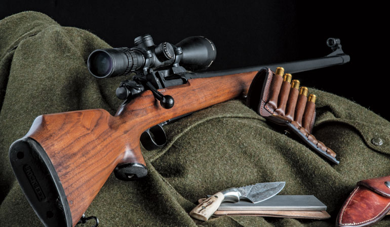

    Bragging time!
    Here she is, finally up and running! Has a quick detach/tip off scope mount via an old Winchester Mod 54 that I modified to fit low and tight, and a quick dismount for the tuned Redfield rear sight that is perfectly matched to the globe front sight! With ether sighting system, she can still feed from stripper clips, and still uses the mag cut off for all the benefits this offers! She sports a Super accurate Criterion 4 grove national match barrel, a fully blueprinted action and silky smooth bolt! This is how bolt actions are done!

    Pretty. Like the concept.

    Love it! Bang Bang!

    How does the suppressor attach?

    The Muzzle is threaded in front of the front sight! It can swap between different muzzle devises! Had to thread it to a standard AR thread pitch and ream my flash hider ( YMH 3 prong) to .310 to make it all work! So far, so good!

    Nothing not to like here!
