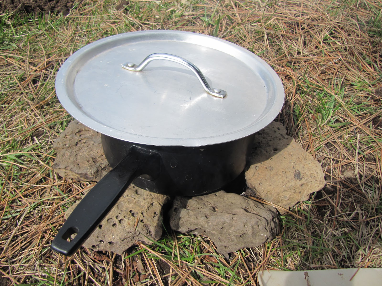

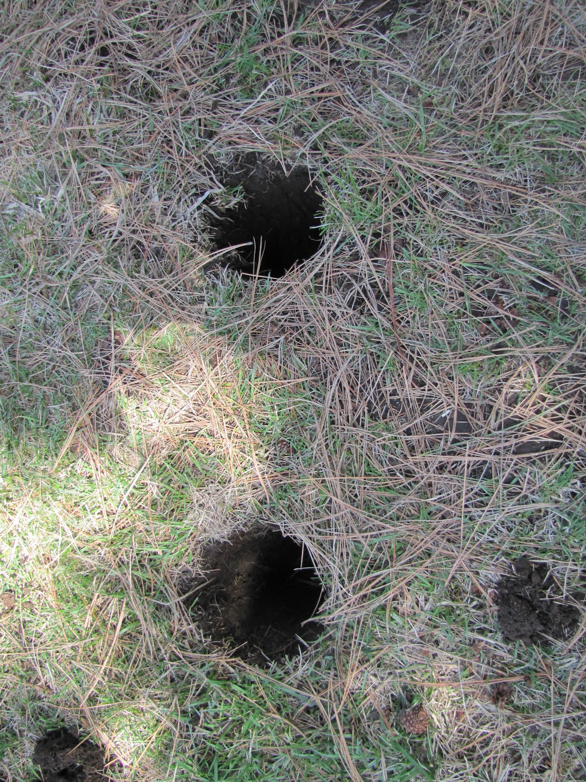

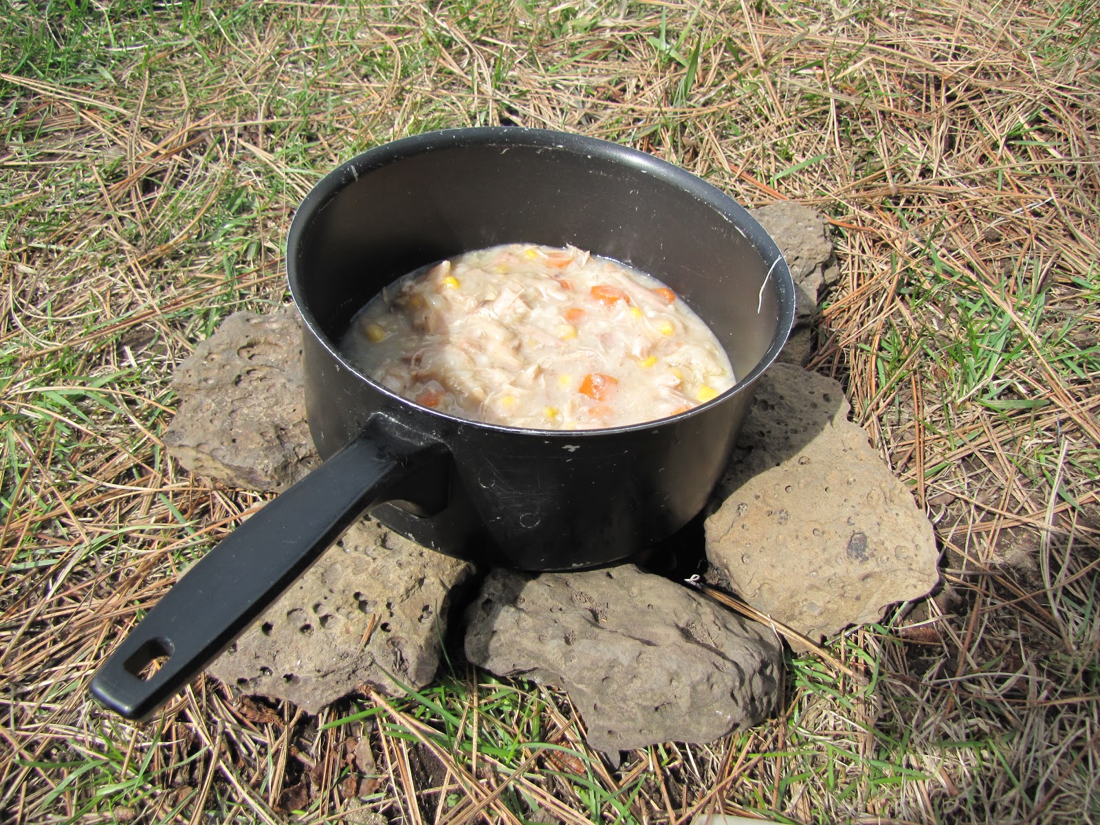

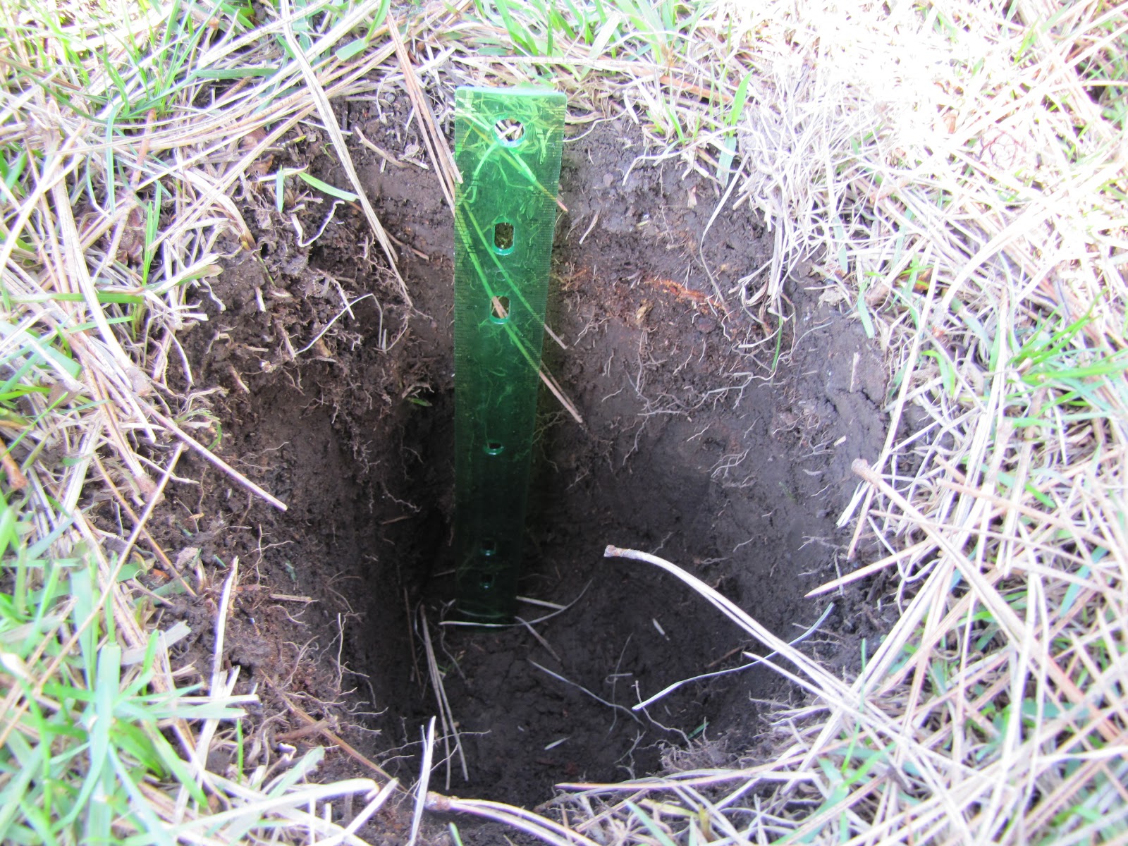

Indian Fire holes for cooking First I selected a site where I would be sure there would be some wind. Most of our winds come from the south so I ended up behind the garage and hidden from the road. But where I would be sure of a nice breeze. Then I started to dig. I decided to use the post hole digger as it was here and I was doing this at home. A shovel or camp shovel like a fox hole shovel also works. So the holes were around 8 inches across. I dug both holes about 11 inches down; anywhere from 9 to 12 inches works and my holes were about 11 inches apart, 9 or 10 inches works also. I started to dig down inside the holes to join them. A hand width dug with my large spoon worked well for the joined hole for air to get to the second hole where you will lay your fire. I collected dry pine needles, sticks and pine cones. I also pushed in some dryer lint and dry moss from the trees. Fire starters can also be used, charcoal etc. I also collected some flatish home grown lava rock that we have plenty of for my cooking hole. The pot will be placed on these rocks and that way air still gets in from the top also to allow air flow. You can also lay a rack on top of the rocks for your pots or # 10 cans to sit on. I made sure I had some dry bark and pieces of wood to add to my fire. It didn't take much to get a good hot fire going. Next I let the fire burn for a a few minutes to make sure it was going good and nice and hot. I didn't even use the rest of this bark the fire got hot with very little to keep it going.Also if there is a lot of wind you may need something to help direct the wind toward or away. A board, plywood or say a tarp held up with branches works. I covered my pot as my dog was nosing around and I didn't want any thing blowing into my lunch. Within 5 to 6 minutes my food was good and hot. Before I went back inside all I did is shovel some of the dirt from digging the holes back into the fire hole to smoother the coals. Done. I covered both my holes with a piece of sheet metal because I saw the rain storm was headed in as predicted. Anything bigger then the holes works.This kind of works like an in ground rocket stove. If you are moving to another area while camping just fill them back in. Items needed: 1. Shovel, camp shovel or post hole digger 2. Hand trowel: optional3. Small hand hoe: helps get dirt out of the hole easily4. Large strong spoon5. Rocks6. Matches7. Fire starters - Optional (but i love them)8. Dry small stuff for starting your fire9. Pots, lids, pot holder, spoons etc 10. Something to block or direct the wind if needed.
