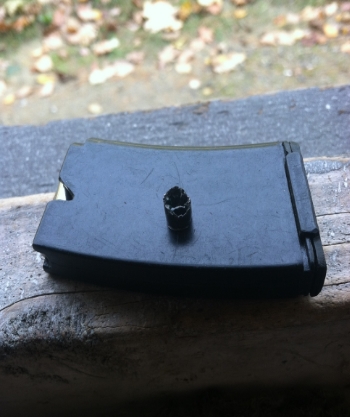

    edRange report:
    Still have all my fingers. [tongue]
    The results were, well... inconclusive.foosed

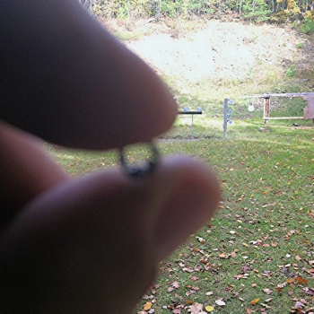

    I brought two firearms with me, a bolt action rifle and a single action revolver. I fired a few rounds of standard .22lr to insure functioning and both proved OK. Next I chambered and extracted a ramset blank from each without firing as another function test and then fired just a blank from each. I'll admit to a wee bit of apprehension about firing one of the epoxied pellets first off so I chambered a pellet and then a blank behind it and fired them. Empty casings extracted and ejected easily. I did not hear any "ping" from the steel I had shot with the .22lr so I visually checked each bore and found them partially blocked. I removed the blockage and found little lead rings.
    I then chambered one of the improvised rounds and fired again with pretty much the same results.
    Another little lead ring. maddd
    I know the focus isn't the best (phone camera) but if you look close you can see fussy images of the ridges where the epoxy remained.
    Both with the pellet loaded separately and epoxied the charge (#3) the pellet traveled just a few inches down the bore before the charge blew the top of the pellet leaving the skirting behind.
    Summary; The pellets I used were different from what was used in the video as were the firearms. The ramset charges were the same. Perhaps with the same pellets this might work, or a lighter charge, or an older, "looser" barrel.
    At least now I know how the guys on Mythbusters feel. biglaff
    If any other monkeys want to give this a go, please post your results.

    Even with a loose pellet - no adhesive used - the top of the pellet was blown off leaving a little lead ring. If anyone was to attempt this I'd suggest trying the No.1 or No. 2 charge. It also might help to check several brands of pellet to see if one is better suited than the others.
    One thing I left out is I did load five improvised rounds into a magazine for the rifle and cycled them through the action without firing them and they all fed and ejected without issues.
    The big issue is finding a pellet/charge combo which would work in the gun you have.
  6. BTPost
    I suspect that the issue is in the design of the Pellet, being used. A soft Lead Pellet designed for Air Pressure, should have very thin Skirts, so that the Air Pressure will cause the skirt to expand slightly to engage the Rifling in the bore. The extra Pressure of a Powder Charge into the cup of the Pellet Skirt, is causing the skirt to separate from the head of the pellet, due to the higher velocity gases, that form the extra Pressure. You really need a projectile that has a solid Core Base and little Skirting, for a powder Driven Projectile. Better go find a Different Pellet, than one designed for Air. I suppose one could cast some, with the appropriate Bullet Molds.....
