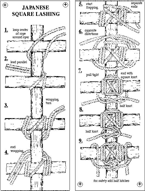

    In the bush, where you may have to make every inch of the cordage you need, lashing efficiently can be very important.
    A bad lashing can fail, and Murphy pretty much guarantees that if it does, it will fail at the worst possible time and place, and in the worst possible way,
    It's very easy to skimp out on a lashing when you come up three inches short and don't have any more cordage.
    One wrap less, or one knot instead of two--what could possibly go wrong?
    Japanese lashing beats Boy Scout lashing by a mile. It's faster, easier, stronger, and requires significantly less cordage.
    A Boy Scout square lashing starts and ends with a Clove Hitch--which I consider a waste of time and cordage.. But it's "traditional"!
    A Japanese square lashing doesn't even require a knot to start, and finishes up with a simple square knot. It's "traditional" too, but I think it's a more carefully evolved tradition.
    You'll notice it ties quite a bit faster, too.

  4. Witch Doctor 01
    Only issue is that the square knot is not a stable knot...

    @Witch Doctor 01:
    Good point.
    A solid finish could be made by substituting a Constrictor Knot, I think.
    Especially good for lashing that are critical, as in rafts.
    See:
    Constrictor knot - Wikipedia
