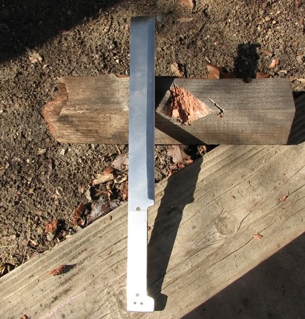

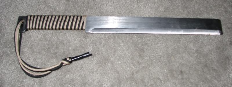

    Hey folks! Nice edged weapon section y'all got here. I toyed with making my own "camp tool" (non-psycho non-paranoid way of saying what it really is...the "zombie chopper"). I bought an 18" x 1/4" x 2" slab of 154cm and made it look like a real long version of an EOD prybar...long, straight chisel edge with the short end a rounded chisel pry edge with a paracord wrap on a machete type grip.
    Anywho, spent plenty of hours grinding/sanding the edge...ended up giving up on the chisel edge and just did my best at two 30ºish edges. It's about 11 ounces and I've hacked some 6" cottonwood trees down with it easily so I know it can split zombie skulls...i mean make camp fire wood!
    My problem is...it's still in it's annealed form as it was when I bought it online! I'm torn on how to forge it. I have an idea of how I want to forge it and then bake it in the oven for several hours...the problem is...I don't know when it'll be at 1800º or whatever the temp is supposed to be for that 15 minutes.
    I was planning on digging a pit, putting a 1" iron pipe in it with spaced holes, then filling it with coals and then using a blow dryer to feed that air into the pipe via another longer hose a few feet away. I've heard of little tabs or stickers you can put on metal that melt at certain temps..and I've heard of magnets for certain temps (I think a few hundred degrees too low for my metal).
    ANyone got some good tips for helping me do this as easy as possible? I'll be using either dirty or clean motor oil in a 12" wide and very deep container/bucket since this thing is 18".
    Thanks!

    nice design.... 154cm is a pretty tough steel to heat treat without a heat treat oven IMHO... I'll see if I can find some info to help you ....
  18. Bear
    Re: water too fast oil too slow
    You're gonna have to go by color... heat treat it at night so you can better judge it in low light... here's a link to the color you're looking for...
    http://www.blksmth.com/heat_colors.htm
    Look up 154cm heat treat and you can find some good recipes....

    Cool! I think I had read somewhere where they talk about the color it should be. Never thought of doing it at night. One good thing is that I don't really care if I break this thing, and if I do it wrong and it's not going to turn out to be 6x hardened when I'm done, it'll at least be harder than it is now annealed (which is like 35 hardness?) which still does the job.
    THink I might punch more holes in the thing though to take out an ounce or two. I work in a high school and can sneak in. That'll allow me to punch holes and regrind the edges correctly I think. I'll try the forging at home.
