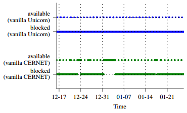

    • Generally, once a bridge is detected and blocked by the GFW, it remains blocked. But does this mean that the bridge is entirely unreachable? We measured the blocking effectiveness by continuously making a set of virtual private systems in China connect to a set of bridges under our control. We found that every 25 hours, for a short period of time, our Tor clients in China were able to connect to our bridges. This is illustrated in the diagram shown below. Every point represents one connection attempt, meaning that our client in China was trying to connect to our bridge outside of China. Note the curious periodic availability pattern for both Unicom and CERNET (the two ISPs in China we measured from). Sometimes, network security equipment goes into "fail open" mode while it updates its rule set, but it is not clear if this is happening here.

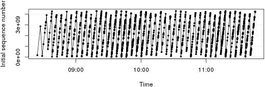

    • We were able to find patterns in the TCP headers of active probes that suggest that all these thousands of IP addresses are, in fact, controlled by a single source. Check out the initial sequence number (ISN) pattern in the diagram below. It shows the value of ISNs (y-axis) over time (x-axis). Every point in the graph represents the SYN segment of one active probing connection. If all probing connections would have come from independent computers, we would have expected a random distribution of points. That's because ISNs are typically chosen randomly to protect against off-path attackers. Instead, we see a clear linear pattern across IP addresses. We believe that active probes derive their ISN from the current time.
