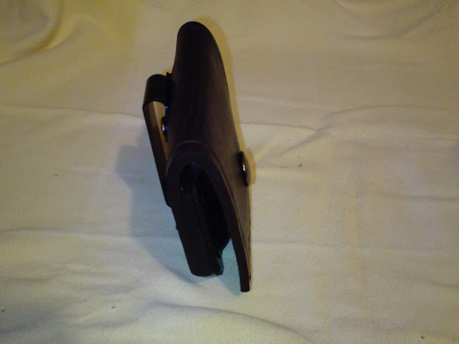

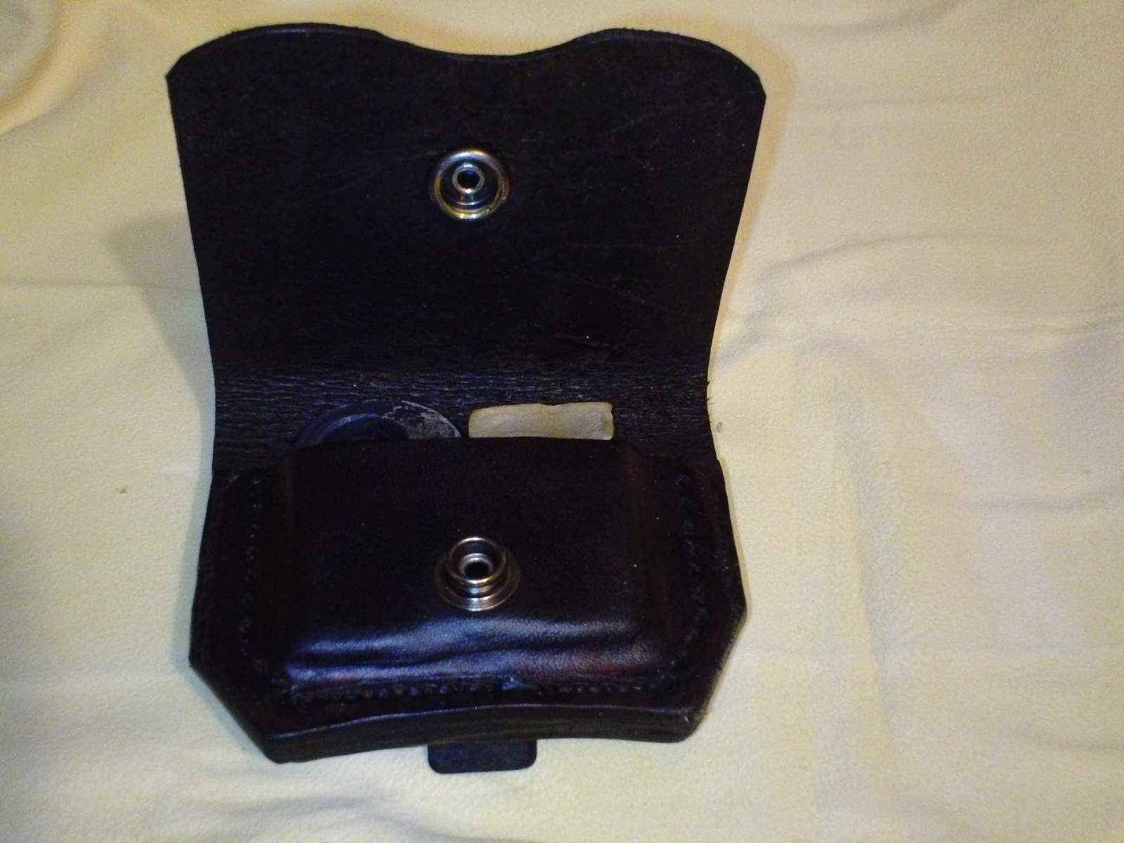

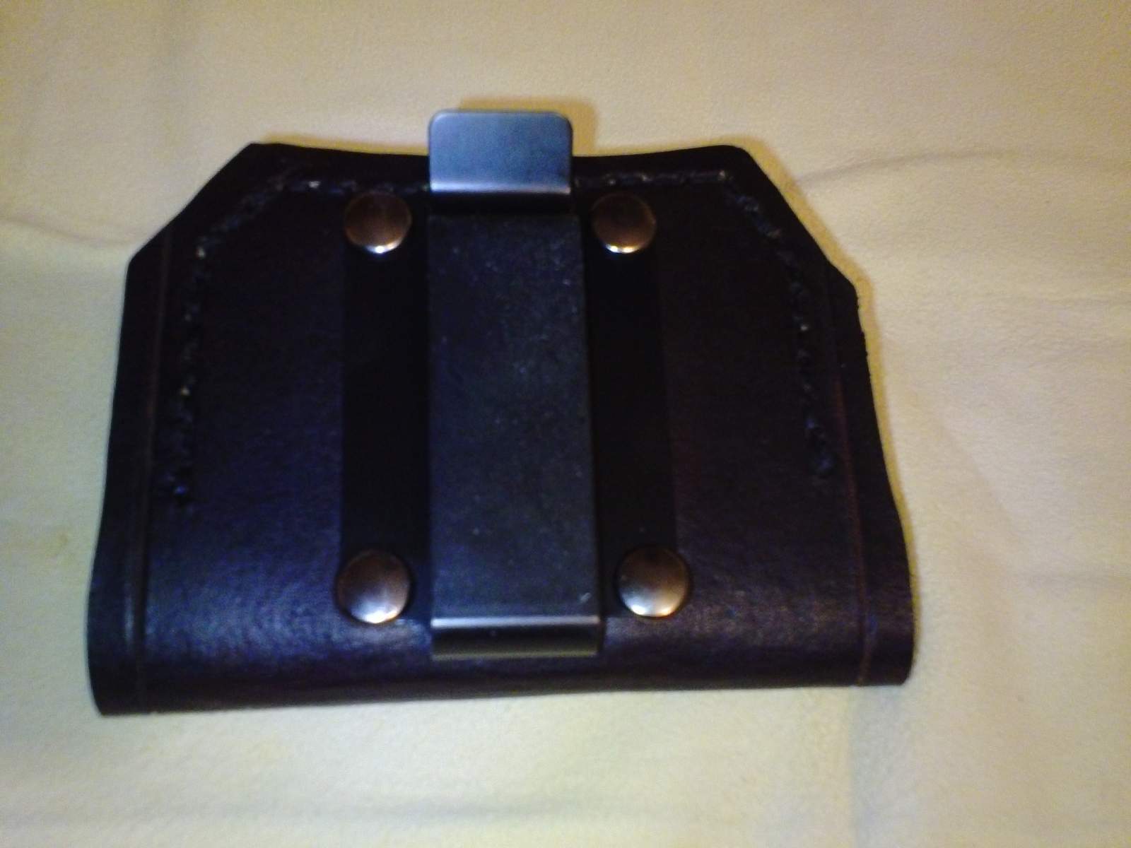

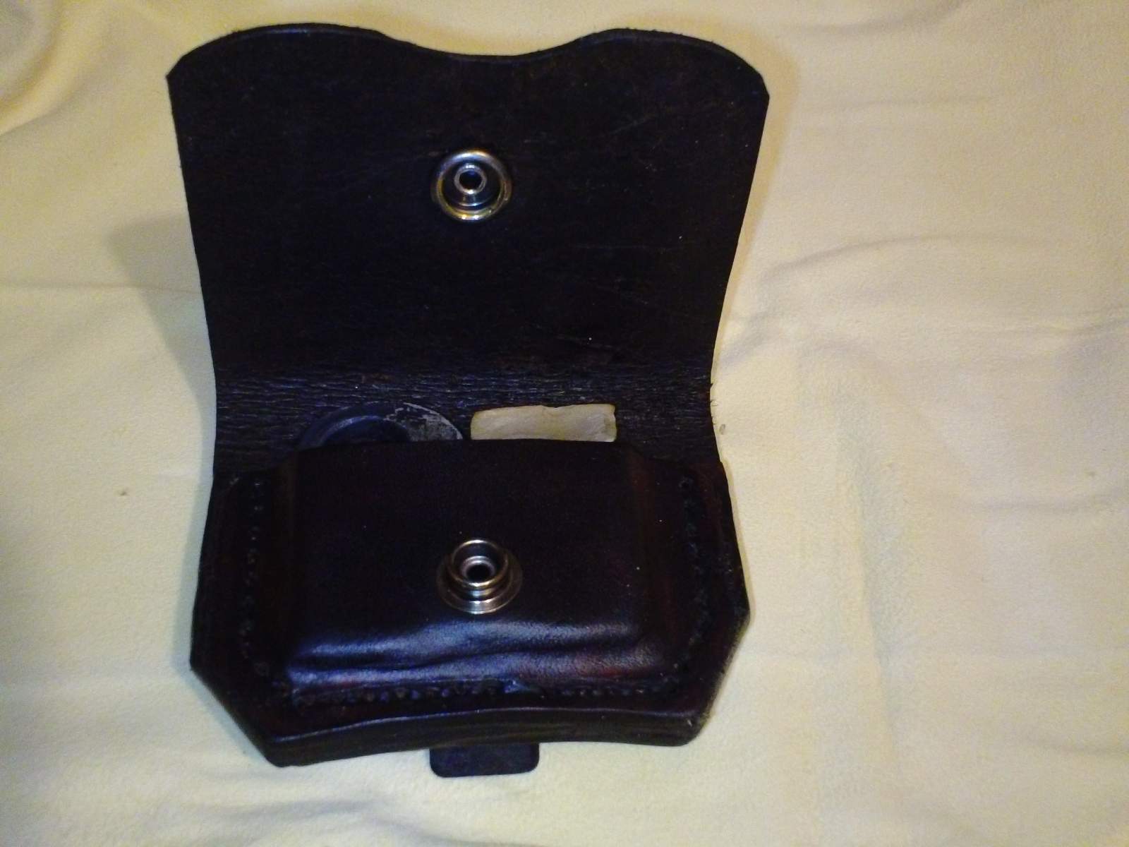

  6. Brokor

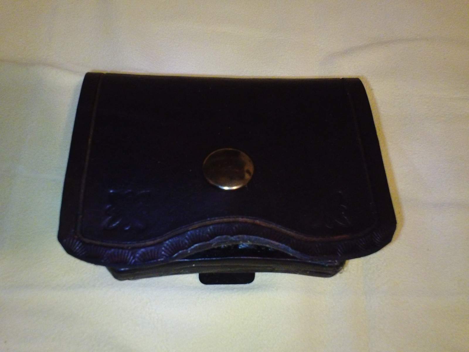

    I finished the flint & steel case for the package I received from Bear. I wanted a small case just for the flint and steel, and I plan on making a larger bag to place this into so I can also use it for storing tinder material...
    As you can see, it is kinda slim. I got all the hardware from Tandy Leather, and making this was actually pretty fun.
    Bear, kellory and Witch Doctor 01 like this.
  7. Bear
    PERFECT!... had some feedback from someone who uses these to light all his fires... that it's the perfect size for belt carry... and your leather carry case is a fine example :0) Awesome work @Brokor !

  8. kellory
    @Broker, nicely done. I can't tell from the pics on my phone. Is there anything between the flint and steel to prevent contact for noise and wear?
  9. Brokor
    Thanks! And the sheath is a friction-fit just for these objects. No play at all. I suppose you could jam a few bits of char cloth in there, but there is no sound and no movement. I suppose as the flint wears there may be some movement, but it's not tactical and it won't ever move enough to become annoying.
    Thank you very much! I want to make a bag for tinder, too.
    Bear likes this.
