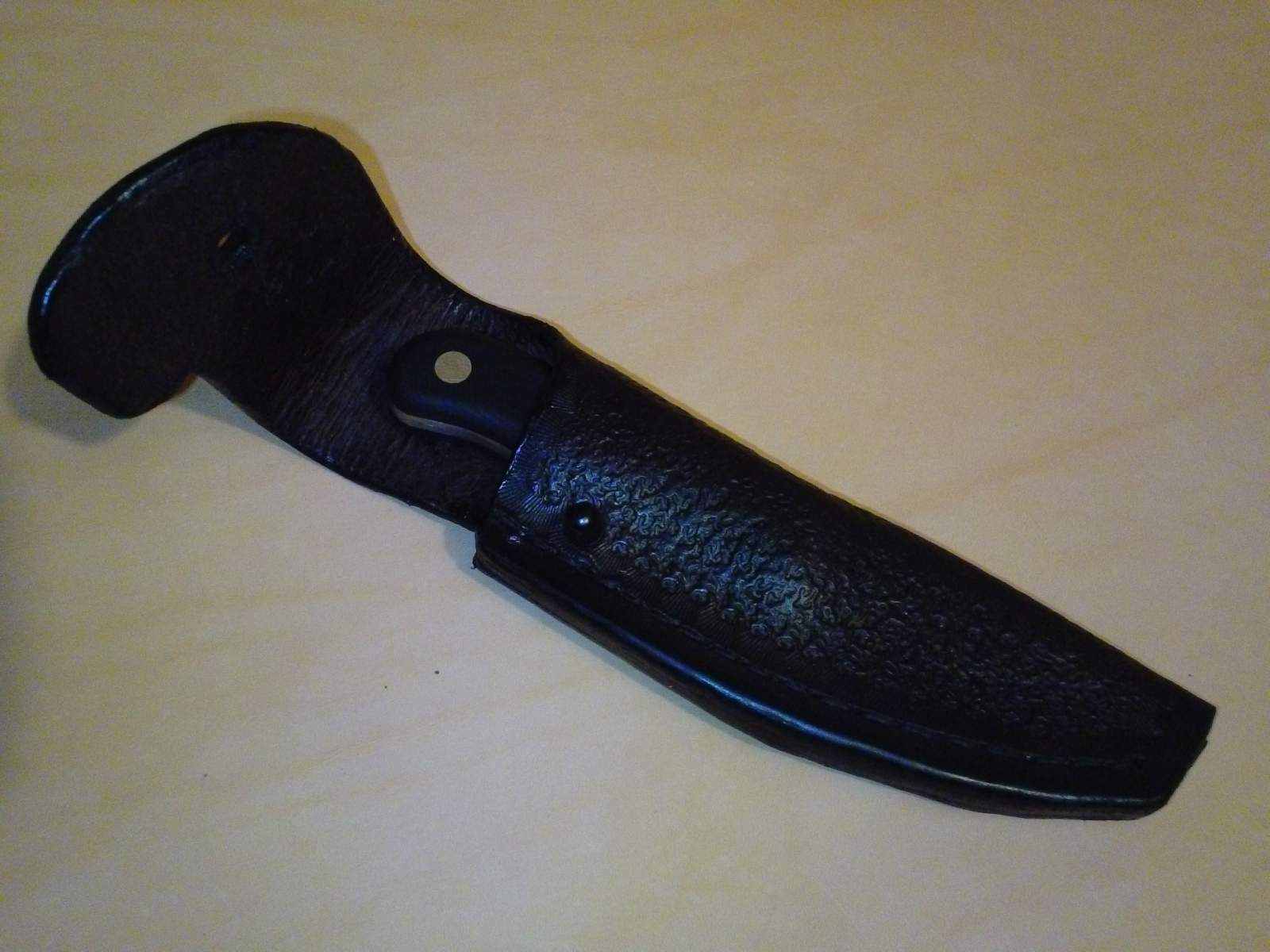

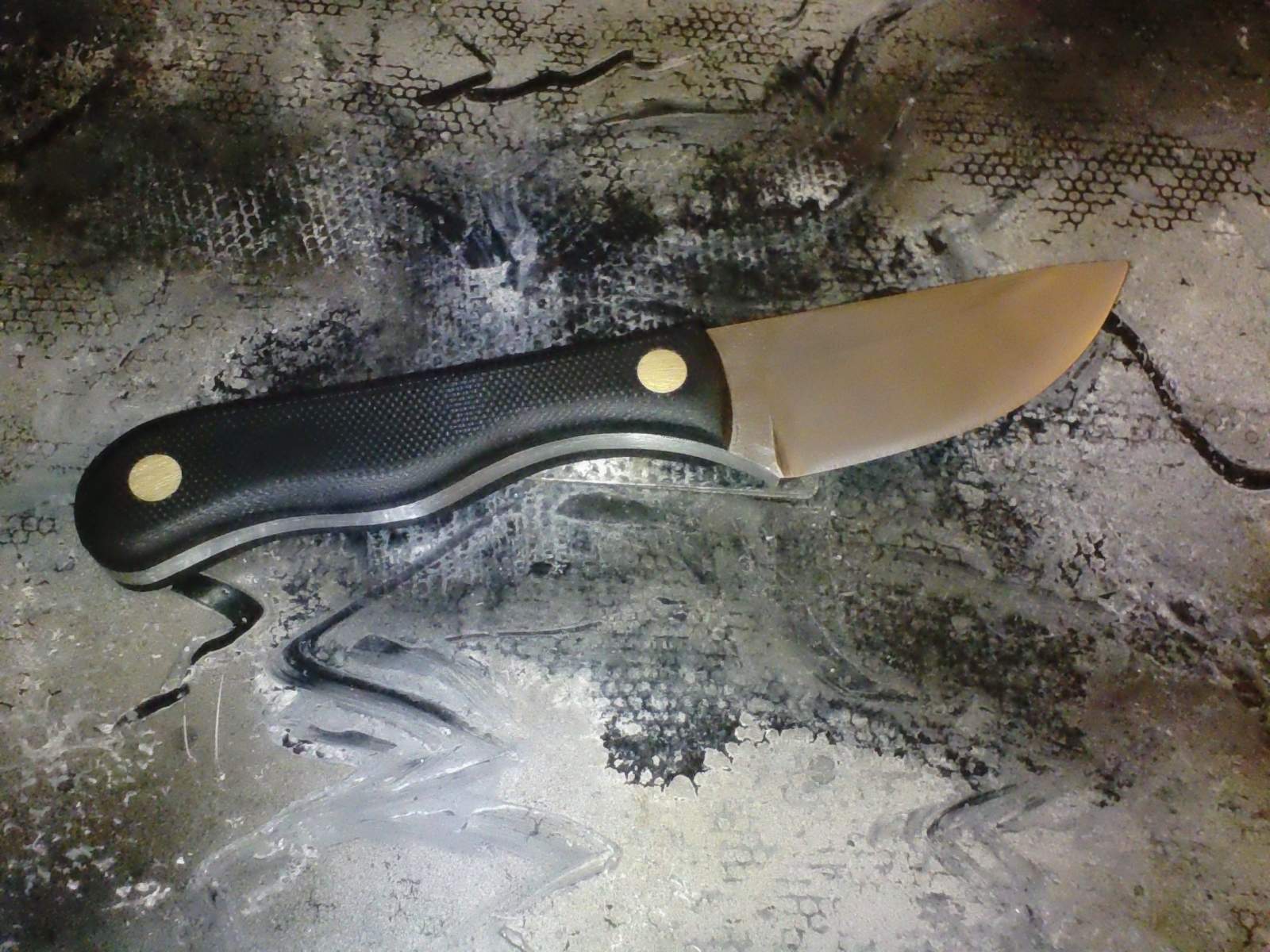

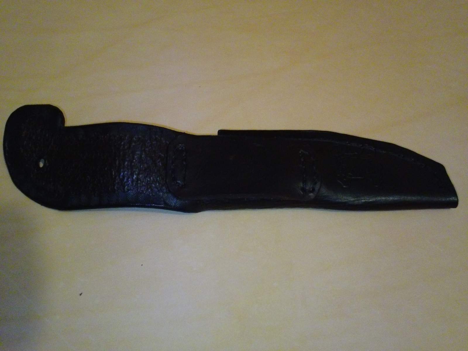

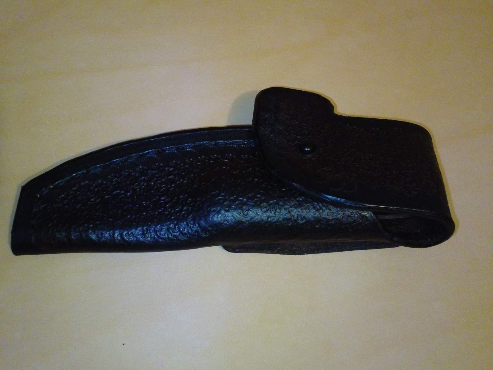

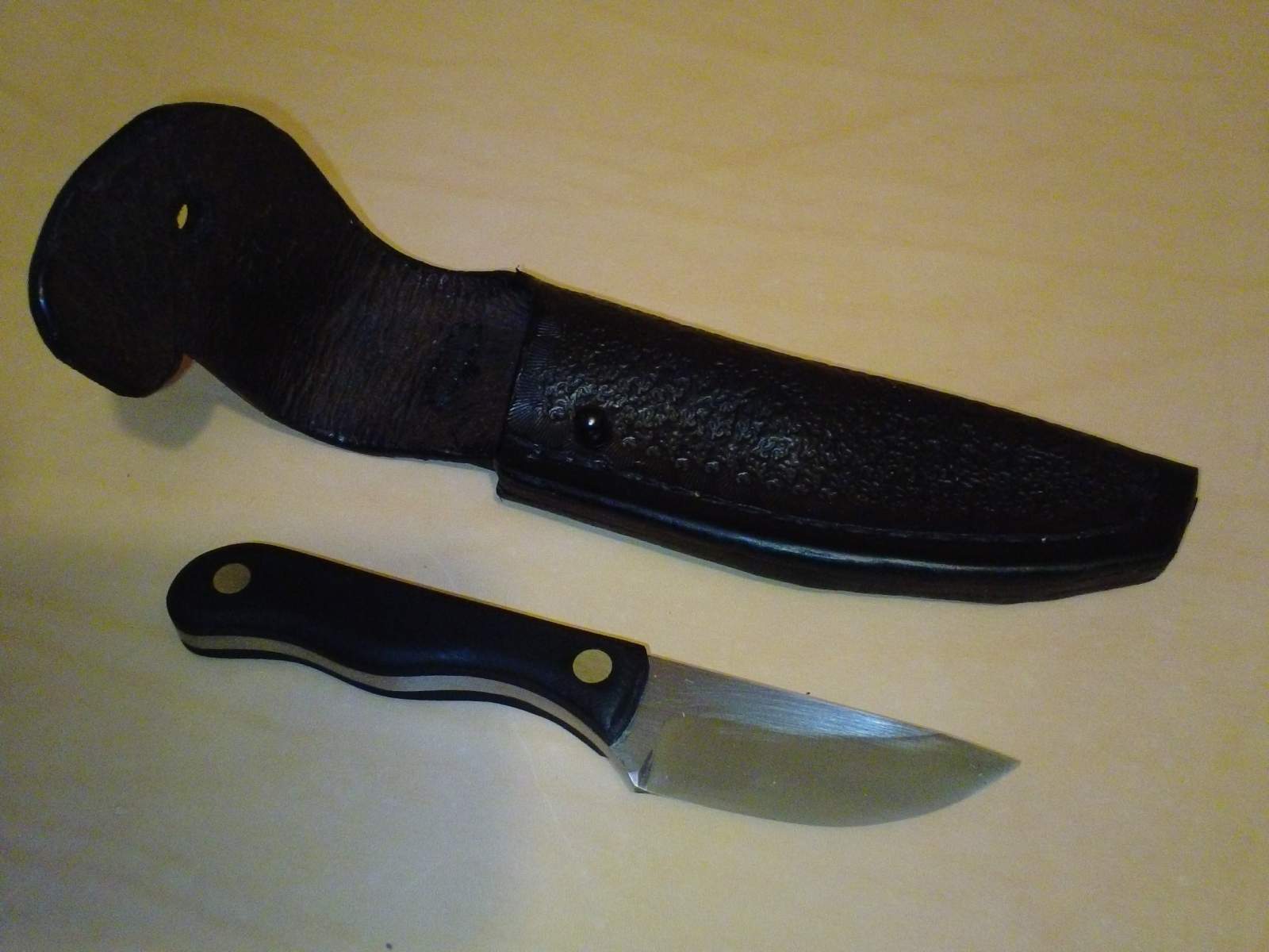

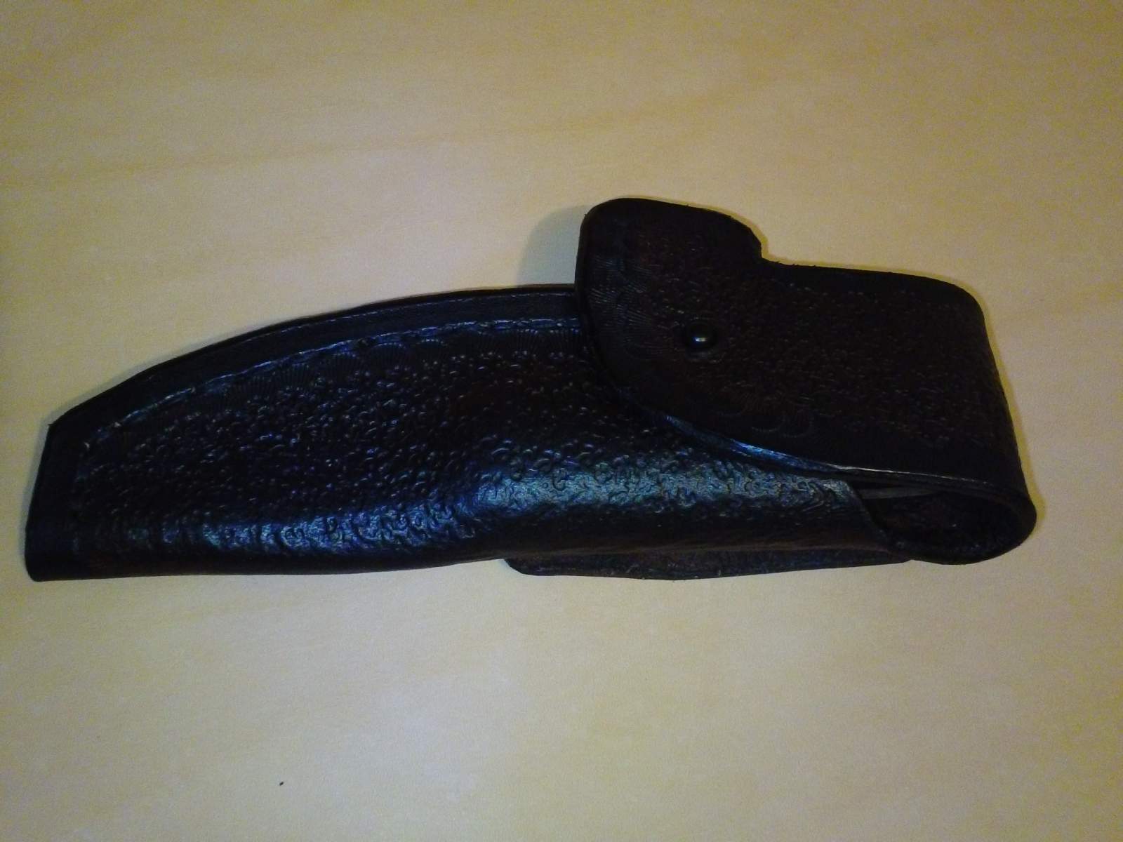

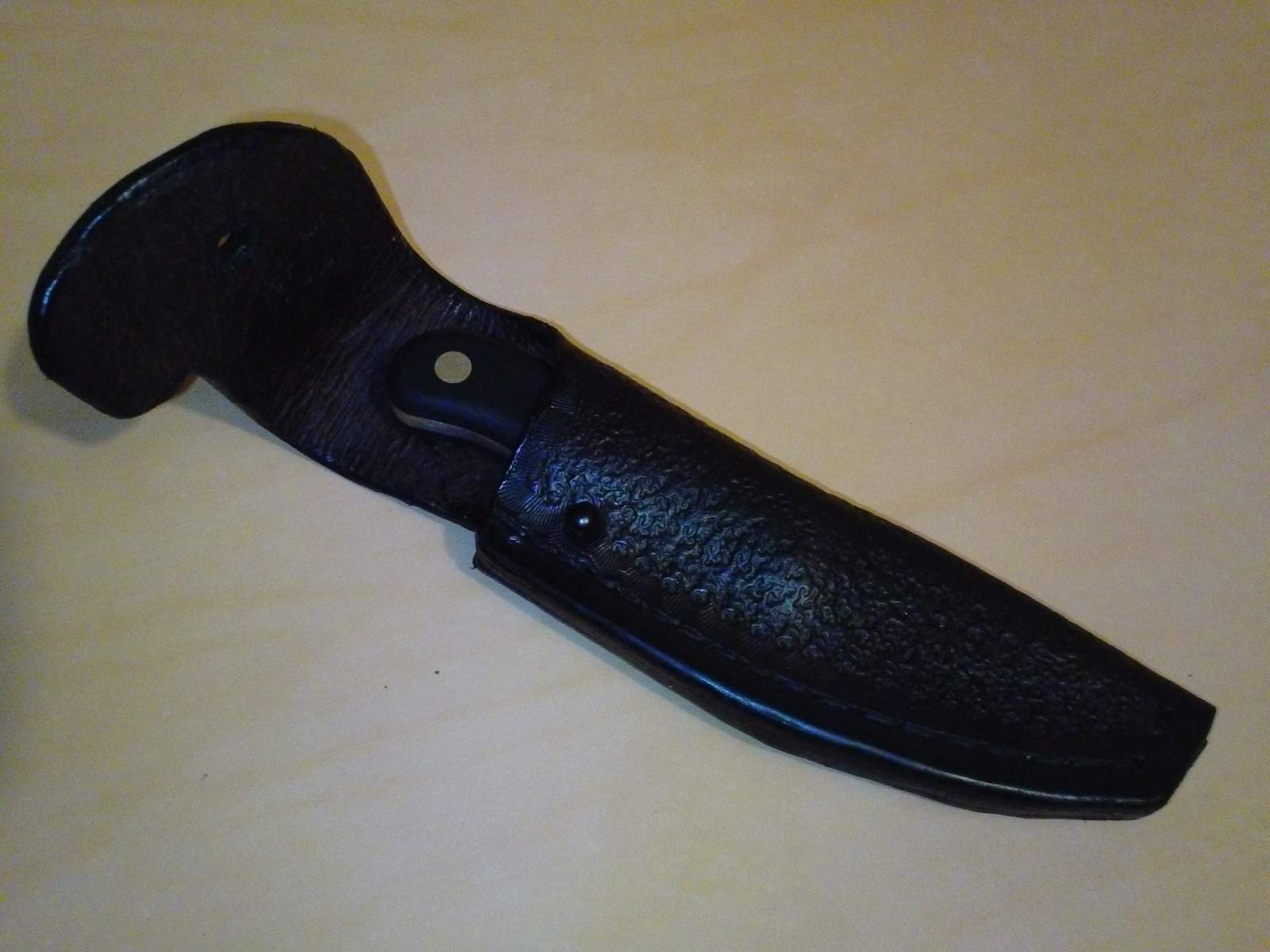

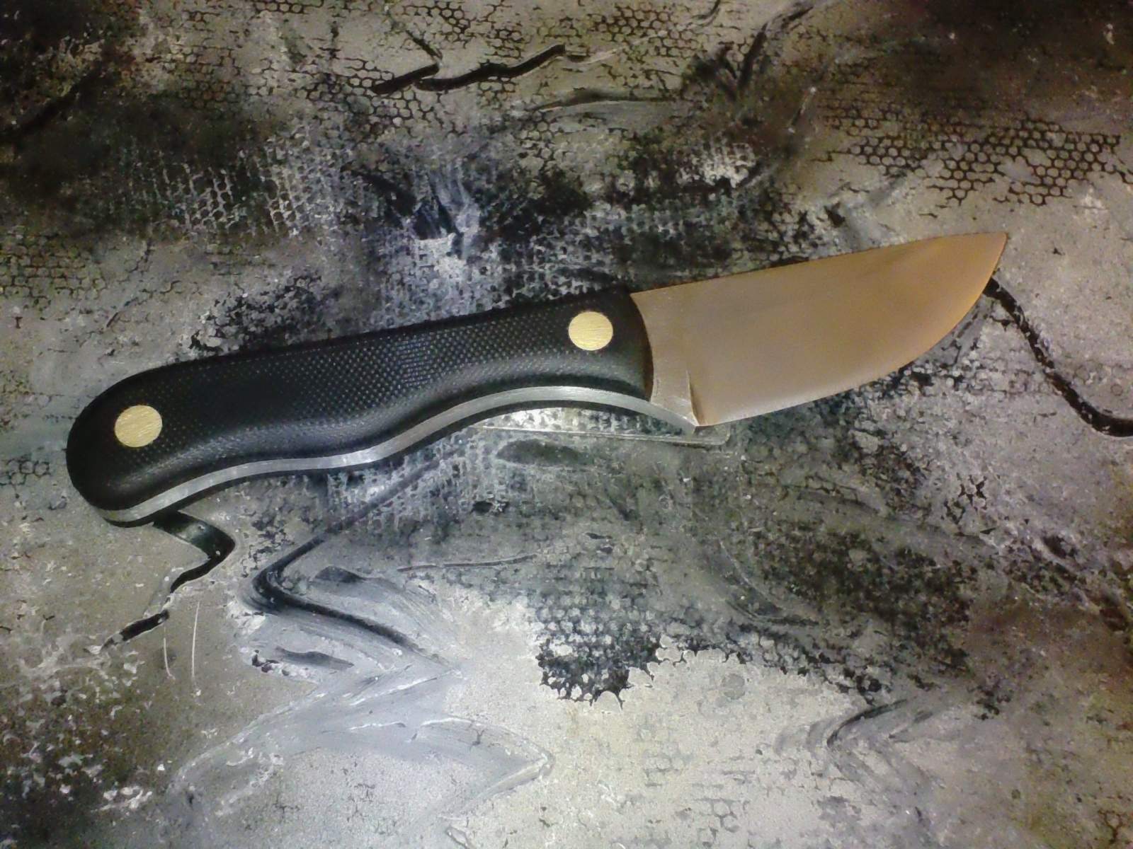

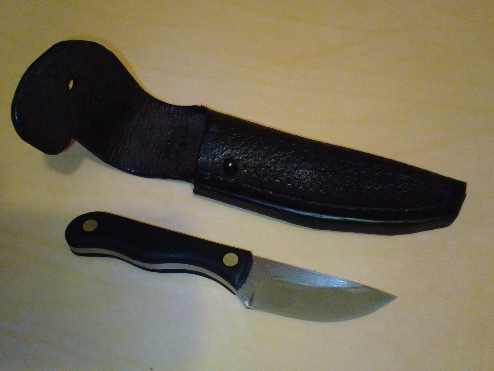

    I just finished a custom sheath for a knife I had made by CMR, it's a small skinning blade just the way I like it.
    The knife is 5 3/4" oal with a 2 1/4" bellied cutting edge. It weighs 3.2 oz. and fits my hand nicely. The steel is Bohler D2 and the handle material is black G10 with solid brass pins. The steel has been cryo treated with a final HRC of 59-61.
    I did a bit of tool work, and my stamping isn't the greatest, but I think it came out decent enough. I especially like the button closure, it really suits the knife. I wanted a closed sheath since it's such a small blade, even though the sheath is friction fit and wet molded. I didn't expect to have taken a full 7 hours to make this sheath, but it was worth it.
    I decided to make the design handy, streamlined and simple. The belt attachment loop is sewn on (top and bottom), and used the integral portion of the leather for the flap closure, keeping the smooth, finished leather exposed to show off the tooling. The dye is mostly brown, but I also highlighted the edges with black to give it some depth. I went with a 9 oz. veg tanned leather, which is a bit on the heavy side, but I utilized most of the thinner portion of the shoulder, so it could possibly be around 8 oz. --As always I use Fiebing's leather dye, acrylic resoline, tan kote, and mink oil.
    Let me know what you guys think!

  9. Sapper John
    Beautiful piece of work Brokor.
    Brokor likes this.
  10. kellory
    very nice.
  11. Bear
    Awesome work! I really like it :0)
    Brokor likes this.
  12. Bear
    @Brokor is that like a Sam Browne stud?... I like the stud closures as they are less likely to fail like I've seen on a lot of cheap snaps that either freeze up or get corroded... making sheaths is my least favorite thing to do... been working on finishing up a bunch of them... had to hand skive all the pieces because the leather was a bit thick... no fun... spent about 7 hours skiving the leather for 9 sheaths... (sure wish I had a Landis hand crank leather splitter)... so yeah... 7 hours is a lot of time... I give you a lot of credit... very nice work and creativity... and dying is a PITA so great job!
