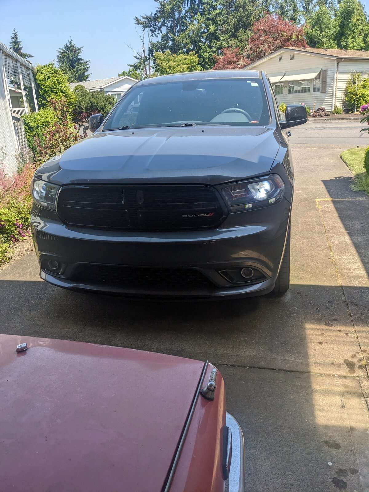

    So, I have a pair of Dodge Durangos, wife's is the SRT Hemi, and My is an SVX V-6 AWD. they are both so damn good, but there are differences, enough that i'm tackling some of the issues with mine to get it closer to the wifes, outside the Hemi. Two days ago, I decided to install aftermarket LED headlights, mine have always seemed a little dim, and the beam has a flat top to it, so it doesn't' really light up the road much ahead of you, while the Wife's has HID headlights, and they are much brighter, mine needed help! First issue was, they didn't even turn on after I installed them, i got a few flashes, but that was it, and digging around on line, I found some makes and models need a CANBUS converter, so I ordered them from the same brand as the headlights, ( Which are very highly rated, tons of good reviews) and so I installed those, ,which was an easy plug and play, except they weren't, as in the new converters do not fit under the factory light covers. But, now the lights work, except they don't, they will come on, and then shut off, and it takes them some time to come back on, and then they shut off again, I turned the light switch off and then back on, and they worked for a while, then switched off again. and now i'm at a loss! It seems to me, I have an issue with ether the head light switch or the head light relay, but A) don't have the means to test them, and B) don't want to be shotgunning parts at the problem costing me time and serious money! MY local Dealer is very reticent to offer any help, and I had to talk to the general manager about customer service to convince them it was in their best interests to be more willing to help, which is in the future should I get there!

  7. Ura-Ki
    So far so good, I have had it outside the shop running for about an hour and a half, it hasn't shut off, so.....
    I haven't done anything since putting in the canbus adaptors, so, will see tonight!

  8. Cruisin Sloth
    Year of the Truck with beam updates ? that black one looks like HID and a Can Buss system with an HID Ballast . CAN = Central Area Network , and Non HIDs are powered from a CAN but not censored If no Bulb Failure system ..
    PM me a Vin Ill look it up in my systems
    Sloth
    Ura-Ki likes this.
