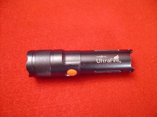

    ULTRA FIRE FMR1 REBEL LUXEON
    200 LUMENS
    ONE CR 123 A BATTERY

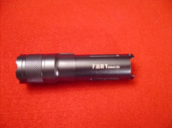

    I bought this light from Deal Extreme for $23.24 shipped. I was very curious to try one of the Rebel 200 lumen new Luxeons and I think this is the best way to try one inexpensively.
    The light has a click on, click off switch and five modes of intensities. The low mode is 30 lumens and is said to last for 24 hours. Another is 100 lumens for six hours, and the 200 lumens mode is three hours; then you have a strobe mode and an SOS mode.
    I used a new Battery Station 123 and in the high 200 mode it lasted for ½ an hour, and it gets hot very quick. I don’t know if the poor run time is the fault of the battery that was under-charged, or if the light will perform the same with others 123’s, but that is the results I got.
    Due to the small head, the flood effect is quite pronounced and the throw is poor for a 200 lumen light, but I was expecting it to be that way based on experience with other small headed keychain-type lights.
    Two hundred lumens in a two inch head of an incandescent will put a level of illumination that is tremendous in comparison to the small head of the Rebel 200 lumens. So we are in a time when we can no longer make an assessment based on the lumens figure, that is when the comparison pictures that I have been taken show the value, as the viewer can see for himself how the different lights with the same value in lumens output perform in real life.
    If I consider the low price I like the little light in general, excepting the side switch that can be a little hard to find in a rush, as it is kind of recessed in the head of the light and difficult to find by feel alone. I will have preferred a tail switch such as I have in my Fenix L1D, but it is a tremendous price difference between the two lights, so all things considered I think that the Ultra fire is a great value, and I can put up with the side switch.
    After trying to like the clip for a couple of weeks, I ended throwing it away, it is too flimsy and I will not trust it to keep the light in my pocket. The light is regular anodized, but had stood well the use in my pocket with keys and coins.

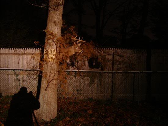

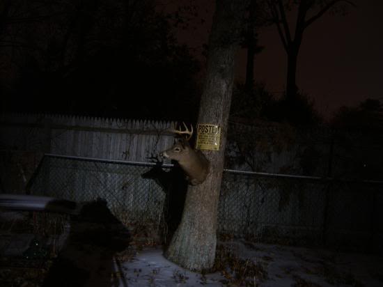

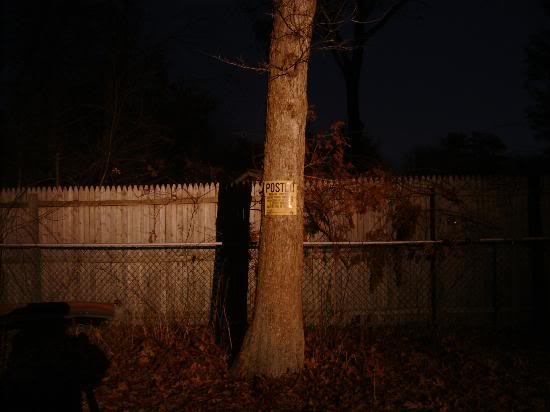

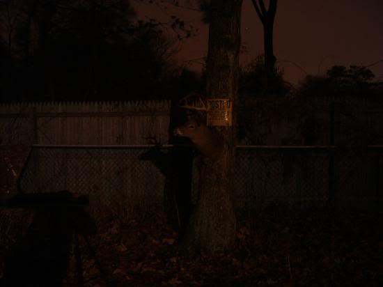

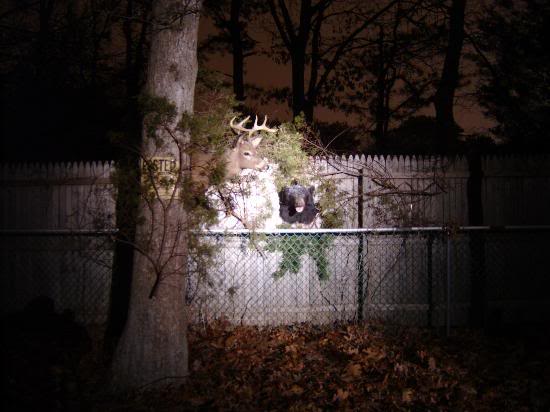

    Here is my usual 26-yard beam shot against my deer head with the Ultra Fire 200 lumens
    And here is a beam shot with the 220 lumens Bear Cub rechargeable that sport a two inch head and have a range of 150 yards.

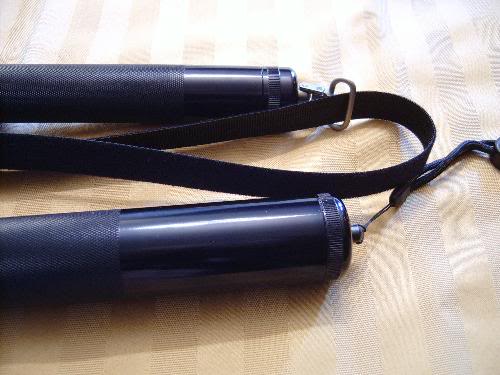

    STREAMLIGHT TWIN TASK 2 L

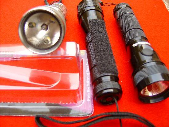

    It is easy for me to do an objective review of this light. I have been using a couple of them for two years, quite often (not exclusively because I own other lights also for everyday use).
    The light has performed extremely well for me. The Twin Task uses for power two lithium 3 volts, 123 batteries, and it have two light sources, one xenon bulb of 72 lumens and three Nichia 5mm LED’s of about 7 lumens each.
    The LED mode will last for 28 hours (I have to take the word of the manufacturer for this, because I haven’t done a run time that long). And the Xenon bulb’s run time will last for 2 ½ hours.
    The light is quite comfortable in the hand and similar to others 123’s lights, measuring 1.34” wide and 5.43“ long, and weighing at 3.37 oz.
    Due to the micro-faceted reflector, the flood with the three LED’s or the Xenon bulb is ample. If you don’t have to illuminate things at a distance the light is useful for chores inside the house or in the campsite or trail.
    I have used it mostly with the three LED’s and I have come to believe the run time of 28 hours claimed by the manufacturer because after two years of sporadic use the light is still going in the same battery set.
    The switch is on top of the head, as this is not a “tactical” light I found the switch convenient, so does my wife, that have the same model but in Titanium finish.
    The focus is adjustable, but even in the tight setting the light have a lot of flood. I have lend my second light to my hunting pal Frank, that left it on the three stand for a week, on returning the light it was just the same in finish having weathered the week without any mark or discoloration. So, I didn’t have any problem dunking it for a couple of hours in a big glass of water to see if it really was waterproof, and yes, it was, so far at this depth.

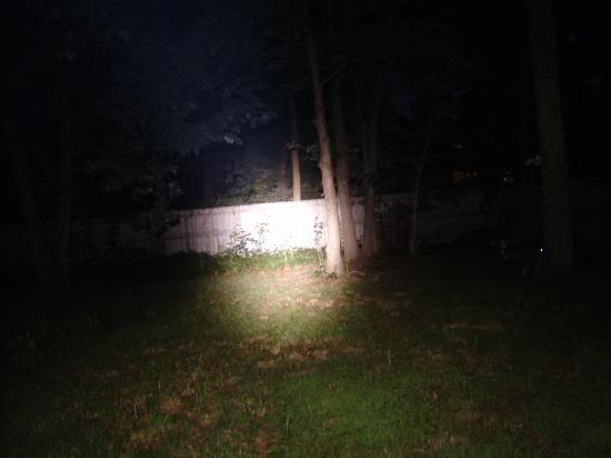

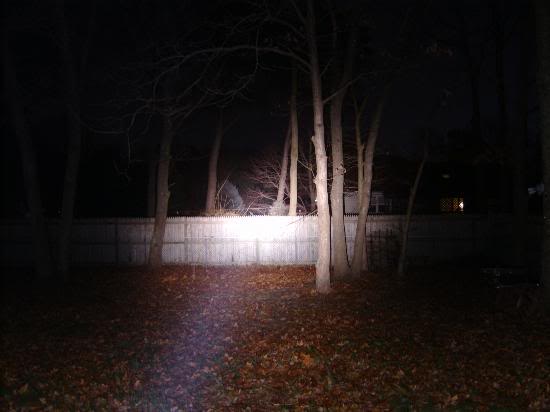

    The beam shot at 26 yards using the xenon bulb doesn’t look impressive at all, and that is because the reflector is designed for extreme flood, but that is okay, this light is mostly for using indoors, walking the dog or for hiking a trail at the most.
    In this picture one of my Twin Task have a Velcro tape, this match with the Velcro in my baseball cap, and allow me to have my hands free for doing any chores while directing the illumination where I am looking.
    The street price is about $32 USD and I think that it is quite reasonable for the quality of the product, based on my experience with it I can recommend it highly.

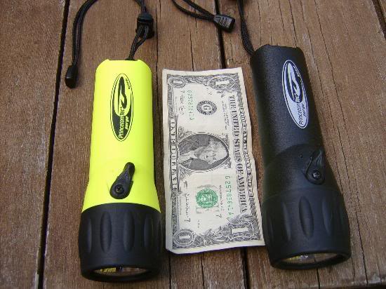

    This here is a dive light, but so inexpensive (around $30) and so suited to camping, hunting and having around in boats and wet places, that I have included it in this thread.
    A couple of years ago a store was having a sale of them, and I grabbed a bunch to have near the family in case of fire.
    They output 105 lumens which is a considerable amount of lumens for such a small light working on eight AA batteries. The batteries are in parallel, so it will also work with only four batteries (and will float) with a reduced run time.

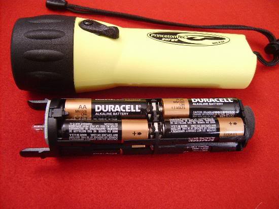

    The Surge and the battery carrier and bulb combination
    It is said that the light will work for 5 hours on a full compliment of eight batteries. I have never conducted a run time test, so I can’t testify that this is true. Other Princeton Tec products that claim the same run time (Q40) have fallen short.
    The bulb is a 7.5 watts and quite bright, my Surges have a deeply stippled reflector that produce a good flood light and by twisting the head it can be opened to even more flood, but I don’t recommend playing with the head underwater as it can compromise the waterproof level of the light.
    The instructions claim the light is waterproof to 500 feet. I am a landlubber and never find myself more than six feet underwater, but Princeton Tec is famous for their dive lights and I haven’t heard any complains from divers.
    I put the light in my fish scale and it weights 10.8 oz. with batteries and the handy lanyard that comes with the light, so despite all those batteries the Surge is very lightweight.

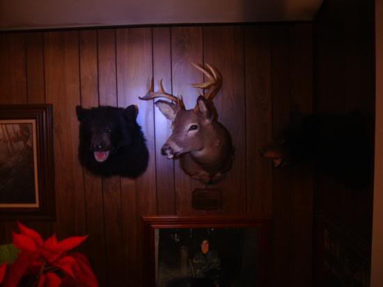

    Beam shot of the Surge against my deer and bear targets from 26 yards

    [FONT=Calibri]The throw is considerable, rivaling my Streamlight TL-3 and reaching as far as 68 yards, if you consider the low price of this light I say you get a lot of lumens for your money.[/FONT]

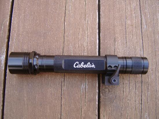

    CABELA’S XPG XENON FLASHLIGHTS
    12 VOLTS MODEL
    180 LUMENS AND 90 MINUTES RUN TIME
    This light uses four 123’s and is 7 ¾ inches long. The claim of 180 lumen output and 90 minutes run time is what attracted me to buy one; besides, the price is only $50.00.
    With the 123’s at almost $2.00 each with shipping, running this light is not precisely inexpensive, but is much better than running a Surefire 9 P with the P-91 lamp for 20 minutes to get 200 lumens.

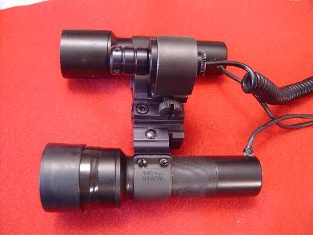

    This light went into one of my rifles; that is why it is set up with a Leupold ring.

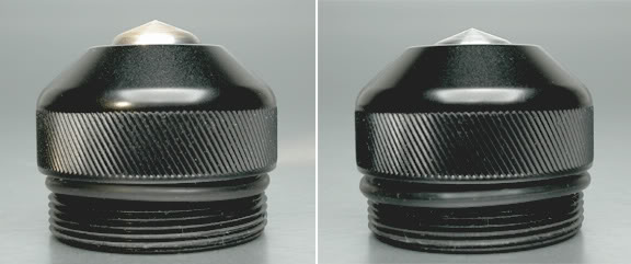

    This light is almost a copy of the 9P, but longer at 7 ¾; the tail-cap differs in that the switch is not momentary. When you press in the XPG switch, you click it on, and to extinguish the light, you click it off.
    This feature will remove this flashlight from the “tactical” field; it is very important for tactical use to have a momentary switch so you can strobe it, or so you can control the light the way you want. It is important just in case you drop your light, that you will not get illuminated by your own light.
    The lamp of this light is very similar to the P-91 Surefire lamp. The reflector has the same finish and configuration, and at $18.00 for replacements it is not bad at all.

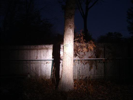

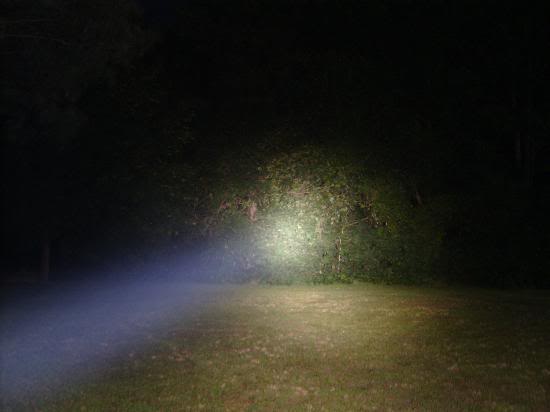

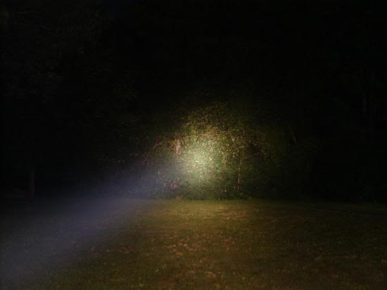

    To find out how it compares with the beam of the 9P or Surefire C-3 with the P-91 lamp (200 lumens for 20 minutes on three 123’s batteries), I tested the light at my usual 26 yards against the same bear-and-deer target that I used before for all the other lights, and from the same distance with the same settings.
    As the reflector and head are so similar between the two torches, I was expecting very similar results in illumination, as the 20 lumens difference is not really so important to change the results in a big way.
    So here are the pictures, and you can see for yourself how they compare.
    CABELA’S XPG XENON 12 VOLTS (180 lumens for 90 minutes on four 123’s batteries)
    SUREFIRE CENTURION C-3 (With P-91 lamp for 200 lumens. 20 minutes run time)
    BEAR CUB 220 lumens for 90 minutes, rechargeable.
    Lumen output is not all that is important to have a light that will be useful at a certain distance. The diameter of the reflector has a big influence in how those lumens are going to be distributed.
    For example, in the same league in lumen output is the rechargeable Bear Cub, (220 lumens for 90 minutes), but the deep 2” in diameter smooth reflector of the Bear Cub will throw the light much farther and with more intensity than the small reflectors of the Centurion C-3 or 9 P or the Cabela’s XPG can.
    Actually the XPG and the Centurion C-3 are very good (as you can see in the pictures) at the 26 yards distance, but at 45 to 50 yards they have reached the end of their useful illumination.
    Cabela’s have always offered good value for the money, this light is not the exception, for the price it is a more than excellent light and the long run time offset a little the expense of buying four 123’s batteries to run it.

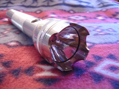

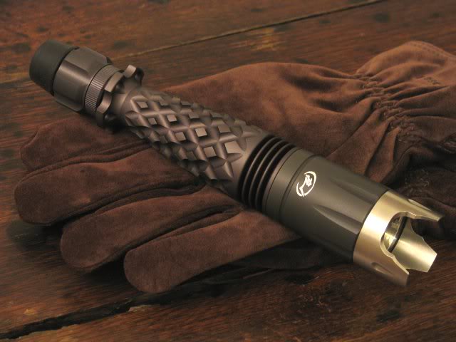

    THE BLACK BEAR 720 LUMENS
    RECHARGEABLE FLASHLIGHT

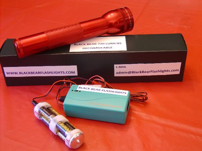

    The Black Bear 720 lumens flashlight is 10 inch long and weights 23 oz. It has all the same high quality state of the art components as its bigger sister the Borealis 1050 lumens.
    The Black Bear is made on the “host” of the Maglite 2 D., which is one of the advantages of the Black Bear System, as when after hard use, if the light is scratched or dented, a new host can be replaced inexpensively available almost anywhere, and the transfer of parts takes only ten minutes of the owner’s time.
    The only difference between the Borealis and the Black Bear 720 (beside the shorter length) is in the shorter Rolls Royce battery carrier (for six batteries) and the reduced voltage super-bulbs.
    The light has a 40 minutes run time and outputs an incredible 720 lumens, all this with rechargeable Nimh in the Rolls Royce battery carrier. This unit plugs into the charger for a 4 ½ hours charge.

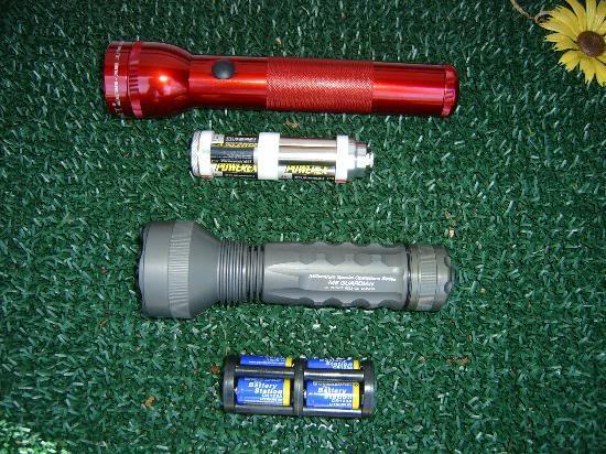

    THE BLACK BEAR 720, ROLLS ROYCE BATTERY CARRIER AND CHARGER

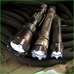

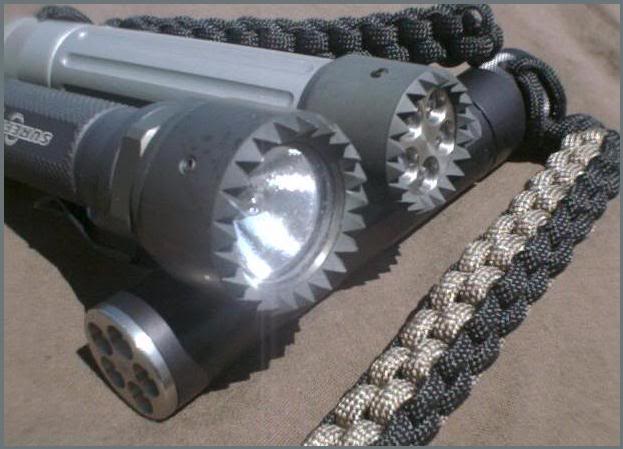

    It is almost impossible to talk about the Black Bear 720 without mention its closest competition, the Surefire M-6.
    The Surefire M-6 is well known in the tactical circles as the light used by SWAT teams and Special Forces, This light that cost close to $400, is 500 lumens for a run time of 20 minutes, running on six disposable 123 batteries, yes that is right! it uses six batteries, a value of $12 for a 20 minutes run time.
    THE BB720 IS NOT MUCH LARGER THAN THE M-6, AND IT HAS A BETTER BATTERY CARRIER
    Clearly, the Black Bear 720 lumens is a better value as the batteries are rechargeable, with a life of 1.000 recharges and the run time is of 40 minutes.
    When the BB 720 needs new batteries after 666 hours of running, a new set costs only $30.
    While the M-6 has only one choice in reflector finish, the light stippled, the BB720 has a choice of four reflector finish, to customize the light to your work. Wildlife officers doing deer census in the field will want the long throw capabilities of the Smooth (mirror finish) reflector, same as firefighters that need to punch a hole in the smoke. Others can use the Orange Peel for a little more flood, and the law enforcement officers will like the capabilities of illuminating an entire warehouse with the extra flood provided by the Light Stippled and Medium Stippled reflectors.
    None of the other incandescent flashlights used for military/police work will get near the lumens output of the BB720, the Magcharger is 200 lumens and the most powerful of the Streamlights, the Ultra Stinger, is 295 lumens.
    The shorter size of the Black Bear 720 makes it a natural to store in the car, inside the glove compartment, and it is not too heavy to be carried in a trench coat or overcoat pocket and the power in lumens compares to a car’s headlights or to a one and a half million candlepower spotlight, really an amazing performance for a light of this size.
    Surefire M-6
    Black Bear 720
    Like its bigger sister the Borealis 1050 lumens, (12 ½ inches 28 oz.), the BB720 is hand made one by one on a semi-custom basis, using state of the art components and lots of hand labor to reduce internal resistance to make the white light that is the trademark of the Black Bear Flashlights.

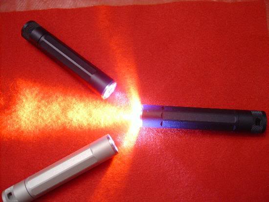

    INOVA X5 T LED FLASHLIGHT
    My INOVAS X5 Tactical are about two years old; I bought them because the futuristic design, quality of materials and workmanship and because of the revolutionary technical advances in illumination was state of the art at the time of my purchases.
    The INOVA X5 is a beautiful light, the smooth soft flood provided by the five Nichias 5mm LED’s is unparallel (or was at the time) in flood light illumination for short range.
    Comparing it with others LED lights of the time like the Peltz Tikka (3 LED’s) the illumination provided by the elegant INOVA was far superior in flood and in range.
    Probably the reason is the two 123’s batteries that the light works with, we have here 6 volts of power for the five Nichias, providing up to twenty hours of run time.
    Physically the light is 865.” in diameter and 4.75 “long and weights 3.56 oz. the flats along the body provide a nice grip, the tail cap is knurled very fine and it have a transverse hole for a lanyard. The tail cap is a “tactical” one in the sense that it can be pushed momentarily (on the soft pad) for illumination or can be locked steady for constant by screwing it more. It also have a lock up feature (unscrewing the tail cap a little) to prevent accidental activation.
    I think that I paid about $37 or so for this light, it is a high quality light and worth the money, it will not have a long range and the stated 120 feet in the literature of the package seems a little excessive to my eyes, in any case it is a flood light and not a light for distance.
    For the same reason I am not doing a beam shot to my customary deer target at 26 yards, the camera will not process enough light at that distance.
    But this beam shot at 13 feet can’t give you an idea of the soft even flood illumination with a more intense center.
    There are some X5 that have a different switch (one that is not tactical) these lights doesn’t have the “T” denomination in the package.
    The user of this light for the first time will be surprised by the arrangement of the batteries. They are installed with the positive going toward the tail cap. The threaded tail cap is butter smooth in the threads, high quality all the way in this light, good solid feel without being heavy and according to the literature, crush-proof to two thousand pounds.
    The lights come in black matte anodizing or satin nickel, (called Titanium finish) and I have one of them sporting RED LED light, this red light X5T for some reason needs only one 123 battery. This is the light I use to drain all capacity from 123’s batteries that can not longer power my incandescent Surefire Centurion III. You can get several more hours of illumination from those “depleted” 123’s when used in this light.
    Although we have now more powerful LED lights, the INOVA can provide many hours of illumination from the batteries and is a pleasure to use such a well constructed and designed high quality torch.

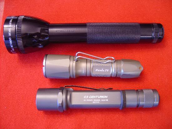

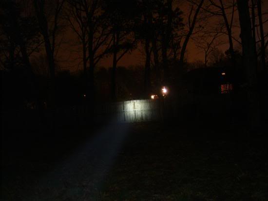

    Fenix has come out with a new LED tactical light. It runs on two 123 batteries and outputs in the high setting 225 lumens for 1.5 hours. In the low setting of sixty lumens it lasts, according to the instructions, 10 hours.
    This new light uses a Cree Premium Q-5 7090 XR-E that is said to make 225 lumens. It could very well be as it trounces every other LED light that I have in the stables, including my darling E2e modded with MacGizmo PR T head.
    The light output is really impressive for an LED; it even has a very decent throw that is sufficient for tactical use inside and even outside.

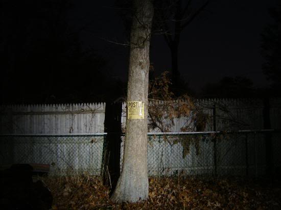

    I have tested it against other tactical lights like my Surefire Centurion III with P-91 lamp (200 lumens) and it really compares very well, to the point that I will carry from now on the new T-1 instead of the Centurion III.
    My neighbor’s door is 50 yards away and the light illuminates the target quite well. The package says that the range is 200 yards, which is an exaggeration, and I can’t see any illumination at a target placed 200 yards away. My regular testing for long distance is a hydrant at 88 yards and a group of trees at 111 yards. This light will illuminate the hydrant, barely. I can see that the outline of the hydrant is there (The same with the Centurion III) but I can’t make out any detail or see it sharply. If the target were a human at that distance, I will be not able to tell if it is a bad guy with a gun or a nun with a cell phone.
    My incandescent rechargeable Bear Cub light at 220 lumens can illuminate the hydrant and the group of trees at 111 yards and go beyond, It is well known that incandescent provide longer range and better definition. Granted the Bear Cub has a bigger reflector and the light itself is longer at 9 inches.
    THE BEAR CUB 220 LUMENS, THE FENIX 225 AND THE SUREFIRE CENTURION III WITH P-91, 200 LUMENS
    The T-1 has a massive head with a wall of 4.5 mm thickness, and the light is quite heavy in comparison with other tactical lights. But it is the price you pay for running an LED at 225 lumens, as all this mass of metal is needed to divert the heat away from the batteries.
    You may know that the LED’s unlikely incandescent that throw the heat forward as infrared, accumulate heat near the source of light, that is why they have to have a heavy heat sink, this heavy head act as one.
    Otherwise the heat will reach the batteries and when a certain point is reached the internal protection that the 123’s batteries have, will cut down the juice, and stop the light.
    So, they advertise the light as been built like a tank, but now you know what is the real reason behind all that metal at the head.

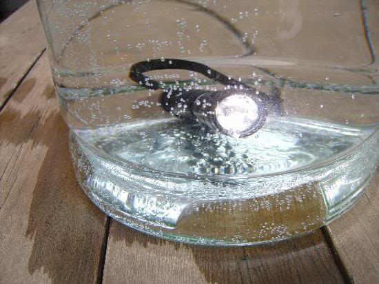

    The light is say to be waterproof and it passed my four hour test in a BIG glass filled with water. Now in winter is no way that I am going to test it further by doing some diving.
    I love the switch; it is just have the right feel for the momentary action, so good that it can be strobe as fast as you want if that is your cup of tea for tactical encounters. It is permanent on by clicking it, and can be unscrewed to put it in safe mode for when you carry the light in luggage or back pack.
    The tail cap of the switch has a hole for a lanyard that is included and you can stand the light on its tail cap on a flat surface for a candle mode. What you cannot do is use this light with the Roger-Surefire or cigar grip because the rubber button is recessed flat with the tail cap.
    Inside the package I found a spare button and O rings, I applaud that move by Fenix, and it is appreciated as some of us use the lights hard.
    The T-1 comes with a holster, which is okay, but it also have a sturdy clip that grasp my belt very well and lower the profile on your waist in comparison with the holster. The only thing about the clip is that it rubs on the body of the light when you want to access the low mode of 60 lumens. We will see how good is the hard anodized type III as the clip is rubbing against the light with a good pressure and I suspect will be soon marked by a line.
    BEAM SHOT OF THE THREE LIGHTS ABOVE, 26 YARDS RANGE, CAMERA AT 12 FEET
    FENIX T-1
    SUREFIRE CENTURION III WITH P-91 LAMP
    BEAR CUB 220 LUMENS
    Anyway I think that the Fenix T-1 is one of the better lights that have hit the market lately, it is very rugged and is very well made, and well worth the price of 76 USD that I have paid for it.

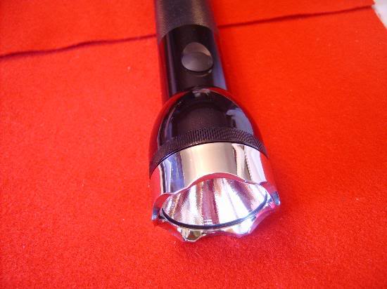

    HUSKY 2D 3 WATT LED LIGHT
    I was at Home Depot and I spied a new light in the flashlight section. The new torch is a HUSKY brand, which is a brand name of Home Depot. I have used some of their inexpensive lights; they are made in China and represent a good value in some models.
    The new light uses two D batteries (that are included in the package) and the source of light is a three watt LED. The difference in this torch is that the switch activates three different levels of illumination.
    The package lacks any instructions and doesn’t even mention the output of the light or the run time. So I am guessing that the first mode (the first click) is a 12 lumens light, second click at 40 lumens and the last click about 80 lumens.
    The idea of having three different levels is good, it will conserve battery juice when you just need a little light for illumination, and at the same time, the other two settings are there for more lumens when you need to reach farther or put out more intensity.

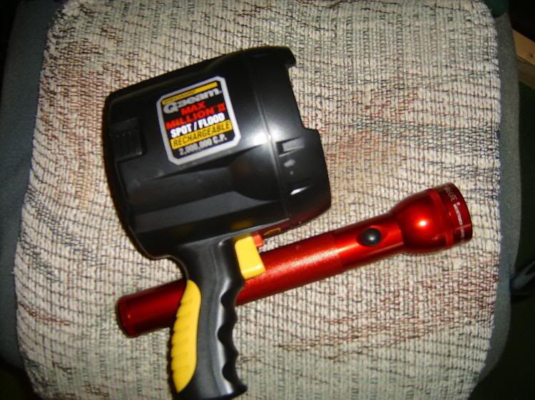

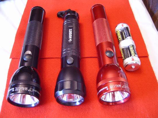

    As this thread is all about comparisons, I decided to pit the new HUSKY against a Maglite 2D LED 3 watt that I bought a few months ago. I purchased the Maglite from Wal Mart for $24 USD, but I think that it was on sale at the time, still price wise the two lights. Compare.
    The HUSKY is ½” shorter, otherwise they compare physically to each other and they weight the same, although the HUKY have a slightly smaller head.
    The outside of the Husky is finished in a slightly duller anodizing than the Maglite; both lights look handsome on the outside.
    In the inside the Husky shows the threads of the tail-cap, body and head very rough. Removing the head I found an adequate heat sink, although the mounting of the LED looks a little lousy. I wanted to take a look at the reflector and plastic lens, but it was not possible to remove the bezel despite my superhuman and my weight-lifter friend efforts - the bezel seems to have been super-glued in place.
    The tail-cap sports a flimsy lanyard that I will not trust to hold the light for long, and looking inside at the switch, I found it very cheesy looking, more appropriate for a toy than for a flashlight. The little strip of metal where the battery makes contact with the switch, it doesn’t look good either.
    The Maglite 2D on the other hand, is a high quality product with butter smooth threads, a switch that will last forever and a lot of well thought-out features (cam action, self cleaning switch, etc).
    The Maglite is an American product that should cost much more of what it does now. Old timers may recall that when they first show up in the 1980’s the price tag was $60 USD and that they were selling like hot cakes, the engineering of the Maglite was at that time well above any of the existing lights, including the Kel-Lite.
    In the picture you can see the Maglite 2D LED on left, the Husky light in the middle, and the red one on right is a Black Bear 720 lumens, (1 ½ million candlepower) a custom made light that shows how much illumination we can put into a Maglite “host” 2D, with a little ingenuity, and if the people are willing to pay the price of a custom product.
    Here are the beam shots for comparison, 35 yards to the fence.
    HUSKY 3 watt
    MAGLITE 3 watt
    My impression is that the Maglite has a much better beam, in color rendition and in intensity. Also, I can throw the beam of the Maglite much further than the Husky, even that both lights are 3 watt, the Maglite is better in quality of LED and power.
    Granted - the Maglite has a 2” full reflector, while the Husky could be only 1 ¾ “ that could account for the better throw, but the Maglite definitely has a whiter beam and it is more intense.
    All the best

    I very recently bought a new Q-Beam two million candlepower spotlight. I am a big user of spotlights, in my case I use them to give demonstration of the power of the Borealis 1050 lumens flashlight, in police reunions, night shots, and seminars.
    When my eight month-old battery for my two million candlepower Optronics spotlight gave up the ghost, I had to get a new spotlight.
    I spied the Q-Beam at Wal-Mart and I bought it on the spot. It is a large spotlight with a four-and-three-quarters inch reflector, and with some extra features not available in other spotlights.
    For starters, it comes with two removable batteries. One battery could be on the light while the other is charging, a good feature. Unfortunately, in my case, one of the batteries was already dead and is not recharging. I will have to return the unit and get another, hoping for better luck.
    However, bad batteries are nothing new in big spotlights. It seems that the Chinese haven’t gotten the hang of making lead acid batteries last any decent amount of time. I know; I have the corpses of seven spotlights to prove it (some day I will get around to rounding them up and take a picture of them).
    I can safely say that I have tried all of them, and I can tell you that a quality spotlight is not available in the USA, unless you buy one of the Australian’s Night Force spotlights. Australians, with their liberal night hunting laws, know a thing or two more about night hunting and lights that the average American hunter does.
    For law enforcement the panorama is different. With the advent of the Borealis 1050 lumens flashlight (12 ½” long, 28 oz) a spotlight in the cruiser is no longer needed.
    After all, spotlight use for law enforcement is confined to operation from the car, which is why you don’t see a trooper conducting a traffic stop with spotlight in hand or chasing down a suspect with one in tow.
    Coming back to the Q-Beam Max Million II, it also has another feature that was not available before in any other spotlight; a double trigger that when touched high, can activate mechanically a spring that will push the smaller part of the two-part reflector/ bulb holder, forward. This causes the focus to change to a wider flood; interesting concept, but perhaps of dubious utility. I have seen it employed in flashlights before, but by the use of two filaments positioned in the bulb envelope at different heights.
    Here is a picture of the Q-Beam together with the Borealis
    Unfortunately the Achilles’ heel of any spotlight is the quality of its batteries. In the normal use that I give them, they never last more than 6 to 8 months, which is why I am not looking to pay more than half a century note for one, with is just what the new Q-Beam cost me at Wal-Mart.
    How does it compare with the Borealis 1050 lumens (two million candlepower)?
    To answer that question, I move them to the backyard of my local church, where I have a solid wall of trees and a range of 35 yards (I try to avoid solid light-painted walls that produce too much reflection and confuse the camera).
    Q-Beam Max II Spotlight
    The new Spotlight did well in comparison, but it is more inside the range of the Black Bear 720 lumens (10 “ long 23 oz) than of the more powerful Borealis. Here are the pictures for you to judge; of course the Borealis and the BB 720 are better law enforcement tools as the side spill is bigger and the intensity and the color are brighter. Of course, you need side spill to avoid panning a tight focus’ light and losing precious seconds when clearing a room or warehouse.
    For those that use the Q-Beam for varmint shooting (with a partner to hold the light of course) the light will do okay up to 300 yards.
    For that use you can take advantage of the red filter (at shorter distance) and the other two filters, ( blue and amber), are completely useless for varmint shooting and for any other use I can imagine, as I can not see a blood tracker using such a big spotlight with the blue filter on it.

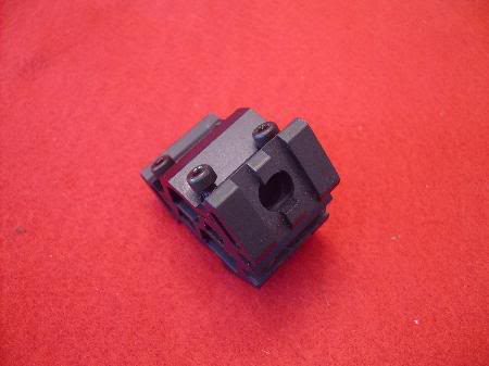

    THE UTG BARREL MOUNT
    [FONT='Arial','sans-serif']
    Hi guys,

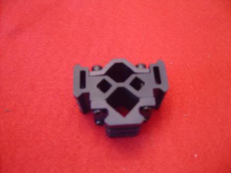

    For those wanting a barrel mount for a flashlight or laser, I have had good
    results with the UTG barrel mount.
    Initially purchased for an AK rifle, I found out that it can be mounted in
    other rifle barrels, for example, it fits perfectly in a .22 rifle and also in
    a Mini 14 I have.
    It is a tri-rail mount with three Picattiny rails that will also accept Weaver
    style rings. My model is the #2 mount which have two slots; the UTG is also
    available with five slots that will accommodate the red dots scopes that are
    in the market.
    Picture of the UTG # 2 [/FONT]
    [FONT='Arial','sans-serif'] [/FONT]
    [FONT='Arial','sans-serif'][​IMG]
    Another view [/FONT]
    [/FONT]
    The UTG fully loaded with two TACM III tactical lights (one with a red filter)
    and a laser.[/FONT]

    As strange as it sounds, some flashlights are used for self defense quite often in daily life.
    Sometimes by professionals Police Officers in a way to avoid using deadly force in confrontations with suspects, and other times by civilians that are not permitted to carry lethal weapons.
    In the US we have it quite good in that we are allowed to carry short knives and some others implements but in the majority of Europe such activities are illegal or highly frowned upon by the authorities.
    If you defend yourself with a baseball bat even in your own home in certain countries you have to give reason for why you have such an implement with you.
    Other lights use others means of incorporating defense mechanisms in their construction. I am thinking now about the ARES Defense Companion, a Maglite with 3 cells that incorporates a shotgun of 410 gauge (only one picture is circulating in the Internet and I think is not in production) or the Tiger Light that incorporates a pepper spray canister, or the several models of Surefire that come with crenellated bezels (one example is the popular E2D executive Defender).
    Surefire was the first (to my knowledge) at popularizing the crenellated bezel and the SureFire Institute offers a class in basic defensive tactics called “The power of Light” which is open to all qualified civilians as well as law enforcement professionals .
    The course is taught by certified instructor Steve Tarani (shown below delivering a carotid strike).
    The Borealis flashlight can be had with the optional heavy stainless steel crenellated bezel that is offered in a limited production run.
    Such bezels add 3 ounces to the weight of the head and the bezel even that is not actually sharp will be a good imitation of the broken beer bottle.
    I don’t think that an aggressor, if he is in his right mind, will confront such a weapon that first will blind him with 1050 lumens and then is ready to rearrange his facial features.
    The Royal Borealis uses a Quick Detach Swivel, that when used only with the nub for the lanyard, can be very hard on skulls and noses.
    This old Borealis model sports the heavy 3 inch head (the head is now out of production), more resembling a medieval mace. This is also a fantastic throw monster reaching over several hundred yards.
    I have in my long association with the flashlight Industry seen a few models which spray OC from the front of the lens, flashlight that also incorporate a screaming siren, flashlights that incorporate a stun gun and others weird contraptions all of them gone from the market now.
    What seems to prevail is just a good weight reliable flashlight that can be used as a baton or with the new crenellated bezels and the introduction of really powerful MEGA lights capable of blinding an assailant.

    Unless you use a heavy stainless steel crenellated bezel like in the Borealis, the others made of aluminum are a poor tool for auto-glass.
    Initially the crenellated bezels were used to let light escape when you put the flashlight head down. (So you know the light is still on and avoid scorching the counter)
    To break automotive glass, the but of the flashlight is used, even one outfitter propossed a carbide insert in a optional tail cap for the Maglite. (See picture)
    If you want something similar, you can drill a hole and install a solid brass or steel drawer pull from Home Depot.
    If you doubt that the bezels are intended for striking flesh, look at these pictures.
    The Borealis have an optional low profile, stainless steel, rounded crenellated bezel, without sharp corners, here is the picture.
