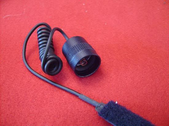

    REMOTE SWITCHES
    WITH PRESSURE PAD
    Hi guys,
    I have been using remote switches in my tactical lights that are mounted in rifles, shotguns, and bows, for quite a few years now.
    The most effective of them are the ones with a direct connection to the solder pad that touch the battery (no spring), like the ones in the TACM III tactical lights.
    The reason that they are more effective is that they don’t rob the system of any voltage (in the way of internal resistance) as do the ones with heavy springs.
    Internal resistance is the name of the game, some of them, for example the TAC STAR pressure switch, can really make a bright lamp like the P-60, looks dim and murky, due to too much internal resistance in the design of the tail cap.

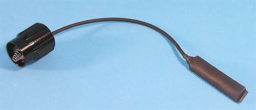

    THE TAC STAR REMOTE SWITCH
    A good one that I have used for years in mounting lights on my friends’ bows and rifles, is the G&P tail cap with remote. Its design is quite good and the internal resistance is low, but it is not designed for pump shotguns as the cord is just straight and not curly.
    THE G&P REMOTE SWITCH

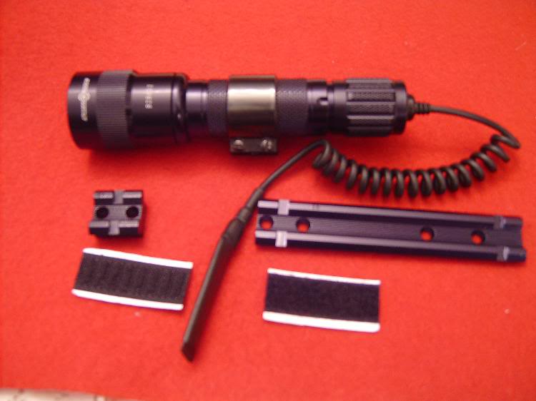

    A very good one that I discovered recently is the Aimshot curly cord remote, the spring is copper and quite light and it seems to have very low internal resistance.
    I discovered the Aimshot in Cheaper Than Dirt catalogue and at a very good price ($14.97) and it has become my favorite.
    I just used one in a Pelican M-6 tactical light and mounted it using a UTG Tri rail mount in an AK rifle, it does the job well.
    THE AIMSHOT REMOTE SWITCH

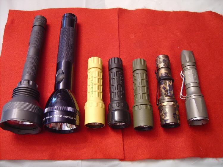

    The lights as they appear in the picture are, from left to right:
    Surefire M-4 MN60 lamp 225 lumens for 1 hour (running on four 123’s batteries)
    Bear Cub 220 lumens for 90 minutes, rechargeable
    Surefire G-2 in yellow. It is 65 lumens for one hour with the stock P-60 lamp
    Surefire G-2 in black, Lumen Factory lamp incandescent of 160 lumens
    Surefire G-2 in green, Cree Q-5 by Deal Xtreme, 200 lumens
    Surefire Centurion 2 in Jungle Camo, 290 lumens (claimed) with the Cree R-2 lamp
    Fenix T-1, 225 lumens using a Cree Q-5 lamp

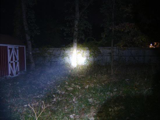

    And now the pictures, target is 20 yards away, watch also the amount of side spill as well as the throw.
    SUREFIRE M-4 DESVASTATOR 225 LUMENS
    BEAR CUB RECHARGEABLE 220 LUMENS
    SUREFIRE G-2 YELLOW 65 LUMENS
    SUREFIRE G-2 BLACK LUMENS FACTORY 160 LUMENS LAMP
    SUREFIRE G-2 GREEN, DEAL XTREME LAMP CREE Q-5 200 LUMENS
    SUREFIRE CENTURION 2, CREE R-2 290 LUMENS (CLAIMED)
    FENIX T-1 CREE Q-5 225 LUMENS

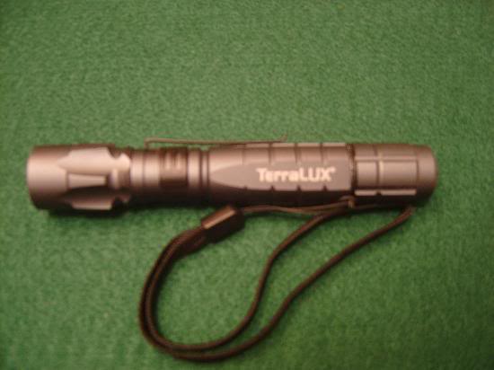

    TERRALUX LIGHTSTAR 220
    FLASHLIGHT
    For the last two months, I have been using one of the Terralux Lightstar 220 lumens flashlights, which runs on two AA batteries.
    This light has two settings on the click-tail cap; the first setting clicks on the light and emits 220 lumens for 1.5 hours.
    The second setting of 100 lumens for 6 hours is accessed by softly pressing the rubber button switch.
    The LED is a Cree RXE Q-4 and is controlled by a microprocessor for a constant light output. When battery juice is running low, the LED will flicker to let you know that is time for new batteries.
    The unit comes with two Energizer AA batteries, a lanyard and a soft nylon holster. At an even six inches long, the light is quite portable and also features a clip to attach it to your belt or waistband.
    It is very similar to the popular 3 watt 80 lumens Ray-O-Vac Sportsman Xtreme (but is slightly longer as the click tail cap needs more room for the mechanism), and the head is smaller with a small orange peel reflector.
    Due to the small reflector the beam throws quite a flood despite the 220 lumens figure. Small reflectors don’t really have much throw no matter how many lumens you make the light puts out. However, it is quite adequate for most chores inside a house and practical, too, for walking the dog or a walk in the woods.

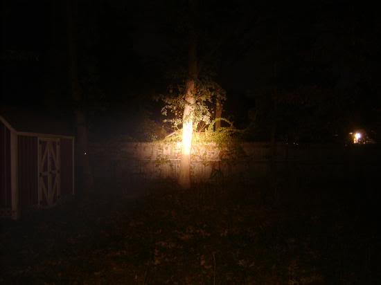

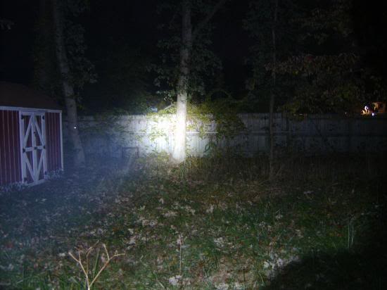

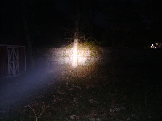

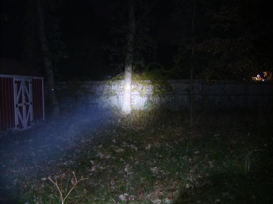

    To illustrate the point, here are a couple of pictures of beam shots at 20 yards, you can clearly see the superiority of the Bear Cub (reflector size 2”) over the Lightstar 220, (reflector the size of a dime) even when both lights are rated at 220 lumens.
    LIGHTSTAR 220 LUMENS AT 20 YARDS
    BEAR CUB 220 LUMENS AT 20 YARDS

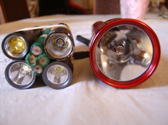

    Some manufacturers wishing to quote big numbers are now putting clusters of these small reflectors on duty size flashlights. Mind you these clusters that are from three to four are still all small reflectors with limited throw.
    So, somebody putting a cluster of four reflectors in a big head can claim 800 lumens, but you know better now, knowing that those 200 lumens for each reflector are not really behaving like real lumens!
    Unfortunately I don’t have one of those lights to prove the point. But I can get my own cluster of lights in the 200 lumens bracket, and demonstrate by picture what can you expect.
    I have here two of the Lightstar220 lumens, plus a Fenix P3D of 205 lumens and an Ultra Fire with Rebel emitter of 200 lumens, all of which together in a cluster will throw the figure of 845 lumens.
    The opposite number is a Black Bear 720 lumens flashlight, a light that is 10” long and weights 24 oz. and uses a 2” reflector that can throw several hundred of yards with a strong white light.
    HERE IS THE PICTURE OF THE CONTENDERS

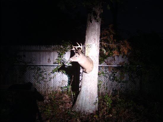

    The distance for both beam shots is in this case 35 yards to the target (The no trespassing sign tacked in the tree). The camera is 20 yards from the target.
    CLUSTER OF REFLECTORS 845 LUMENS
    BLACK BEAR 720 LUMENS ONE REFLECTOR 2”
    Observe how the beam of the 720 lumens light travels beyond the range of the cluster lights, illuminating objects that the cluster lights are not capable of showing.
    So, if you are in the market for a new light, this use of small reflectors in clusters to boost lumens figures is something you should be aware off.

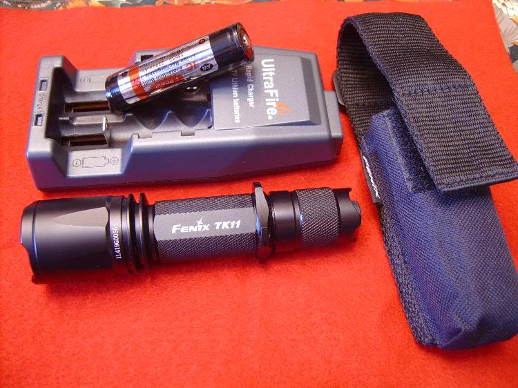

    Here is a picture of my Fenix
    The TK-11 will accept 18650 rechargeable batteries and the Ultra Fire charger is also available.

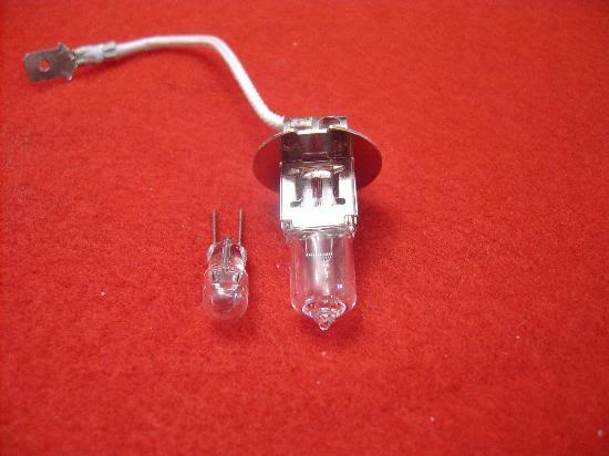

    NEW BULB FOR THE BOREALIS FLASHLIGHT
    750 LUMENS FOR 75 MINUTES
    As you may know the Borealis 1050 lumens flashlight is the most powerful military/police flashlight in use today.
    The Borealis will make 1050 lumens for 50 minutes on rechargeable batteries. Now a new bulb is available which will run the light for 75 minutes with a drop of only 300 lumens.
    Lights in use by police today are the Magcharger, the Stingers, the SL 20 up to 200 lumens, the Ultra Stinger-295 lumens, the Pelican 7060-135 lumens, and the Fenix TK series up to 240 lumens.
    Military forces use a variety of Surefires as weapon lights with 120 lumens and hand held like the Surefire M-4, 350 lumens and the Surefire M-6 at 500 lumens.
    So, the above statement of the Borealis been the most powerful is not an exaggeration, many are been used daily by police and many are doing tour of duty in Afghanistan and Iraq.
    What the new bulb does is extend the run time to 75 minutes without reducing drastically the output.

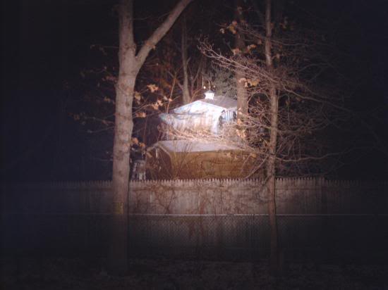

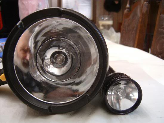

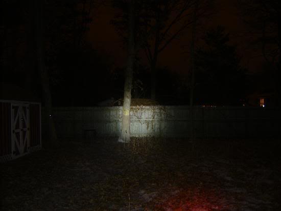

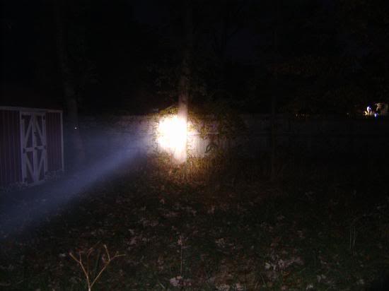

    As no other duty flashlight with the same lumens is available, I decided to conduct a shoot out against a big two million candlepower spotlight, the one at hand was an almost new Brikmann Q beam Max million II (two million candlepower) with a reflector of five inches wide and a big bulb of 75 watt.
    All this in competition to a bean sized 30 watt bulb and two inch reflector of the Borealis.
    DAVID AND GOLIATH
    FIVE INCH VERSUS TWO INCH
    This particular Borealis has a Light Stippled reflector, a reflector designed to give a good balance between flood and throw, but given the semi custom character of the Borealis three other reflectors are available, smooth for maximum throw, orange peel for just a little less throw but more flood (also called side spill) and a medium stippled reflector designed for a big flood but with the range limited to 100 yards.

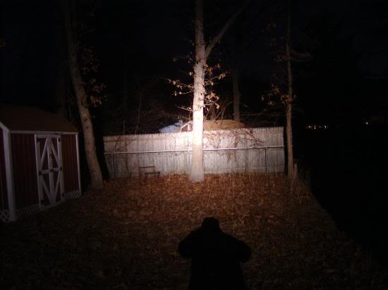

    As the night was bitterly cold I decided to take the pictures and shoot the beams right out of my second story kitchen window, with the short tripod legs resting in the kitchen sink.
    The target is the white and blue cabana which is the second building in the picture after the fence.
    The target is 74 yards from my window, with back trees as much as 85 yards (they are still visible with both lights).
    Due to the big reflector in the spot light, the beam is concentrated in the center of the picture and illumination from the side spill is not as great as it is with the Borealis 750 lumens bulb.
    Observe both pictures and you will see more area illuminated by the Borealis 750 lumens bulb, than is illuminated by the two million candlepower spotlight.
    Still the intensity of both beams is similar at the center of the target area.

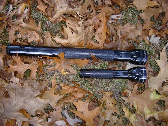

    THE BEAR CUB
    SMALL LIGHT BIG PERFORMANCE
    Not long ago to get magnum illumination out of a flashlight, I had to drop down the tube, six of the big D batteries on a Maglite 6 D size.
    That the light weights three pounds one ounce and measures 19 ½ inches was just incidental to the use if I wanted to get a really good, powerful beam.
    Later Surefire come up with small lights that could take two and three or four small but powerful 123’s camera batteries, some of those lights, come up and surpass the 181 lumens of the big Maglite 6 D.
    I am thinking now of the specialty tactical light than Surefire have as the M-4 that uses four of the 123 batteries for 225 lumens for one hour run time. The M-4 was made famous by been used in the CSI Las Vegas series.
    Incidentally the M-4 is not precisely inexpensive, costing $330 USD from Surefire or their dealers.

    Enter the Bear Cub, a nine inches light, with a 13 oz. weight that is rechargeable and uses Lithium Ion batteries.
    This little light makes 220 lumens for 90 minutes of run time, and then recharges its two batteries with a fast charger that is included, in three and a half hours.
    The Lithium Ion batteries can be recharged up to 1,000 times and when they eventually get depleted can be replaced with $30.
    HERE IS A PICTURE OF THE BEAR CUB LIGHT, NEXT TO THE SUREFIRE M-4.
    AND HERE NEXT TO THE MAGLITE 6 D
    And here a couple of beam shots at 26 yards for comparison.
    MAGLITE 6 D
    BEAR CUB
    Yes the little rechargeable Bear Cub is characterized for an intense white light, and a run time of 90 minutes, all in a small size that can fit in any glove compartment or trench coat pocket.
