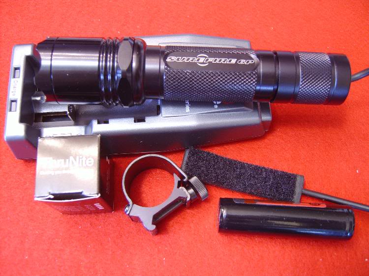

    Hi guys,
    A member of another forum has this idea of boring the inside diameter of a Surefire 6P to accept a laptop computer Li Ion battery.
    I did my own version and discover that I can get a 345 lumens lamp (LED new R-5) at close to two hours run time.
    You can mount this baby in a 5.56 mm a 50 caliber or a shotgun, it will shrug recoil no matter what caliber you shoot.
    How come?
    The heavy spring on the lamp act as a shock absorber and prevent lamp battering by the battery. And been an LED is not filament to break down.
    The special machined Surefire body is a part of the equation.
    The Lamp is a new one by Thru Nite, it is the new Cree R-5 and output and incredible 345 lumens (well more than any Surefire weapon light)
    http://www.surefire.com/M961XM07-with-Dual-Thumbscrew-Mount
    This lamp is a flood/throw and is ideal to clear rooms with the AR.
    For night hunting I am changing to a 300 lumens lamp that have a better throw (different reflector treatment) so those coyotes have to watch out.
    The tail cap has a remote cable switch with pressure pad, so I can place it on the stock of my rifle or shotgun, under my thumb. Yes thumb pressure will activate the light.
    Usually this type of light uses 123’s batteries, they go fast under the power of 345 lumens, so I opted for a long run time computer battery, rechargeable, that will last you close to 2 hours of run time.
    Moreover, when I am unsure of how much battery juice is in the battery, I just pop it into the charger and you get a full charged battery, ideal if I practice much night shooting with my AR.
    You cannot do that with 123’s primary batteries unless you are willing to dump expensive half used batteries.
    Li Ion technology will provide extend use if I don’t use the light, an occasional full top charge every 5 months will keep the battery at full capacity.

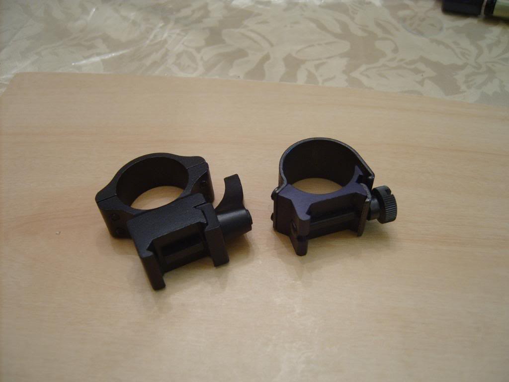

    I provided the light with a Weaver ring, but I am thinking to change it to some Quick detach lever mount like the Leupold style Weaver style for the AR, as I don’t want it on the rifle when hunting Whitetails during the day in the laurel tickets ( I hunt with a mini 30).
    Yes the Weaver detaches quick but I will need a coin from my pocket.

    This is the Quick Detach ring that I will use in my AR; it will fit the Picatinny or the Weaver bases.
