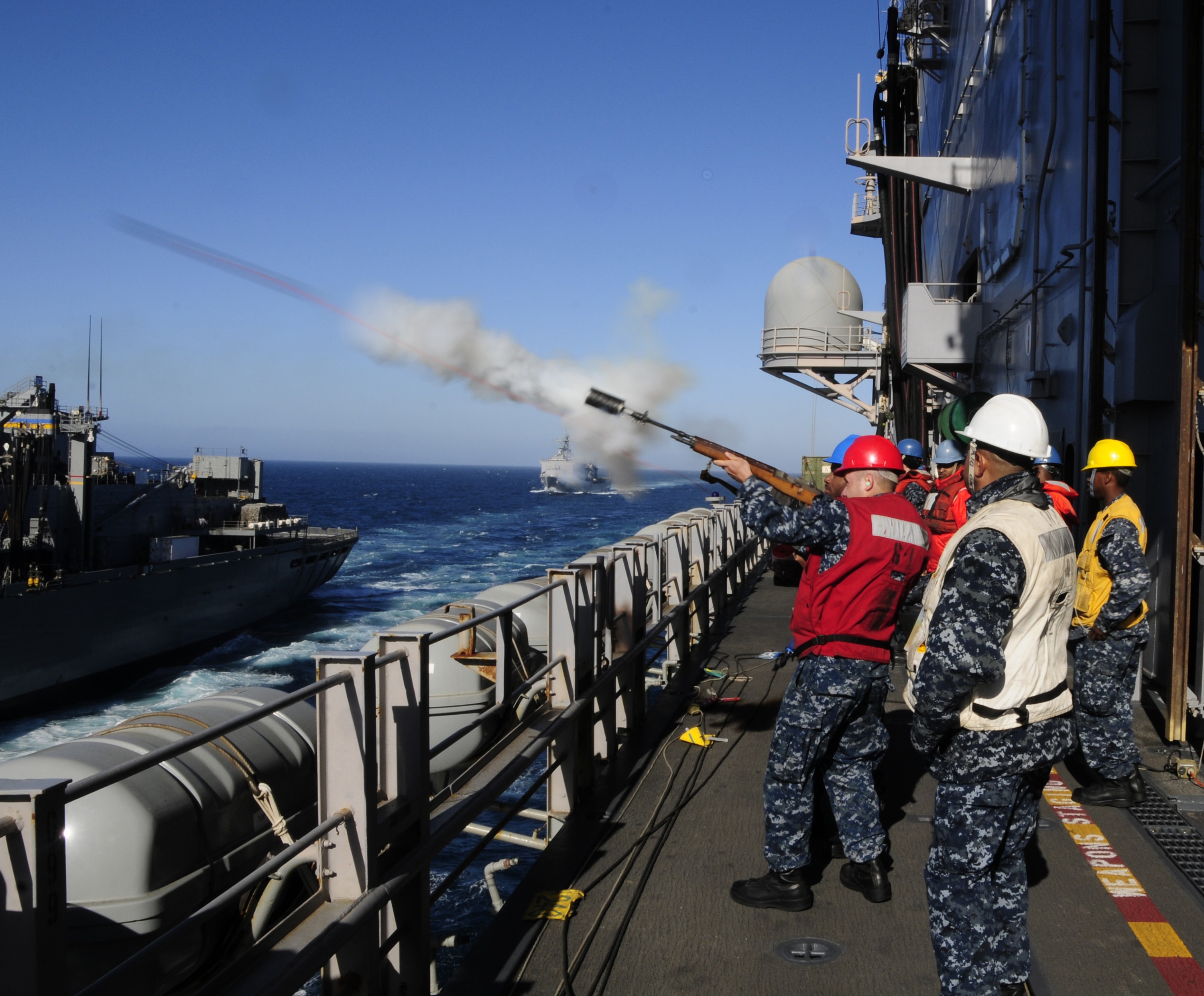

    inspired by @Seacowboys post
    The [usn] uses the M14 quite a bit
    Looks like the Canadian Navy uses an AR

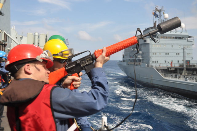

  3. sec_monkey
    it seems to be the MK 87 Mod 0/1
    when used with the M16 [m16] the flash suppressor must be removed

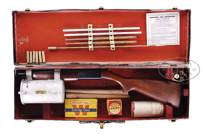

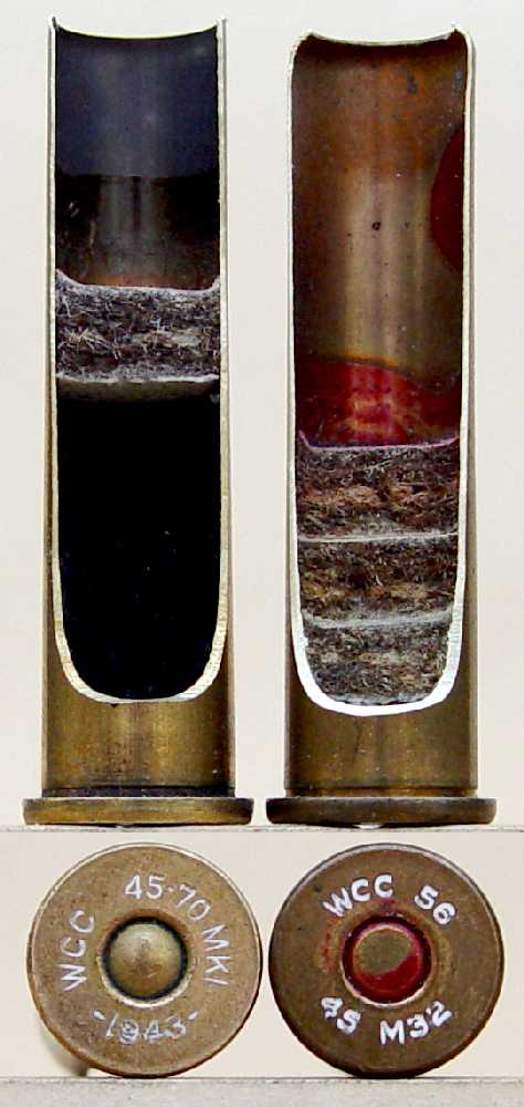

    The black powder 45-70 blanks for line throwing guns were made by Western Cartridge Company (Winchester) during WWII. They used 45 grains of black powder and were designated 45-70 MK I.
    I have some of these blanks.
    In the 1950's they made the M32 that used smokeless powder with three wads. Here's a comparison of the MK I and the M32.

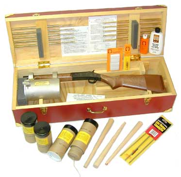

    45-70 line throwing guns are still being made and sold. H&R makes one that Bridger sells in a case with all accessories.
    Here's an older Remington 45-70 line thrower.
