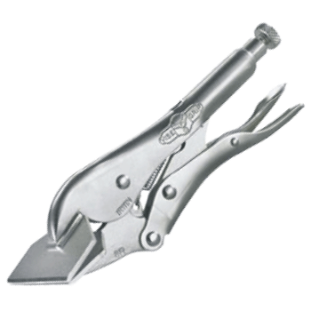

    Try a welding clamp vice grip like this one. I use one to peel deer hides off. (I use a boat winch to pull it too;))[​IMG]
    Gopherman likes this.
