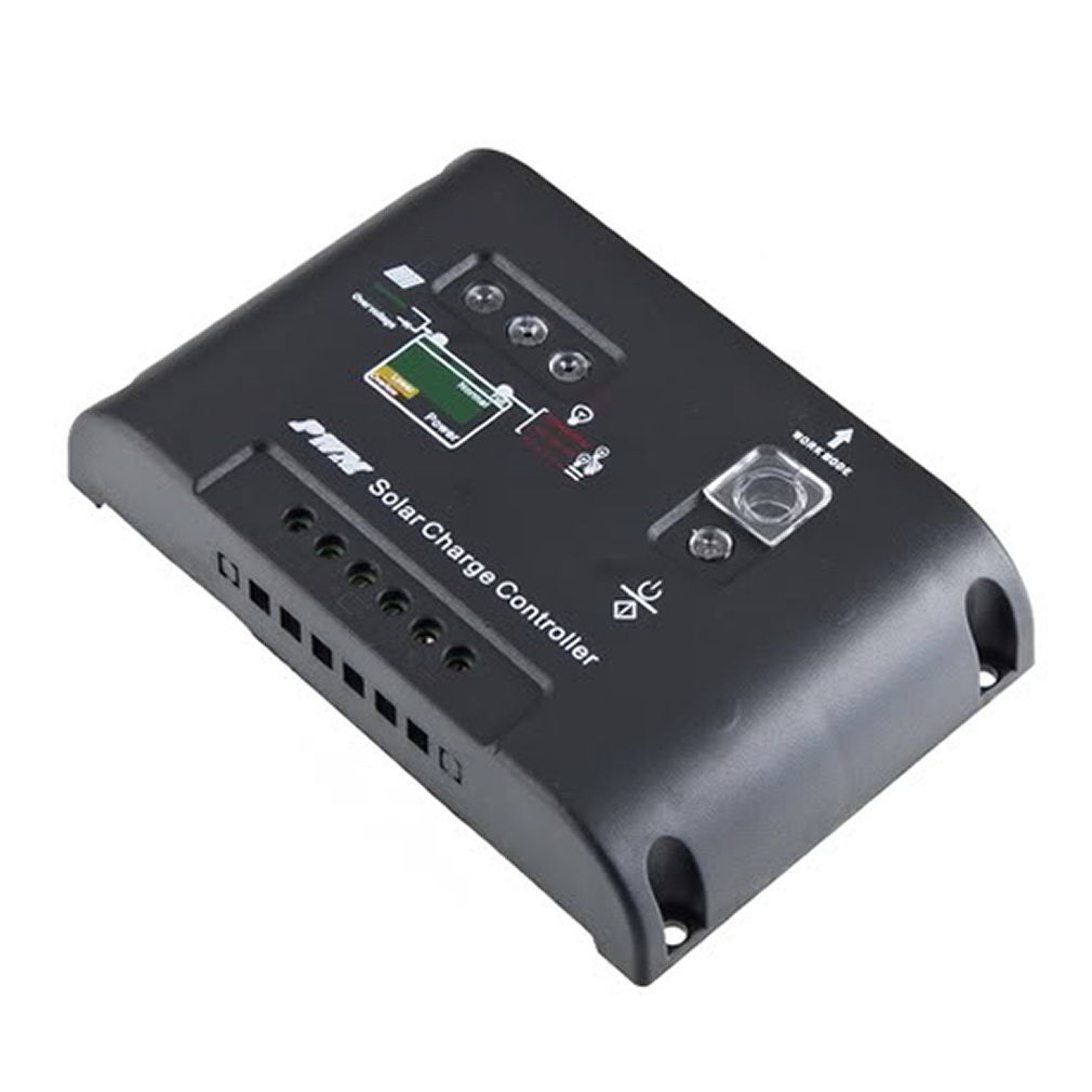

Wanted to share I have been using a low cost 30 amp PWM charge controller to do experimenting with a 100 watt panel. It seems to work really well it even has a timer that's fairly easy to use if you want to have the light shut off after a predetermined amount of hours. It's cheap enough to keep as an extra in a faraday cage. ( I got a few for bartering ) $14 with shipping from ebay about the 9th one down ohbuybuybuy | eBay
Features: 30A Solar Charge Controller Street Light Regulator 12V 24V Autoswitch Panel 720w Overcharging protection Can be used for all panels Overdischarging protection Short and Open Circuit protection Full specification available if required Fail Safe and cannot be damaged by accidental wiring mistakes Advanced design with simple plug and play technology. No need for complicated adjustments Full LED status indication: State of Charge(SOC) Red-Flat Battery: Amber-Low charge: Green- good charge: Green Flashing- Full Charge Model number: 30I Rated solar input: 30A Rated load current:30A System voltageC 12V/24V Over load、short circuit protection: 1.25 rated load current 60sec 1.5 rated loads current 5 sec over load No load current ≤ 6mA Charging circuit voltage drop ≤ 0.26V Load circuit voltage drop ≤ 0.15V Over voltage protection: 17V;x2/24V Working temperature: Industry stage -35 ~ +55°C Boost voltage : 14.6V; 2/24V (keep 10min) Direct charge voltage: 14.4V;x2/24V(keep 10min) Float voltage: 13.6V ;x2/24V Charge return voltage: 13.2V ;x2/24V Temperature compensation: -5mV/°C/2V (Boost charge、Direct charge、Float charge、charge return) Lower voltage indicate: 12.0V ;x2/24V Over discharge voltage: 11.1V(no load)-real-time modified voltage by the discharge rate: x2/24V Over discharge return voltage:12.6V ;x2/24V Control mode: PWM charge mode modified discharge by the discharge rate Specifications: Original box: NO Color: Black Item size: 140*88*25mm Net weight: 147g Package weight: 163g Packaging content : 1 x 30A Solar Charge Controller
