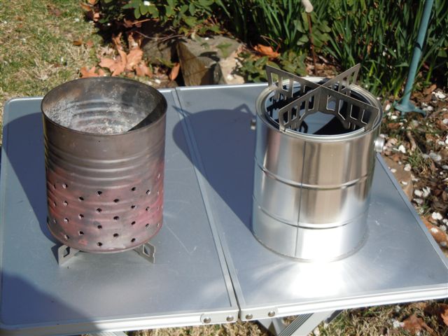

    The process is pretty much how I cook when I'm traveling and staying in either firewood or fire restricted campsites. Top-Lit Up-Draft (T-LUD) is the style of stove. Strategically punctured gallon paint can full of wood pellets (horse bedding) is enough to cook three or more meals plus popcorn if I snuff it right after cooking. Has produced enough heat to melt the bottom right off a set of Kelly Kettle aluminum pot stands. (They sent me stainless steel replacements)
    What's left after snuffing is mostly biochar with some unburned bits remaining on the bottom. I never really thought about it for the garden. Good stuff!

  5. DKR
    You now owe the board a photo set and instructions for said pint can stove...
    I would really like one if it works as you say....better than rocket stove.
    l’ll even add a pretty please
    If you want to send me some basic notes I’ll write it up after building one...
    SB21, oldawg and Zimmy like this.
  6. DKR
    I now have a new paint can - a full juice can and a #10 can.
    will build one like the one described earlier with a #10 can "afterburner"
    and one related ^^ with almost the same materials. Be fun to see which one burns cleaner
    Will need to drain the juice can and cut it and the other 2 cans. Hope to have something to shop before my weekend is out. Need to find my aviation snips to cut the metal...
    Should be fun and give me some biochar to get in the ground before a solid freeze.

  7. DKR
