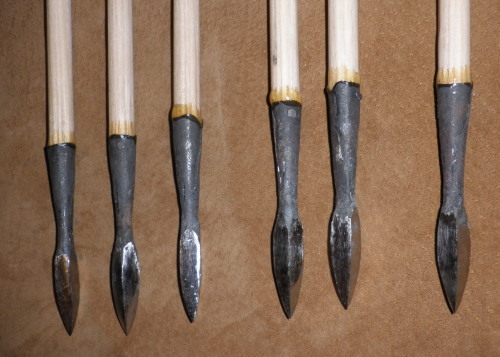

Making Broadhead Arrowheads From Target Arrows and Sheet Metal

    Very complicated and tool heavy way to make a broadhead, to my eyes. I'm sure that it will penetrate well, it's just complicated.
  5. kellory
    Looks good, but a few things to mention. First, The bigger the points, the more leverage on the wooden shaft, and the more likely to break. Also, the bigger the blade, the more air it catches, and the less accurate it really is. They will plane more. They will also change the end wieght of the arrow. I would recommend the blades be drilled to lessen both effects, and fly straighter.
    Second, I see no reason for the tang to be so short. Cut the wood and tang longer, and you can double rivot for a stronger, straighter connection point.
    Third, arrow tips for bear are tiny, not huge. (I know a bow/bear hunter personally) large blades will not make it through the hide and fat to do any real damage, and you'll just piss him off. You will be more likely to die than him. There is just too much drag on impact.
    So, I would make them smaller, longer tanged, drilled to lace to reduce wieght and leave a razor edge, if you are going for large game and can not buy what tips you need.
    (Comply with your local game laws, of course. ) But go minimal, not over large. Big blades are to maximize the hole size for faster bleed out. Small blades are for penetration.

    I currently like a 1"x1.5", without a tang. I've spent what I could spare over the past year trying different broadhead styles to find one that I can settle down on. Using trade points as examples. I want mine for both combat and hunting, and I have not found a production point yet that complies with that philosophy.

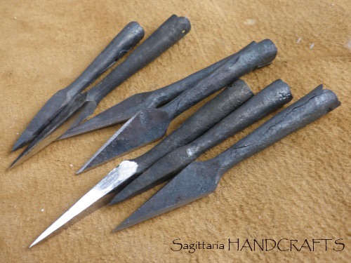

  7. kellory
    Take a hard look at war arrows. They were made to punch holes in leather and steel armor.
  8. AxesAreBetter
    AxesAreBetter Monkey+++
    Yeah, but I can't Hunt with them! I have actually done some tests with the head I have, and the ones I have made. I need to get those posted somewhere...
    With the bows I currently have operational (40 pound), there is no penetration gained on meat by switching to bodkins (NONE!!!), and only marginally better penetration on thing steel with the bodkin over the broadhead. AndI have several newer designs to test...
    I normally use a 32" 3/8" diameter poplar shaft carried loose in an arrowbag. They slide in and out without a problem, can be gotten to super fast (fastest method I've found), and they don't rattle excessively or fall out when running. Been running a Cherokee 2 feather fletch on mine, seems to shoot just where I want it to with very little paradox.
  9. kellory
    Granted. But that's because they were designed to penetrate armor not flesh. They were designed to go in hard and come out harder. They were designed to punch a hole, not Slice it. Different purpose entirely. One wounded man takes out at least three.
