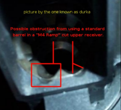

    Here is a great picture that shows the difference, shamelessly stolen from bigbore (thanks Steve).
    m4cuts0xk.
    As you can see, the feed ramps on the regular rifle barrel are cut just to the edge of the barrel extension... but do not extend beyond that edge; while the M4 ramps continue slightly "outside" of the barrel extension.
    As stated, the rest of a properly cut M4 feedramp is in the upper receiver... while the cut in the receiver is small, it matches up with the cut in the barrel extension and makes for a smooth, continuous ramp.
    installed5tq.

    My gun has an M4 barrel, but it looks like someone cut the ramps in the upper receiver with a dremel tool! That is most likely exactly what happened. There are a lot of uppers out there that do not have the cuts... hand cutting the upper receiver with a dremel is a quick way to make the conversion.
    Granted, it may not look so great, but odds are (if they are actually doing anything) they will work fine. The most obvious fault with this method is that the cuts are not refinished and you see bare aluminum -- while there may be some surface hardness that is not there... you will wear out a lot of other things on the gun before you have to worry about any problems with "wearing" on the hand cut ramps.
    If you are the kind of person that lays awake at night and obsesses over the dire thought that your feedramps were not refinished... well, hit one of the dealers on the site up for a new upper so you can relax. [​IMG]
    Can I run a M4 barrel in a regular upper receiver? Sure, there seems to be no issues with this... or you could just dremel in the receiver cuts. [​IMG]
    Can I use a regular barrel in an upper receiver with M4 cuts? I don't recommend it... there is a chance that the round can jam on the little "lip" that is caused by the barrel extension extending into the cut; however, there are guns out there that have this setup and work fine -- this tends to go towards the thought that the ramps really do very little? Again, it is not a setup that I would feel all warm and fuzzy about. Here is why...

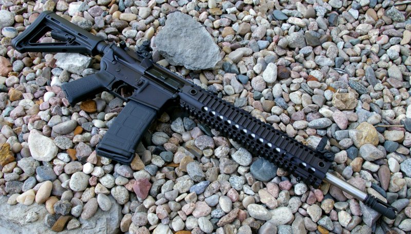

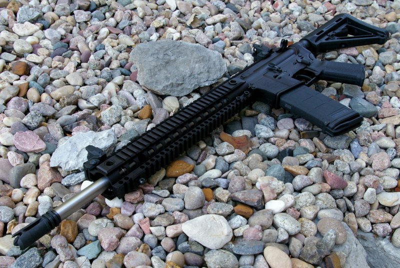

    From
    my perspective the Barnes Precision Machine BPM-15 AR-15 concentrates 100% of
    its price into everything you need in a high grade AR15 without the expensive
    “Tacticool” upgrades which net little in terms of accuracy or functionality. It
    is a rifle which is at the top of my list when someone wants a recommendation
    for a no-nonsense tack driver for patrol, sporting, and/or home defense
    use.
    My
    buddy and I proved that this BPM-15 was up to the task of medium range target
    engagement by delivering reliable hits on the 500 yard gong from prone position
    with only an Eotech 512 and Atlas bipod attached. If you are exterminating
    little rodents, I would definitely slip on a higher power optic to take full
    advantage of the BPM-15's half-MOA accuracy.

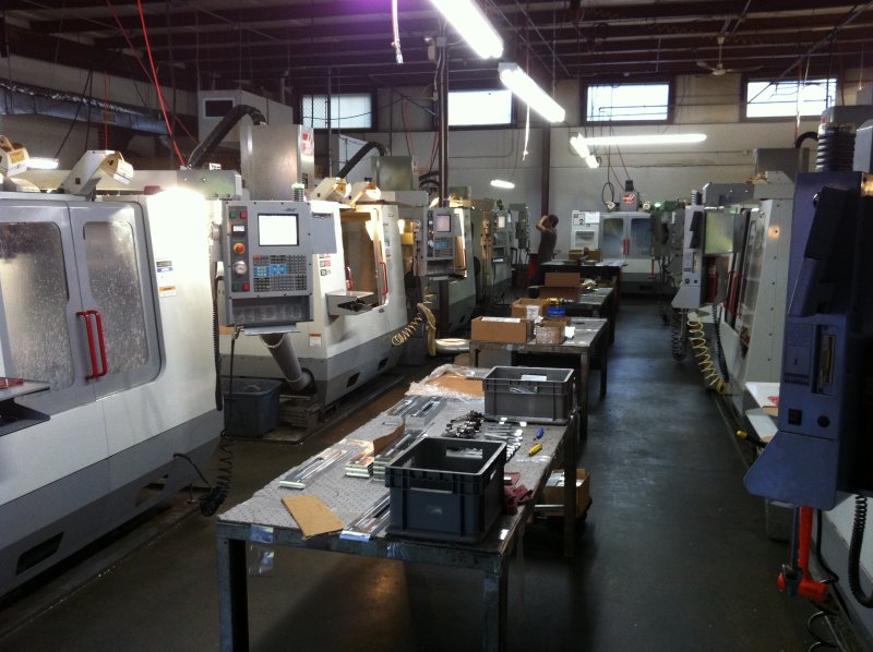

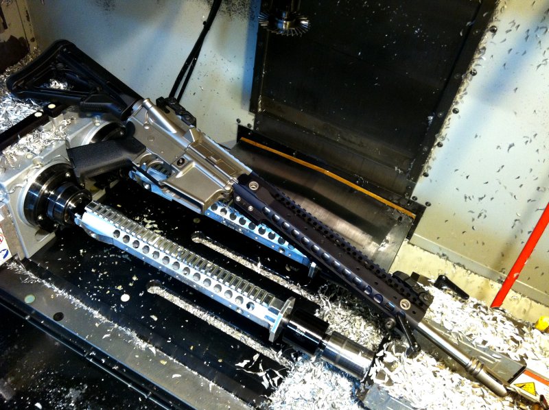

    Here
    is the deal; almost all AR manufacturers buy their finished ready-to-assemble
    parts from a very limited number of real manufacturers in the industry. This
    means in almost all cases, everyone sources their super-special super-duper
    rifle component(s) from the same as everyone else. This is because the machinery
    and know-how are tough to come by, expensive, and some cases proprietary which
    make it more cost effective to buy the components.

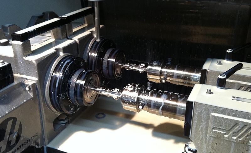

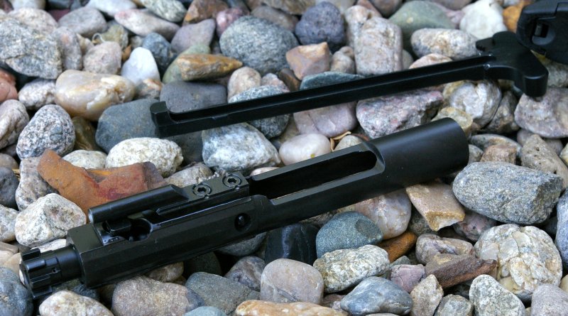

    BPM turning a set of bolts.
    Is
    this a horrible thing? No, however it does limit the control a manufacturer has
    on the quality, originality, refinements, and origin of the parts... small parts
    for example are pretty tough to regulate where they come from. For those
    companies who do manufacturer parts on site, they tend to have a pretty
    significant edge on quality.
    BPM Bolts ready for initial phase 1 inspection.

    Due
    to the production capabilities of the business, BPM has the capacity and tooling
    to machine all the little intricate parts most companies purchase such as
    detents, pivot/take-down pins, and all the BCG (Bolt Carrier Group) components
    with the exception of the carrier; though Barnes will bring production of the
    carriers in house by the end of the year.
    Although
    Barnes purchases roll pins, buffer tube plates, buffer assemblies, and springs,
    it is one of only four MPI tested AR bolt and extractor manufacturers in the
    world.
    Barnes Precision has a little over twenty CNC machines
    including Swiss CNC machines each dedicated to high volume production of certain
    AR parts. This prevents having to tear-down and reset the machine for another
    milling operation and greatly increases efficiency and speed.

    One of the many cubed rows of CNC machines at BPM.
    At
    4PM I arrived and was promptly buzzed into the secure building by one of the
    machinist and lead in between a vast line of busy CNC machines and piles of raw
    materials to a huge, but rather meagerly equipped office where I was greeted by
    the office staff. I was asked to sit tight while Andrew finished up another
    meeting. About 15 minutes later, I was lead into the BPM assembly room where
    parts were being assembled into rifles and a group of Special Operations tagged
    folks were inspecting some of the newer designs and models.

    Imgp4096.
    Above - Original Quadrail with new UltraLite Rail
    As
    tested, the 100% USA made rifle was still a very competitively priced at $1221
    and about $100-$200 less than any comparable model I could find. Of note Barnes
    only charges about $200 extra for the Nickel Boron coated model which has all of
    the components excluding the barrel and forend NiBo coated; not a bad deal for a
    rifle that is essentially corrosion proof. Originally I picked up the rifle with
    the Heavy Quad Rail, however since I have swapped it to a 14" UltraLite
    BPM forend.

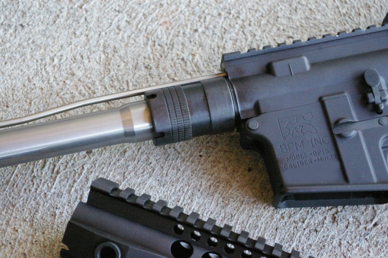

    Imgp4097.
    Note the length of the supporting barrel nut.

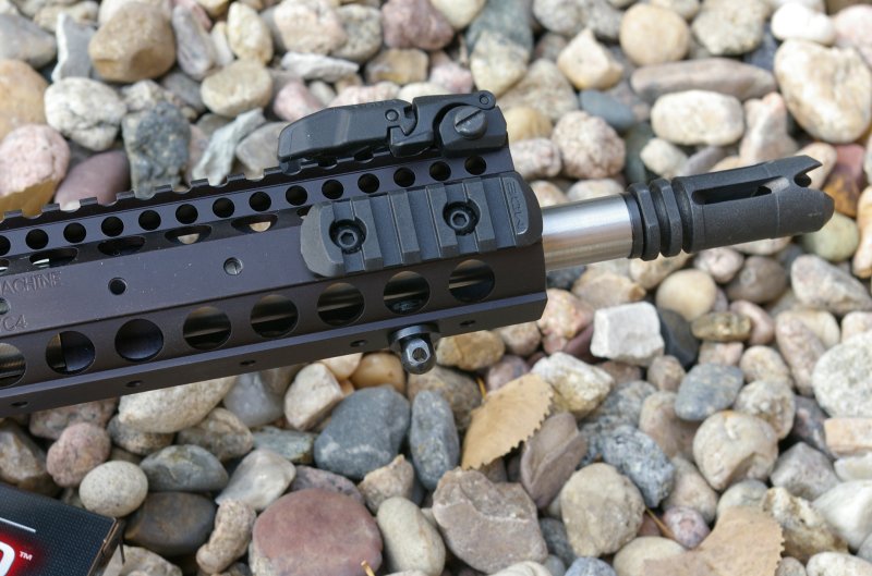

    Imgp4115.
    The
    new forend also has a number of unique features including being the only free
    float forends which readily accept Magpul MOE picatinny rails. Barnes is also
    one of the few Master Distributors for Magpul. This is a perfect union between
    the companies and allows for less expensive, lighter, more hand friendly Magpul
    rails to be used on the forend. Yes, finally someone has a standardized forend
    rail option.
    Imgp4117.
    New UltraLite BPM Rail accepts Magpul Rails

    As
    noted previously the match grade barrel blanks are bored, button rifled, hand
    lapped and polished by Montana Rifleman. BPM contours to a weight reducing
    profile and machines the barrels to concentricity to the bore and finishes each
    end with threading and final crowning. They then use a match .223 Wylde reamer
    to cut the chamber.
    Moving
    down the barrel, BPM also makes the crush washers and flash hiders in house.
    The design is unique and effective as a zero dust signature A2 style flash
    hider with prongs for bolt, wire, lock breaching. Some refer to this style flash
    hider as a universal lock pick which I will need to test at some
    point.
    Although
    the lower receiver may appear standard, there are a few refinements. The BPM
    features a captured spring for the rear take-town pin which is a nice touch for
    a part that seems to get lost a lot. The other feature included in the Barnes
    lower receiver is an “accurizing” set screw. This screw allows the user to
    tension the upper and lower for a very tight fit even after the upper and lower
    receivers begin to wear and loosen. Out of the box, the Barnes was pretty tight
    however I gave the set screw a twist just to put a bit of tension on the take
    down pin and really lock the receivers together. Barnes does not broach the
    magwell for square corners. His valid point was that no magazine has square
    corners and by removing more metal from the receiver your are making it weaker.
    Barnes has also designed the magwell to assure Magpul magazines drop free each
    and every time.

    also makes a low profile gas block and take-down/pivot pins, however it is the
    bolt which deserves special attention. There are only four AR bolt and
    extractor manufacturers in the world and Barnes Precision Machine is one of
    them. It is without a doubt the most challenging part to make on the AR and the
    most critical. If the bolt is not correct, the gun will not function
    correctly.
    BPM
    adds a little refinement which is unique. Instead of peening the under- side of
    the bolt to prevent incorrect cam pin assembly, they simply machine and
    precision short stroke ream the hole which increases strength and cam pin
    alignment. Oddly enough the extractor is even more difficult to produce.
    Currently in addition to its own bolts, BPM supplies phosphated, nickel boron,
    and chrome plated bolts to some of the top AR names in the business which are in
    turn using those bolts to fulfill military
    contracts.
