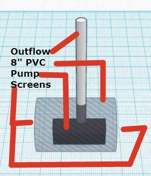

    No. 8" PVC cut in 12" section. Lie on side. Drill hole through top. Insert pump into pipe. Run outflow pipe through hole in 8" pipe to pump inside. Cover open ends of 8" PVC with nylon window screen. Take a coupling, cut in half, then slip over ends and edges of screen to hold into place. Ends could be easily cleaned off and debris wouldn't have the chance to suck into the pump. Would need to drill another hole for the power line and then silicone the gaps so it wouldn't allow for more junk to suck in.
    Did this real fast on Tinker CAD.

  5. I get your meaning. However, flat screens always have the ability to get clogged, especially by broad, flat leaves, though your idea does make it easy to clean. Perhaps try making a 3D screen like this one.
    It prevents clogging by allowing liquid to flow through slits all throughout the cylinder. Easy to make out of pvc of any size, almost impossible to clog.

    Mimosa leaves aren't broad. They're like a grain of rice that got steam rolled. They go right through those slits.
