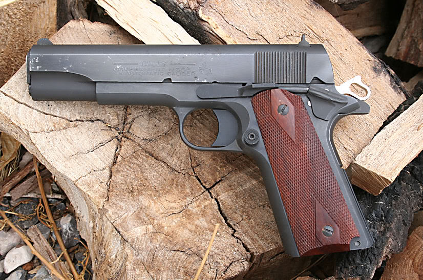

    Here's the left side, where the slide was rusty. I'll send it in for re-blueing once I'm done fixing it up.

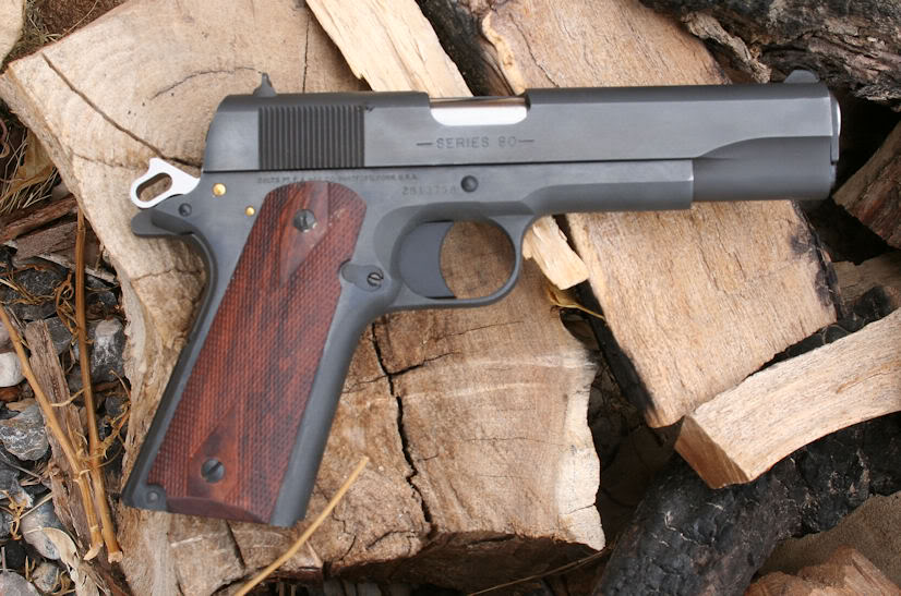

    Here's the right side and you can see the ends of the hammer and sear pins are gold colored and give the gun a "pimpy" look LOL. These parts were coated to reduce trigger pull and it worked as the drop-in trigger parts were set for 4.5# and the trigger pull is 3.8#.

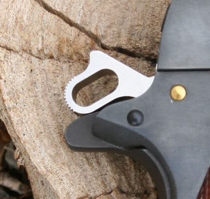

    The new hammer hits the grip safety when cocked so I've already ordered a Wilson "Drop-In" Beavertail GS. Will take more pics when I have it installed!

    I have a big problem as I finally realized this slide wasn't cycling all the way back - seems the hammer hitting the grip safety is holding it up high enough to stop the slide from cycling. I have a beavertail coming and that should solve it.

  16. ghrit
    ghrit Ambulatory anachronism Administrator Founding Member
    If you are getting the beaver tail anyway, just file a groove in the tail that will clear the hammer for you. I think I see that the hammer is actually holding the gs in. Not good ---

  18. Valkman
    ghrit, you're right - I'm going to go file that GS down until the hammer has clearance.
    ETA - Done. Put a new 60 grit drum on the dremel and ground the grip safety until it got too hot to hold, then ran water on it and tried it in the gun. Over and over. Now the slide clears the hammer, cycles fully and the hammer isn't pushing the GS in.

  19. Valkman
    Well with the "ground down" grip safety the gun worked fine, but with the new "Drop In" beavertail I have problems. Technically it does function - it keeps the gun from firing until pressed but it made the trigger pull 10lbs! It also does not reset correctly and I do not know what to do. I may need pro help now!
