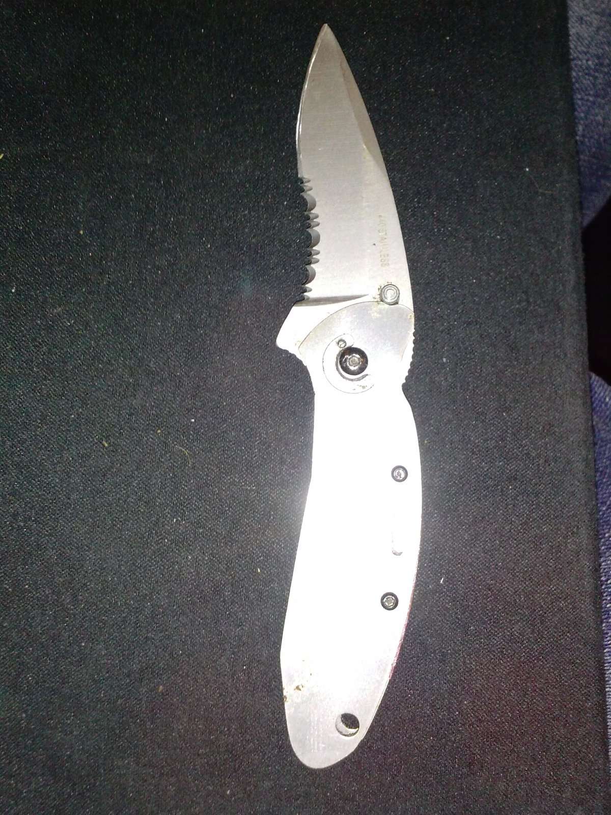

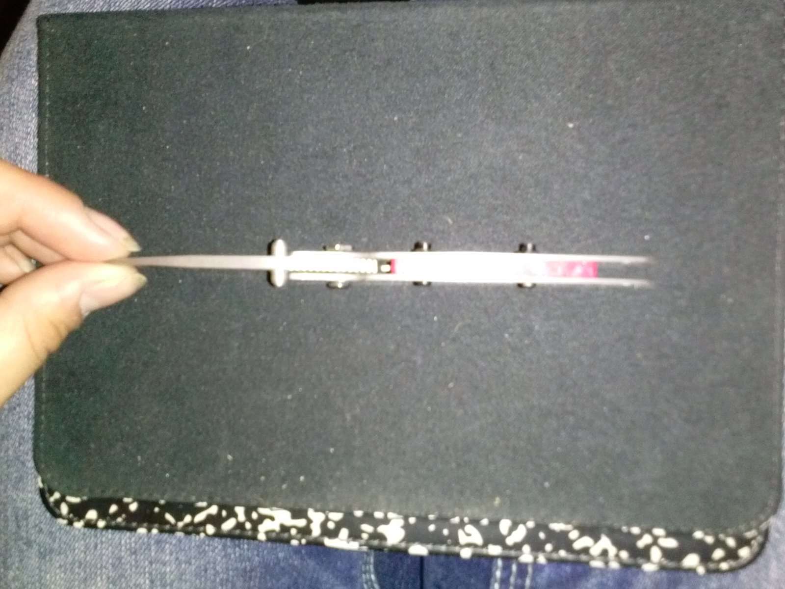

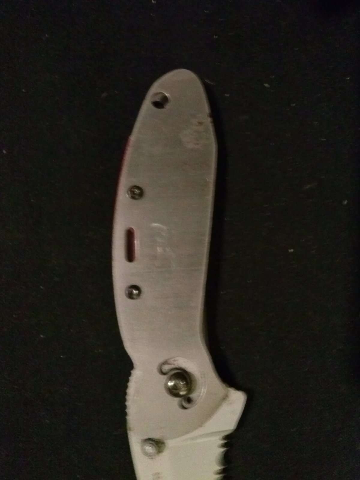

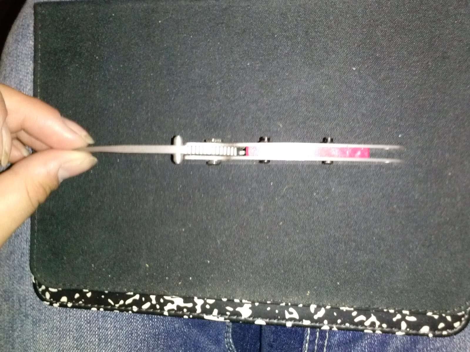

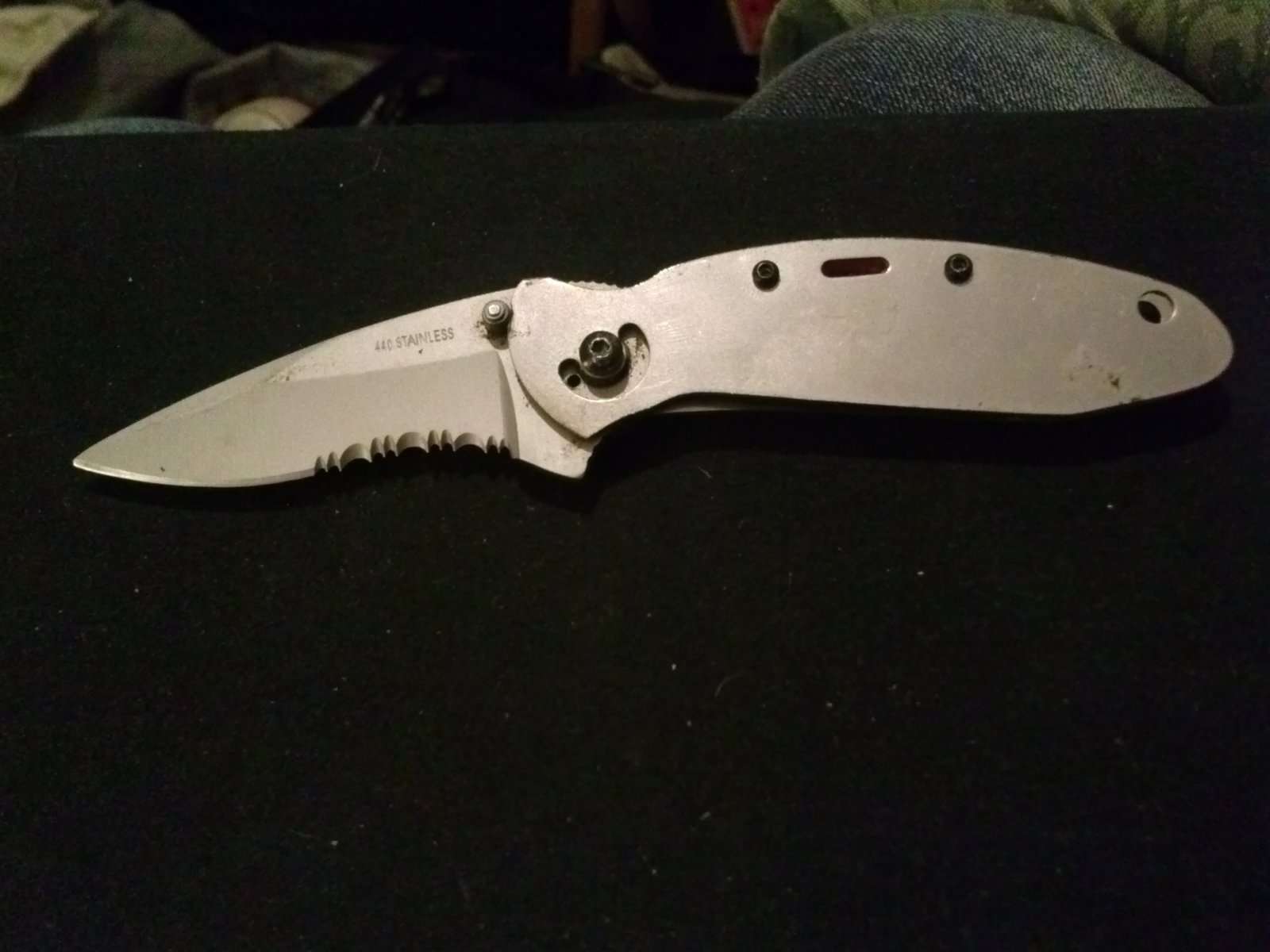

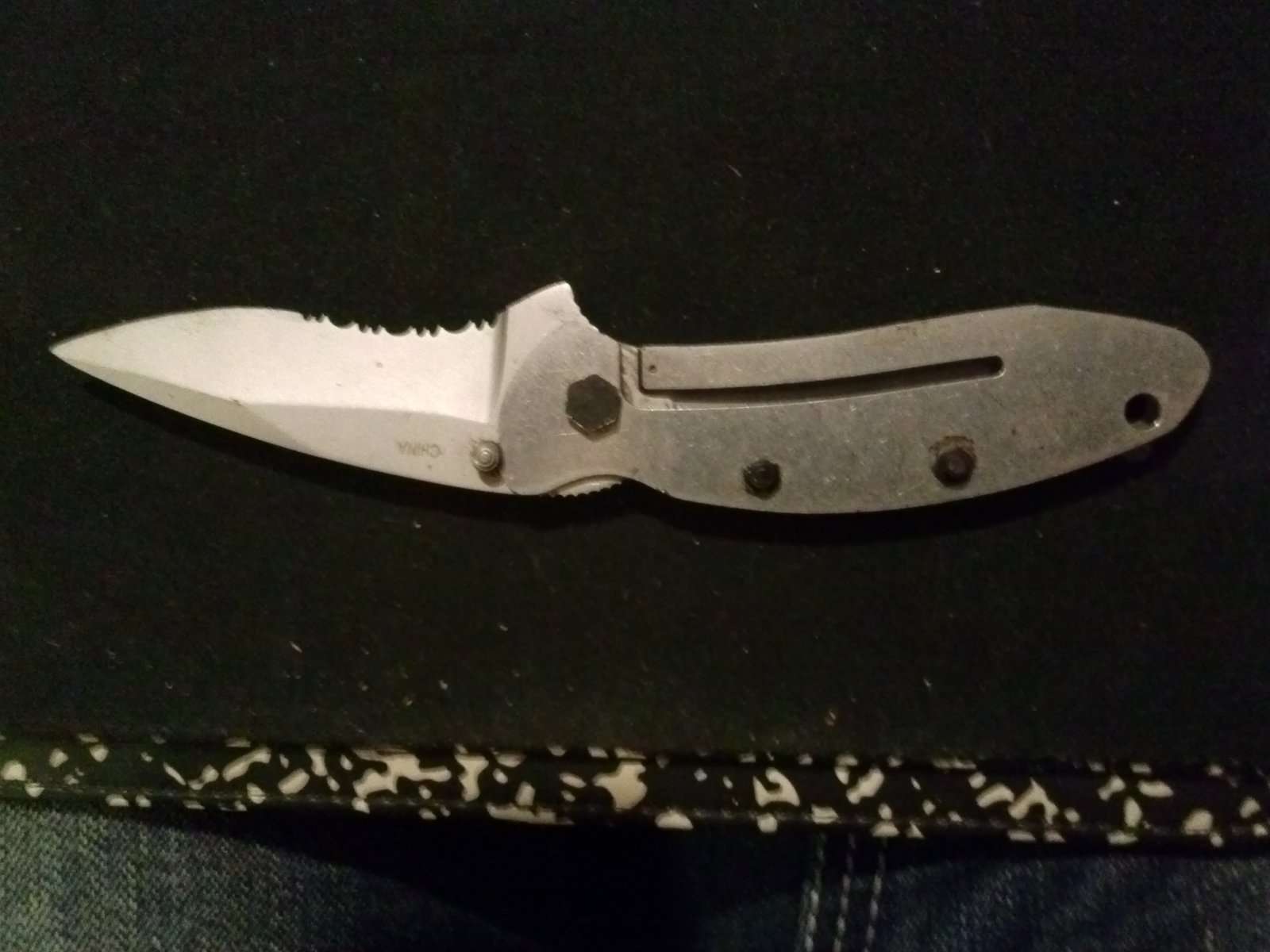

  7. cbig
    cbig Monkey

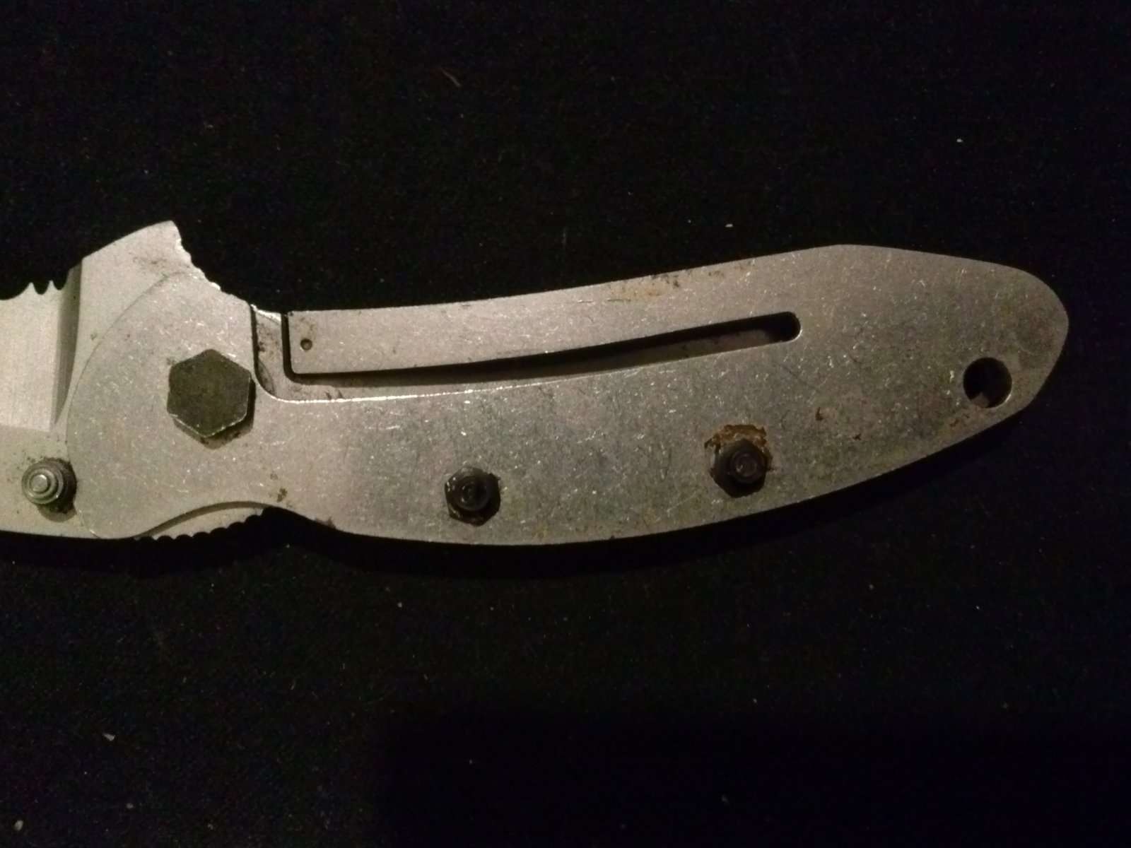

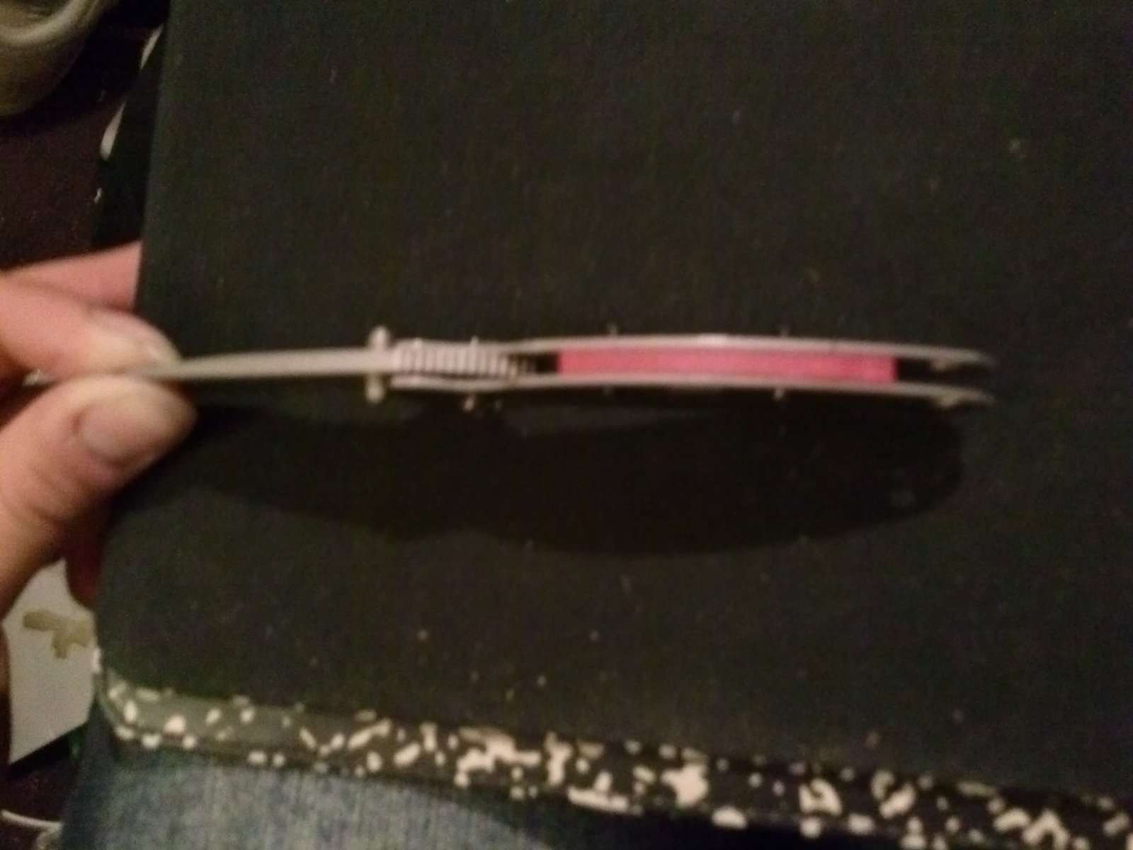

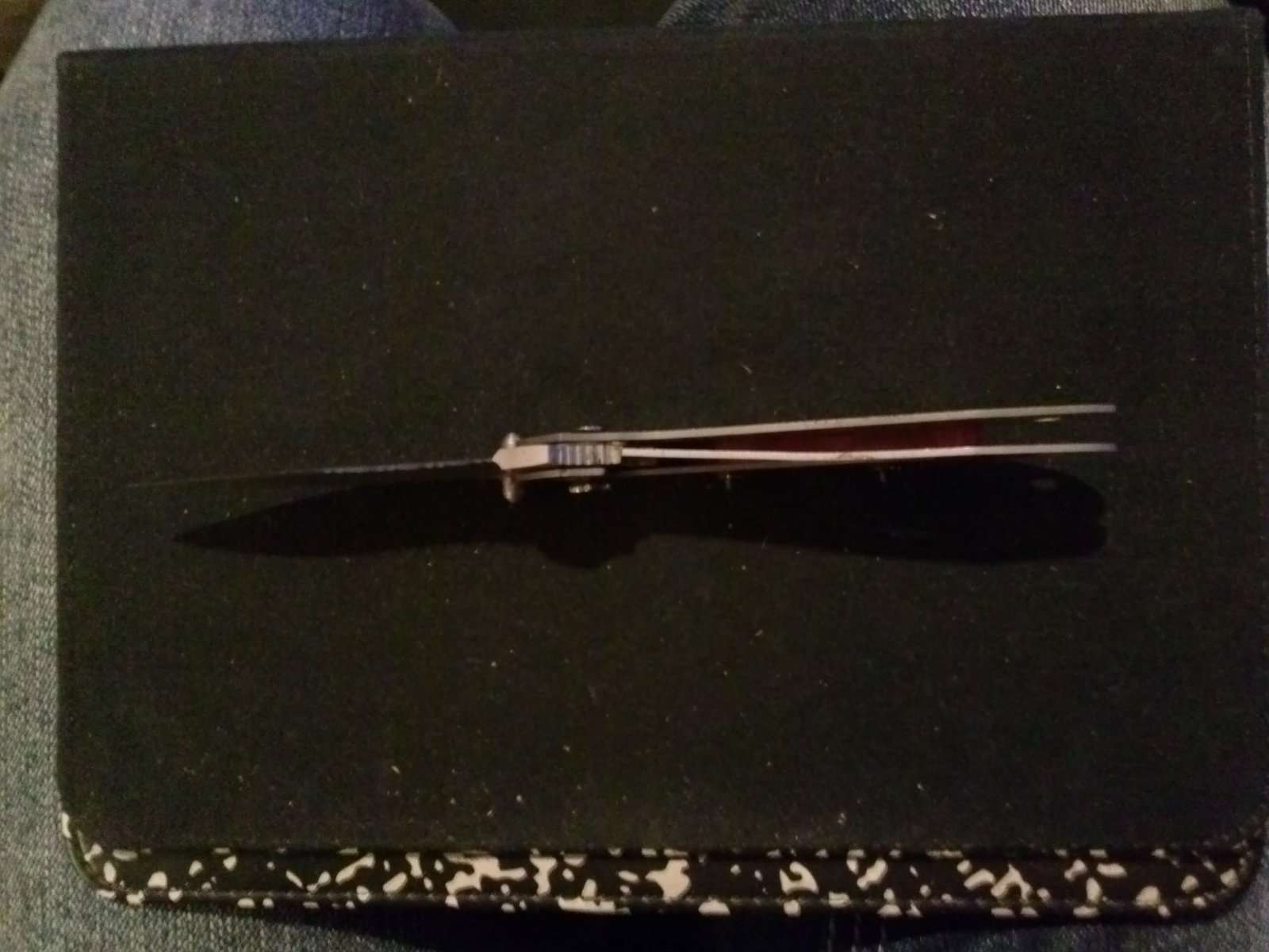

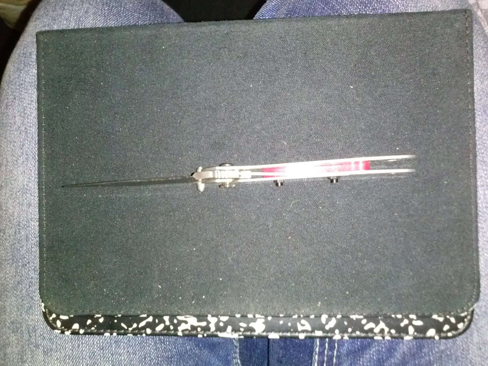

    As. Requested pics of knife without plastic grip that broke.off,. Fhere are screw.holding it togegher but i left.the plastic part in between the the pieces where the knkfe would fall into otherwise the screws are too loose. [​IMG][​IMG][​IMG][​IMG][​IMG][​IMG][​IMG][​IMG][​IMG][​IMG][​IMG][​IMG][​IMG]
    [worthless][/QUOTE]
  8. Brokor
    @cbig Thanks for the pictures. You have yourself a frame lock. I wouldn't advise trying to wrap the handle with paracord. The reason is because 2/3rds of the right side needs to be free so the locking bar can flex as is needed to lock and release. Also, if you do try to use paracord, it would need to be stripped (inner taken out) and you will have to avoid most of the locking bar area. Perhaps finding another method to make a suitable handle will suffice?
    Ganado and chelloveck like this.
  9. chelloveck
    Thanks for the pictures...better folk than I here may be able to help you out, now that we can see what we are dealing with. Paracord doesn't seem to be a workable solution. The loose screws are probably loose, because they were relying on the grip as a spacer to grip to. That will be one issue to factor into the crafting of new grips. Wood or horn are probably going to be the easier options for crafting with: plastic or aluminium moulding may be viable options too, but a bit fiddly, and requires some skillsets and equipment that will take some effort to acquire.
