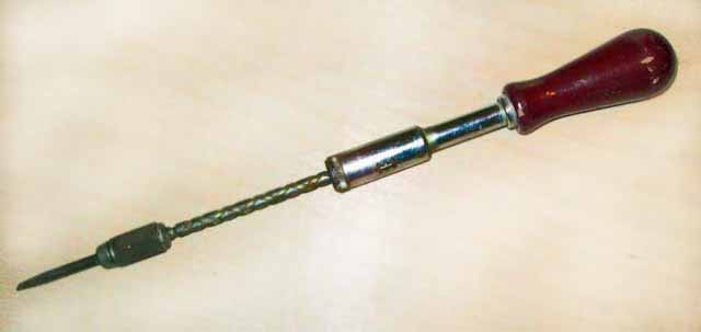

    Yankee push drill or ratcheting drill. Yankee Push Drill is stamped on the side of my husbands 1976 drill from General Telephone (verizone now)

    Not bad, but not quite right. They are similar tools, but different function. Made along the same line, and many of the bit will interchange. This version is known as a "Yankee" screwdriver, and they came in a couple of sizes. They both turn by pushing on a helix, but if I recall correctly, the drill bits were fluted to cut in both directions. They are essentially, the same tool, but with different bits. I have seen after-market later versions, that had both types of bits in a hollow handle.
    If you have the tool handy. The patent number should be right there with the model number. I will dig out mine, and we can compare models if you like.

    kellory, the handle says Made By Stanley
    Yankee
    Part # 03-043
    Made in USA
    MY Dad had the brown handle kind. Wish I still had that one.
    Thanks kellory!

    Yes, that was a later competitor version. I will dig mine out for closer comparison.;)
