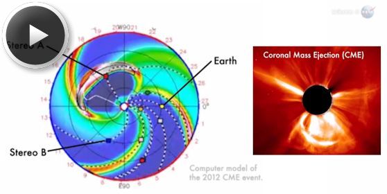

    Baker, along with colleagues from NASA and other universities, published a seminal study of the storm in the December 2013 issue of the journal Space Weather. Their paper, entitled "A major solar eruptive event in July 2012," describes how a powerful coronal mass ejection (CME) tore through Earth orbit on July 23, 2012. Fortunately Earth wasn't there. Instead, the storm cloud hit the STEREO-A spacecraft.
    "I have come away from our recent studies more convinced than ever that Earth and its inhabitants were incredibly fortunate that the 2012 eruption happened when it did," says Baker. "If the eruption had occurred only one week earlier, Earth would have been in the line of fire.

    The reason researchers know so much about the July 2012 storm is because, out of all the spacecraft in the solar system it could have hit, it did hit a solar observatory. STEREO-A is almost ideally equipped to measure the parameters of such an event.
    "The rich data set obtained by STEREO far exceeded the relatively meagre observations that Carrington was able to make in the 19th century," notes Riley. "Thanks to STEREO-A we know a lot of about the magnetic structure of the CME, the kind of shock waves and energetic particles it produced, and perhaps most importantly of all, the number of CMEs that preceded it."
    It turns out that the active region responsible for producing the July 2012 storm didn't launch just one CME into space, but many. Some of those CMEs "plowed the road" for the superstorm.
    A paperin the March 2014 edition of Nature Communications by UC Berkeley space physicist Janet G. Luhmann and former postdoc Ying D. Liu describes the process: The July 23rd CME was actually two CMEs separated by only 10 to 15 minutes. This double-CME traveled through a region of space that had been cleared out by yet another CME four days earlier. As a result, the storm clouds were not decelerated as much as usual by their transit through the interplanetary medium.
