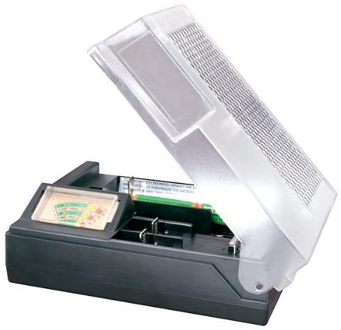

    For AA/AAA/etc batteries, consider a small unit designed especially for that. Crane makes one I like, includes a strength meter so you can turn the panel to optimum charging position. $25 at Amazon. Others have USB charging ports. Shop around.
    sec_monkey likes this.
