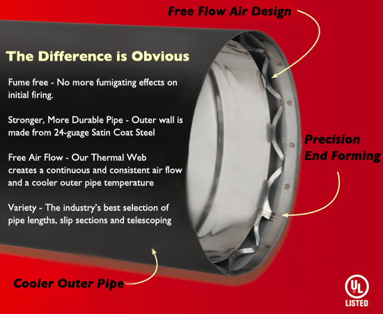

    Double wall smoke pipe?? I do not think that was in the pictures I attached. I don't have terminology down but can get the concept. Can you define a bit more. Thanks!

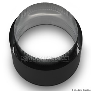

  6. sec_monkey
    and a better image [​IMG]

    Double wall smoke pipe is (like it says) a pipe within a pipe, with insulation in the annulus. (Triple is better, but there is a return on investment question. If wood is your primary heat, it's better. If wood is backup, well, not so much advantage.) MUCH more efficient, and retains heat such that creosote doesn't collect as readily. If the smoke cools to below (say) 300F on the way up the stack, you'll get a creosote deposit that will not make you happy when it catches fire. (Yes, I know this --). I don't use my wood stove for primary heat, but annually I put fire in the stove to debug, dry out, and debirds and bats nests if any found their way in. Highly recommended, the moreso if you don't have a cap on the stack with bird screens on it. (Bird screen will also act as a spark arrestor, a good thing if you have dry woods around the house.)

    The "Thru-Wall" pict (Post #1) shows "DuraPlus Chimney" and I believe this is Dual Wall Pipe... Also one NOTE here: At the bottom of the External to the House Pipe, just below the Horizontal Feed, that comes out thru the Wall, there needs to be a Removable Section. this allows for the Brush to be used on the the chimney, from the top, and all the Sweepings to fall out the Bottom of the Vertical Section, and into a Bag, while doing the Yearly Brushing. Many installers forget this, and if they Brush the Vertical Section, all the Brushings, just pile up below the Feed, and can cause a Stack FIRE, if left there.
