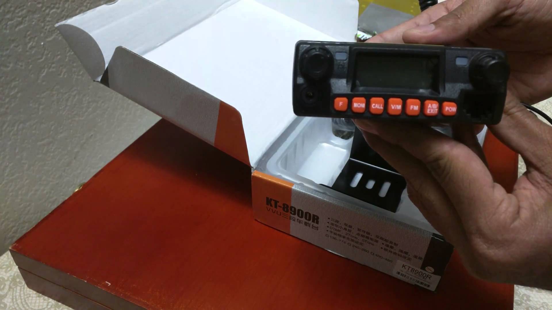

    We picked up one QYT KT8900R tri-band about 3 months back worked so well picked up a second one.
    One in outbuilding 2 the other in my wives car.
    The speced power is actually accurate 25/20 good simplex and hits repeaters 40 miles away.

    Picked up a UV898 10 watt radio for solar power station.... Good for rural but front end too wide for city. Picks up data burst from utility watt meter as an image on 450 mhz. Programs well with CHIRP software with a few gotchas you will need to figure out as you go. Not a good scanner but good to monitor one freq with very low power drain even with LEDs on. Portable operation would be very good as a battery run setup.
    Might look at the triband QYT KT8900R next.

    Had mine since back in the spring. Basically a mobile Baofeng, and if you have programmed one of those this will be very familiar. For the money, very decent radio.

    GoodNESS that is a tiny little thing. If the measurements are in MM from the Amazon site, that thing is:
    W - 3.85"
    L - 1.37"
    D - 4.64"
    (just found the inch measurements at 3.9x1.4x4.7...so yeah, 'bout right)
    And 25W/20W to boot. And it runs off the lighter so no hard wiring...hmmm. I may have to look at that for Christmas.
    Looking up info on eHam but does anyone know what type of antenna connector it has?
    ***ETA***
    Radio has an SO-239 connector which uses, as @BTPost mentions below, a PL-259 connector on the antenna cable.

    Takes a PL-259 Connection.....

    The radio antenna connection is an SO 239. So far as power from the lighter socket goes, I'd be doing some checking at the fuse size, some are only 5A which is NOT enough for full power. (If it is adjustable, you will be good to go. Maybe.) If you have a power point other than the lighter, there's a pretty good chance it'll be plenty (mine is 20A.) There will be a fuse in the lighter plug supplied with the radio, make sure it is equal or lower rated than the accessory fuse.
