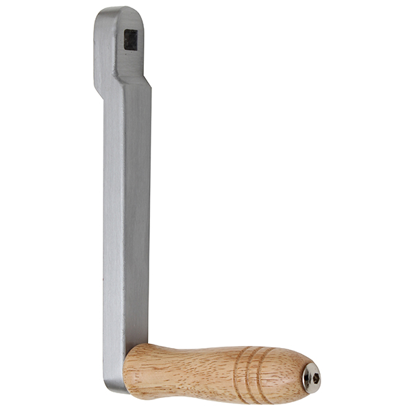

    - Crank length and crank/handle materials used.
    The crank is really a lever. The longer the crank length, the less effort needed to run the mill.

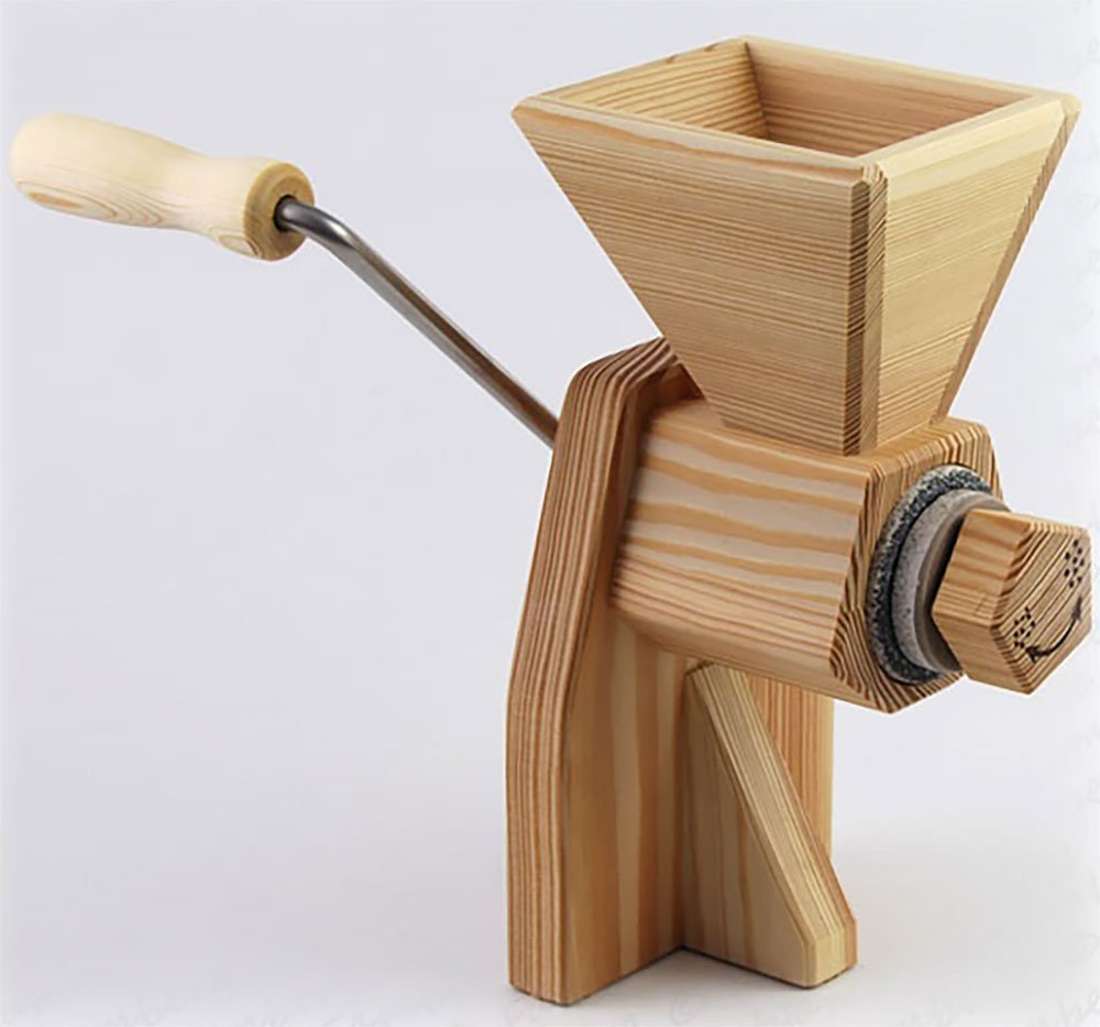

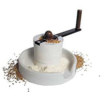

    Novelty mills - yes, they are out there. Here are a few.
    [​IMG] [​IMG] [​IMG]
    real old-school, eh?
    not a toy, their ads say so. Note there is not way to attach to a fixed object.
    Last novelty item
    yes. So you can run your hand crank mill with an electric hand drill.
    Please don't.
    "There's a sucker born every minute" said P. T. Barnum never.
    Thee are a lot of these 'novelty' mills on the market, and if you just want to grind a few handfuls of wheat with the kiddo to make 'your very own great-grandma' special bread, good-o.
    They are rarely easy to use, not very productive for the effort and all will wind up on the shelf next to your own Thighmaster.... It is your money, and you can do as you please. I posted these so you can at least be aware of some of the more fringe products - this you so can inform a friend on value vs cool factor...

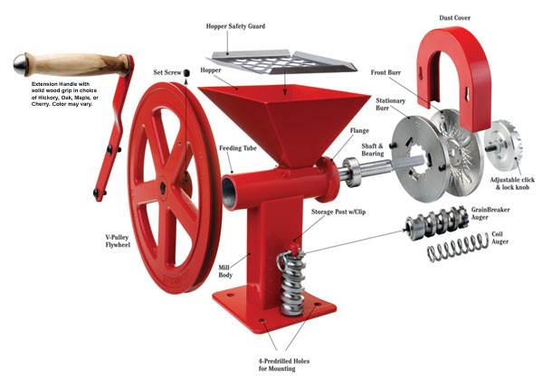

    I'm not a fan of machines that use a handle attached to a pulley to power a mill. Not even a little.
    However, a crank and pulley combo, can be a great choice.

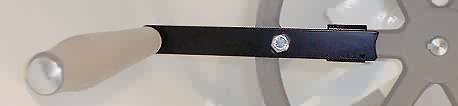

    see-
    you can use the crank only, the pulley only or both. Good! The crank attaches to the pulley in two places. Better yet.
    Another take
    Not too bad, it has two attachment point - BUT, you can't use the crank alone. So - no.

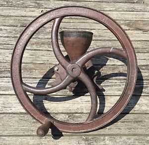

    Old-school, wheel and crank. This one works for me - mostly as it is made from cast iron. Also note the massive size of the wheel (crank length).
    Fun stuff - eh?

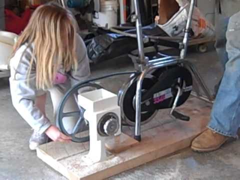

    So, you have a hand crank mill and now you want to power it. Yes, you can use a low-RPM motor, or matched large/small pulleys.
    Or, you can do this - pedal power!
    upcycle old bicycle parts. Your imagination is the only limit.

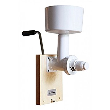

    So, you want to buy a bolt down framed mill. Except you're not ready to drill the kitchen table - right now. What to do?
    Buy or make an adapter
    Now that you have seen this done... Go make your own. Normally these are purchased from the vendor to ensure the frame mount holes match. You can measure and make you rown - or have to local machine shop work one up.
