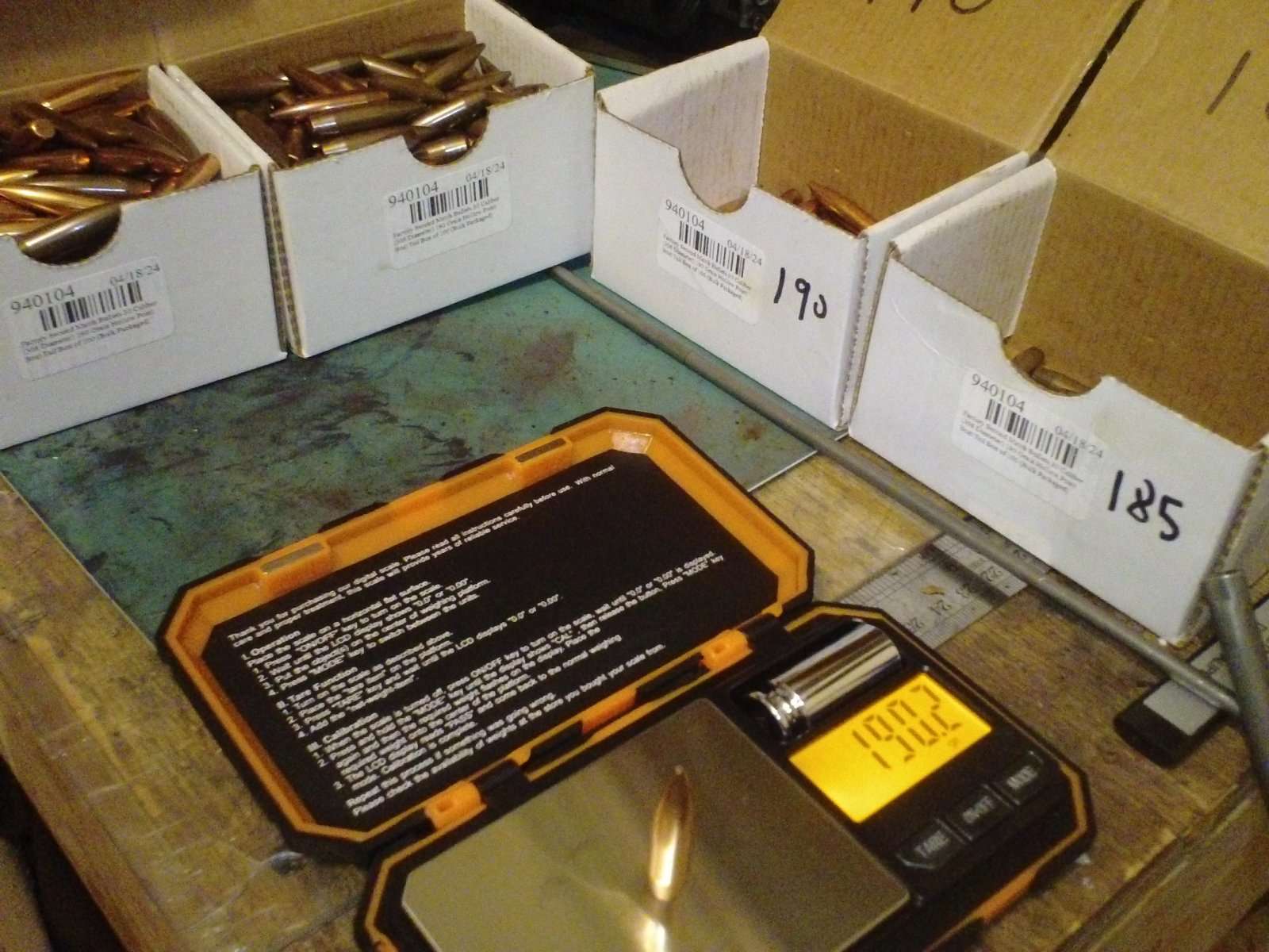

    BIGGER and HEAVY = more grains. The scale below is set to measure in this way.
    I sometimes buy bulk match bullets that are seconds for range shooting, and I weigh every one of them and sort accordingly. This batch came in 185 and 190 grain and I had to sort them. For my more accurate loads, I will use premium match quality bullets that are all within spec.

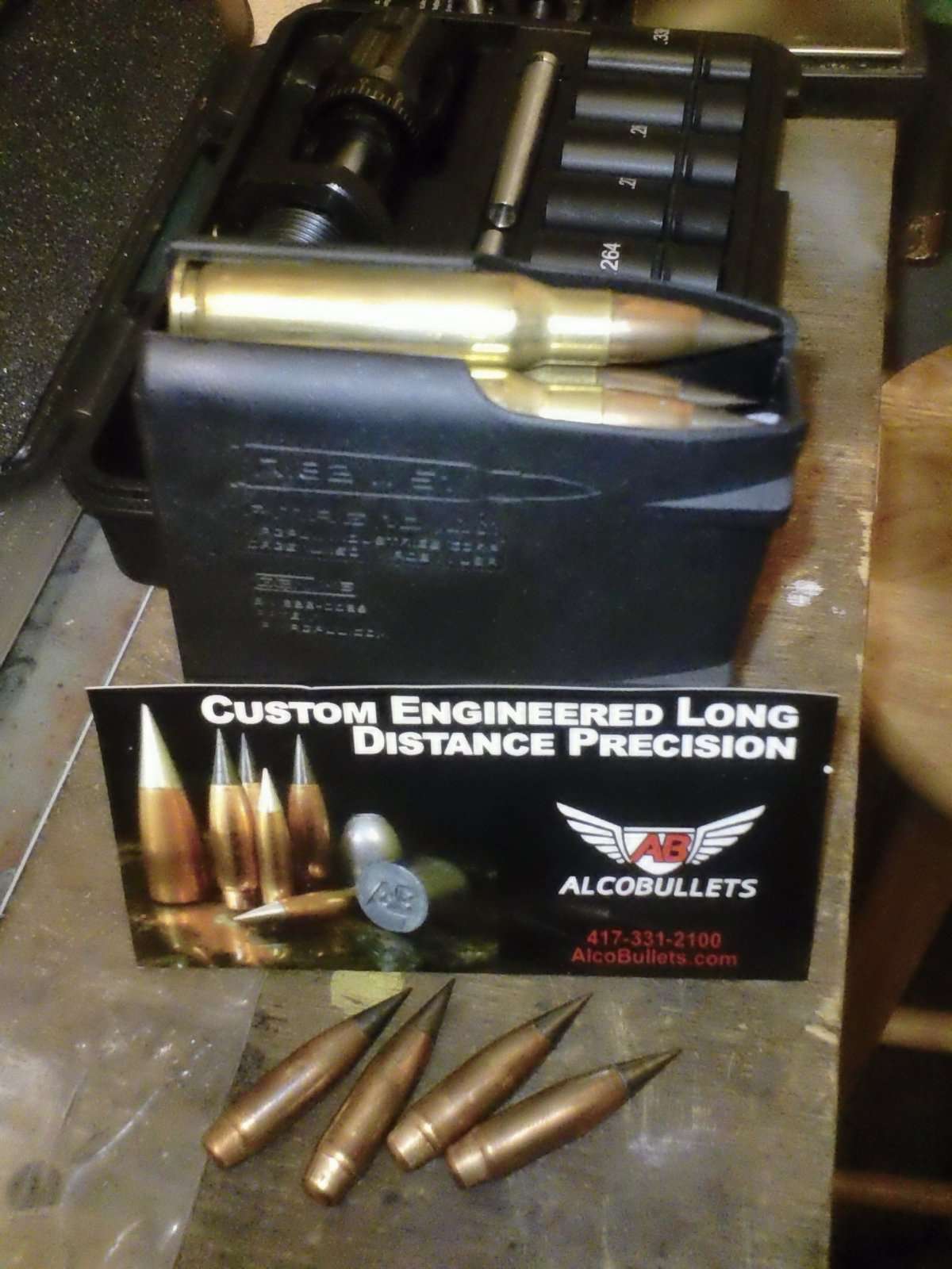

    The size and weight of every bullet is important to know when reloading so you use the correct amount of powder. Too much and it goes boom in the wrong way, too little and it goes pop and doesn't give you the velocity you require. That's the dumbed down version. A reloading manual is an essential component to have for reloading and it will list the powder type and charge for every bullet with maximum and minimum amounts clearly defined for safe operation.
    Precision is important. Your ballistic coefficient is always a factor in accuracy. Think of it this way -a heavier object requires more energy to propel it...but you're using the same size case. More bullet lead equals less space which means more pressure, so the charge (powder) must be carefully calibrated for every bullet. There's some wiggle room with seating so you can seat a bullet deeper or more shallow, every manual will tell you the overall dimensions for a fully loaded round. But bear in mind, the whole premise relies upon all the laws of physics in order to safely control accuracy. Do not play around with reloading if you don't know what you're doing.
    From a simple average user's perspective who purchases premade ammunition only, heavier gr. bullets offer you more lead to make a bigger hole. A lighter grain bullet can travel at a higher velocity but will impact with less energy because there's less mass. Although not entirely true...that is the basic way of viewing it. Every bullet will have parameters that will determine various flight characteristics.

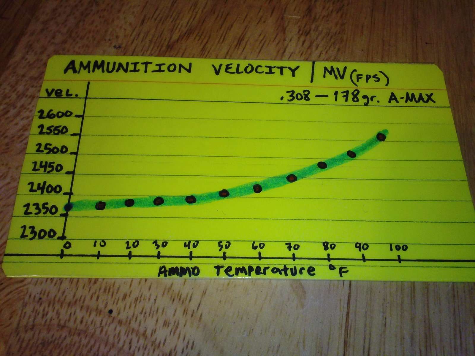

    temp_ammo.JPG And temperature has an effect on velocity, too.
