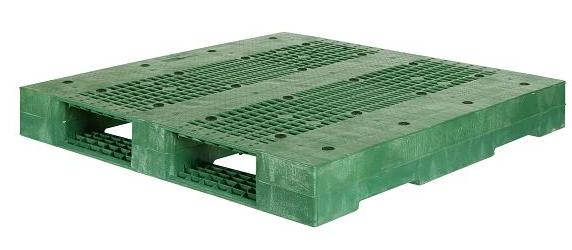

Adding some insulation might improve comfort if using it as emergency accommodation; and it may reduce your feed costs somewhat, if using it as a chicken coop. Adding some guttering and down piping will help in harvesting water for a water butt or water tank. I am in the process of planning to do the same thing, but am looking to do it as a prefabricated modular kit that can be transported disassembled; erected on site with non-powered tools ; and when necessary, disassembled (*with non-powered and transported to alternative locations as required. Using hardwood pallets: Advantages; They make for a more solid, sturdier construction, Their strength enable them to withstand greater weight loadings, More termite resistant than soft wood pallets; Have a longer service life than softwood pallets; Disadvantages; Heavier to move, Harder to construct with, using non-powered hand tools, May need heavier duty fixings and other kinds of reinforcement. Using softwood pallets ; much the same as the opposite of hardwood pallets Consider using a combination of hardwood and softwood pallets in your construction as best suits their respective advantages. Consider plastic pallets as an option. Definitely termite proof! Won't rot, (though may become brittle if not UV resistant), no probs with rising damp, Plastic Pallets as foundation? Repurposing plastic pallets Edit: As your AO seems to experience winter snowfall, you'll need a fairly steeply pitched roof to slough off any accumulated snow.

@bmysliwiec we would love to see the progress. I have never built one, but as @chelloveck posted above, I think that plastic pallets (at least for the floor) would keep moisture, rot, and termites away longer. If you have drawn up any plans, scan them and post them here! Thanks, and good luck.
