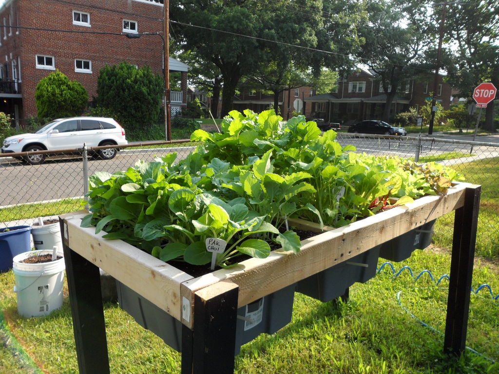

I had the wood rot issue also. I think I should have lined the beds with something. It idea of using tubs is ugly but a great idea. I think you could grow tomatoes in them also. It would be heavy so solid legs are a must. Self-Watering Veggie Table

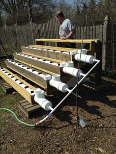

self-watering grow buckets Self Watering Alaska Grow Buckets video - DIY version - Pic of the self-watering part smaller version on a shelf. Not my backyard, just up up road a ways - but this is what my hoop house looks like in the winter... a variation of this would work, just do a short pyramid (two or three on a side) adjust height as desired.
