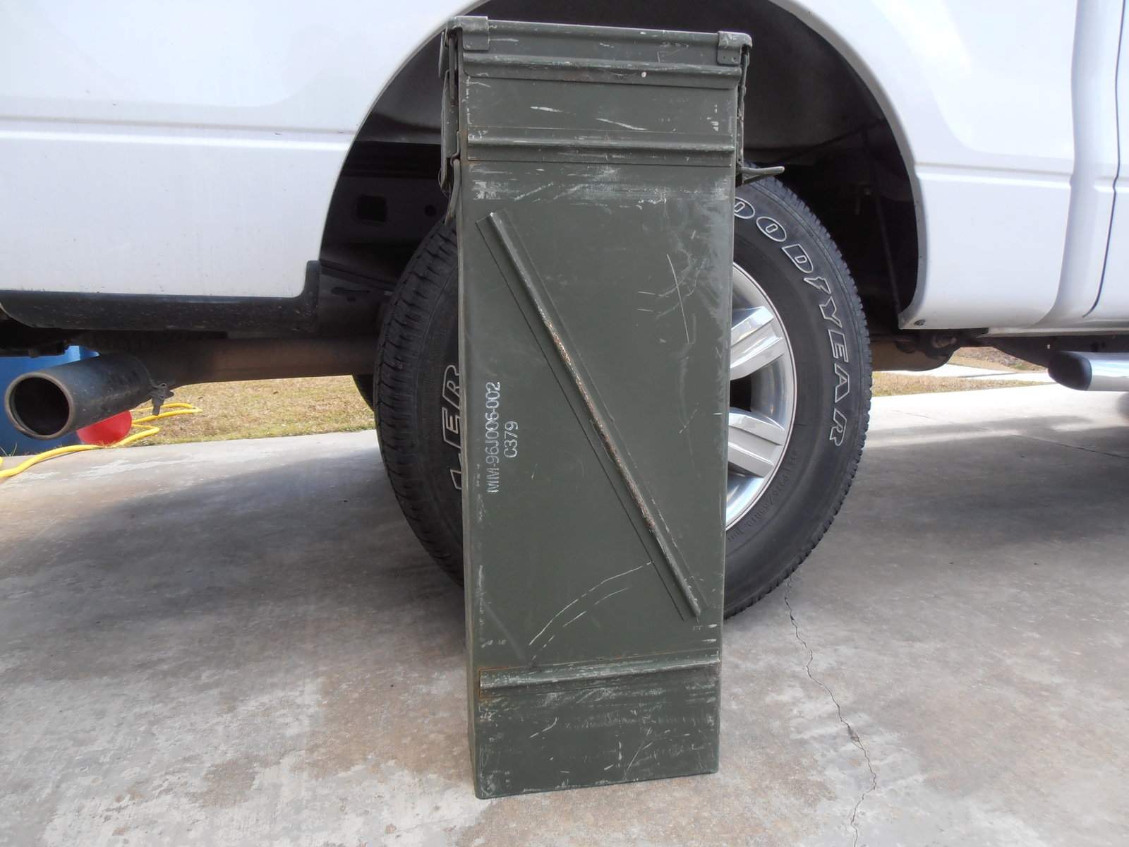

    How and what would you use or what's the best product for pickling one of these cans?
    Pretty much looking for suggestions to make this hardened to the elements like rain and dirt.
    Thanks.

    I have a couple of ammo cans i have sprayed painted and they have held up well outside for several years now
  3. ghrit
    Phosphoric acid dip and flush, thoro drying and paint with something like carbozinc 11.

  4. kellory

  5. Airtime
    Airtime Monkey+++
    One of the best things you could do is sand blast the can to bare metal and then coat with a commercial 2 part epoxy such as Rust-o-leum 9100 series coating. These type coatings are used on the inside of water tanks (like city drinking water tanks) and if properly applied and cured, they can handle chlorinated water, which is quite corrosive as the chlorine outgasses. 15+ years in water tanks is pretty common for a good application. But commercial epoxies are hard to get and in small quantities. If you can find a crew painting a water tank somewhere and bring them a blasted and ready can, a couple 20s might get it coated for you.
    Some polyurethanes are pretty good, especially the thicker Rhino type coatings, surface preperation and proper temperatures and humidy during the cure are critical. I've been inside water tanks coated with urethanes that were impressive and have seen some coated with tars and they sometimes are terrible. Tar is seldom used anymore for tanks and for reason. The tar is either still gooey and gets on everything or often gets brittle over time and cracks with temperature extremes due to expansion and contraction. Water ingresses thru the cracks to the metal below and oxidizes it. Same problem often occurs in 15+- years when tar is used on basement walls to moisture proof it and eventually the basement may develop leaks. Just my experience inspecting water tanks off and on over 16 years.

  6. vonslob
    vonslob Monkey++
    I would be careful putting a heavy coating of polyurethane, too much and the can will not close correctly. I put several coats of paint on an ammo can and had problems closing it. My experience for what it is worth

  8. Homer Simpson
    Homer Simpson Monkey++
    Maybe fill and seal the can, then spray it with a few coats of rubberized undercoating from the auto parts store.

    I use ghrits' method. Products such as Ospho and a cold zinc paint are available in smaller quantities at most hardware stores. The next ones will be finished after filling and sealing with a bed liner product, can be had at most hardware or automotive stores by the quart,around any place where metals meet.
  11. KAS
    KAS Monkey++
    i would suggest enrust {follow the directions} and then prime and paint ...
    or have it galvanized...
    The is also some new product out that they are using in the oilfield to stop corision .. i forget the name but H.I.S sells it in new iberia
  12. Gator 45/70
    Thanks' I passed that way the other day, I plan on doing several in different coatings to see what holds up well.
    I have one coated both inside and out with the rubberized undercoating as suggested above.
    I have a friend that does the cerakote thing, May pay him a visit soon.
