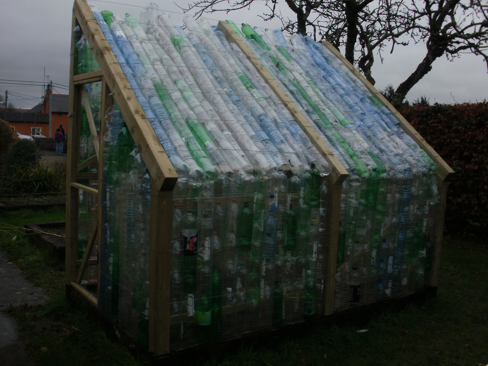

    Saw a thread on Facebook, followed it to a link, and viola! A new use for plastic 2 liter bottles!
    My plastic bottle greenhouse

    Looks good and has the added feature of insulating the grow area with dead air space.

    That's what I thought. I live in the city, so getting plastic bottles is not a problem. I find myself wondering, though, if it would work just as well (or almost) with smaller bottles, like the 16.5 oz water bottles you see everywhere in California.

    Stack the bottles with the necks up. This does a few things, it gives you a flat base for the first set and it prevents rain from running into the bottles. It also allows your top row to be flat by reversing your last row of bottles and to trim your last/top row. This then allows you to make a top beam of wood and concrete and allows anchor bolts to be placed in the concrete and make a stronger frame/top tie down to the roof.

    I did kind of wonder why he put the necks down. Necks up seemed to be a better idea. Always room for improvement. Still not sure if I'm going to do it, but I've seen bottle houses made of glass bottles cemented together, so it caught my attention.
  9. Tracy
    I bet it's neck down because that's the way they fit together better. Weight distribution, gravity. Neck up may require a different support structure (like HKU suggested).

    From the text of the article
    "After that it was just a case of slotting in the stacks of bottles (tops downwards so that any water would drain out the bottom of the bottles) digging the bottom of each stack slightly into the soil, and using this to give a bit of leeway in the height of the stacks, and having an uncut bottle at the top of each stack."
    The bottom of each bottle is cut off and the neck of the next one pushed into the bottle. All water and condensation drains out. Last row uses a complete bottle.

    Still seems to be the wrong way around to me, and I did read that. I may do some experimenting myself.
