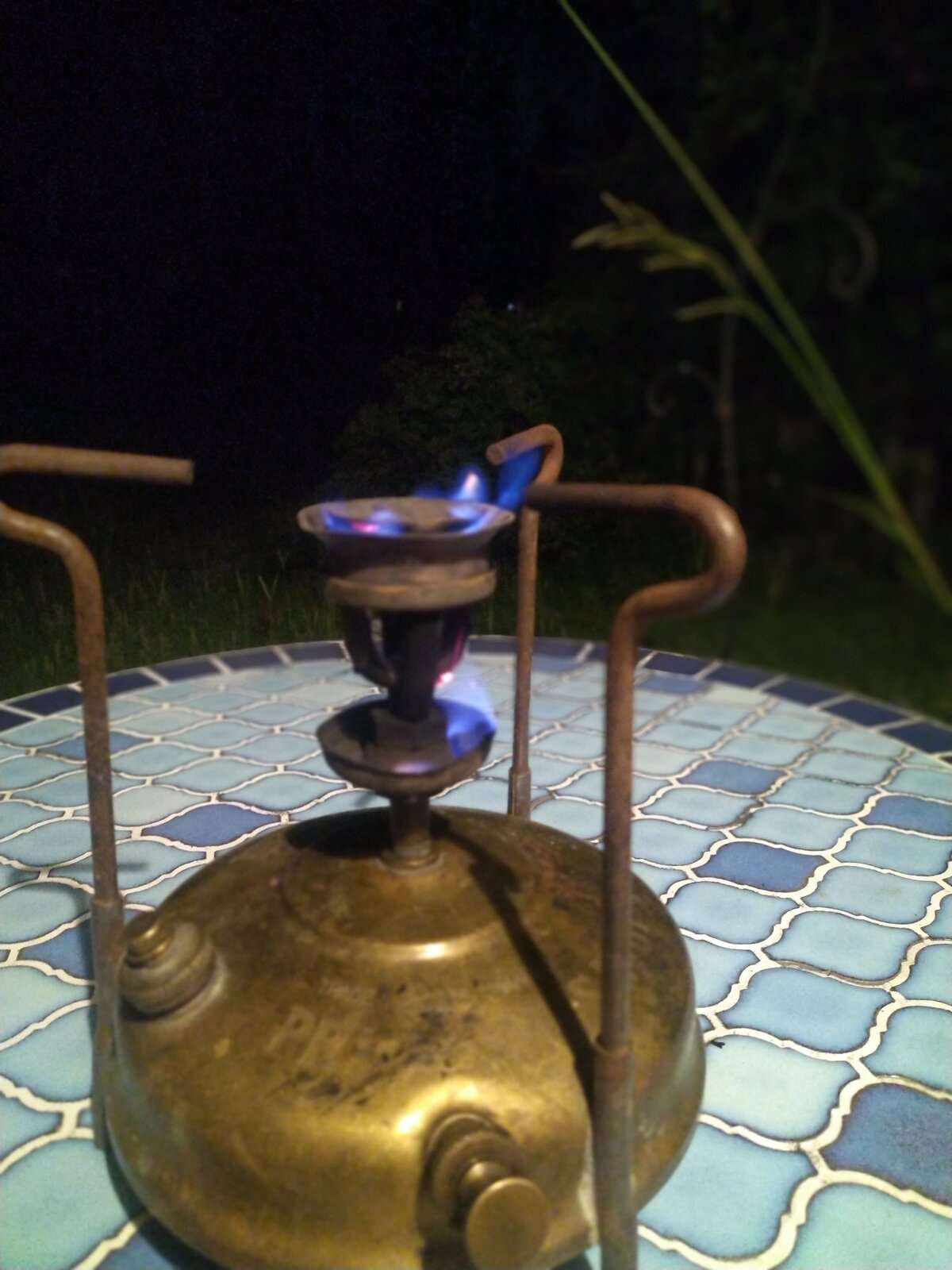

    Primus stoves were made on Sweden as far back as 1911. You might run across one cheap at a yard sale. Grab it! They are fantastic stoves and require little maintenance.

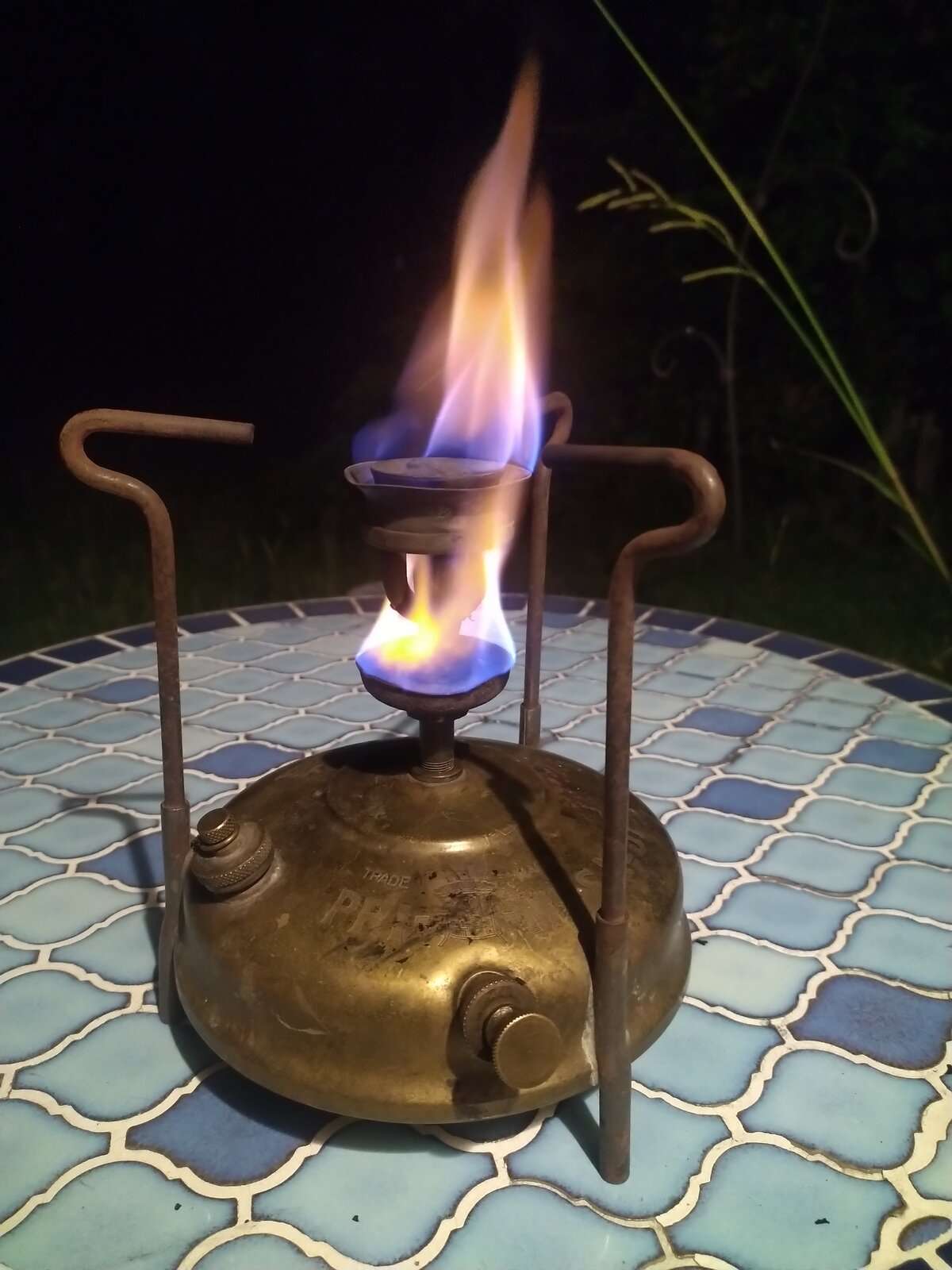

    Fueled with kerosene and with the pre-heat cup filled with denatured alcohol.
    IMG_20230619_215948.
    IMG_20230619_215846.

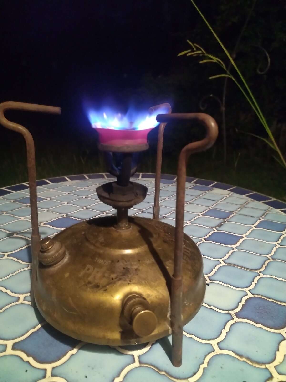

    We start with no pressure and add one to two pumps as the alcohol burns off. IMG_20230619_220026.
    then we can add pressure to make the burner roar.

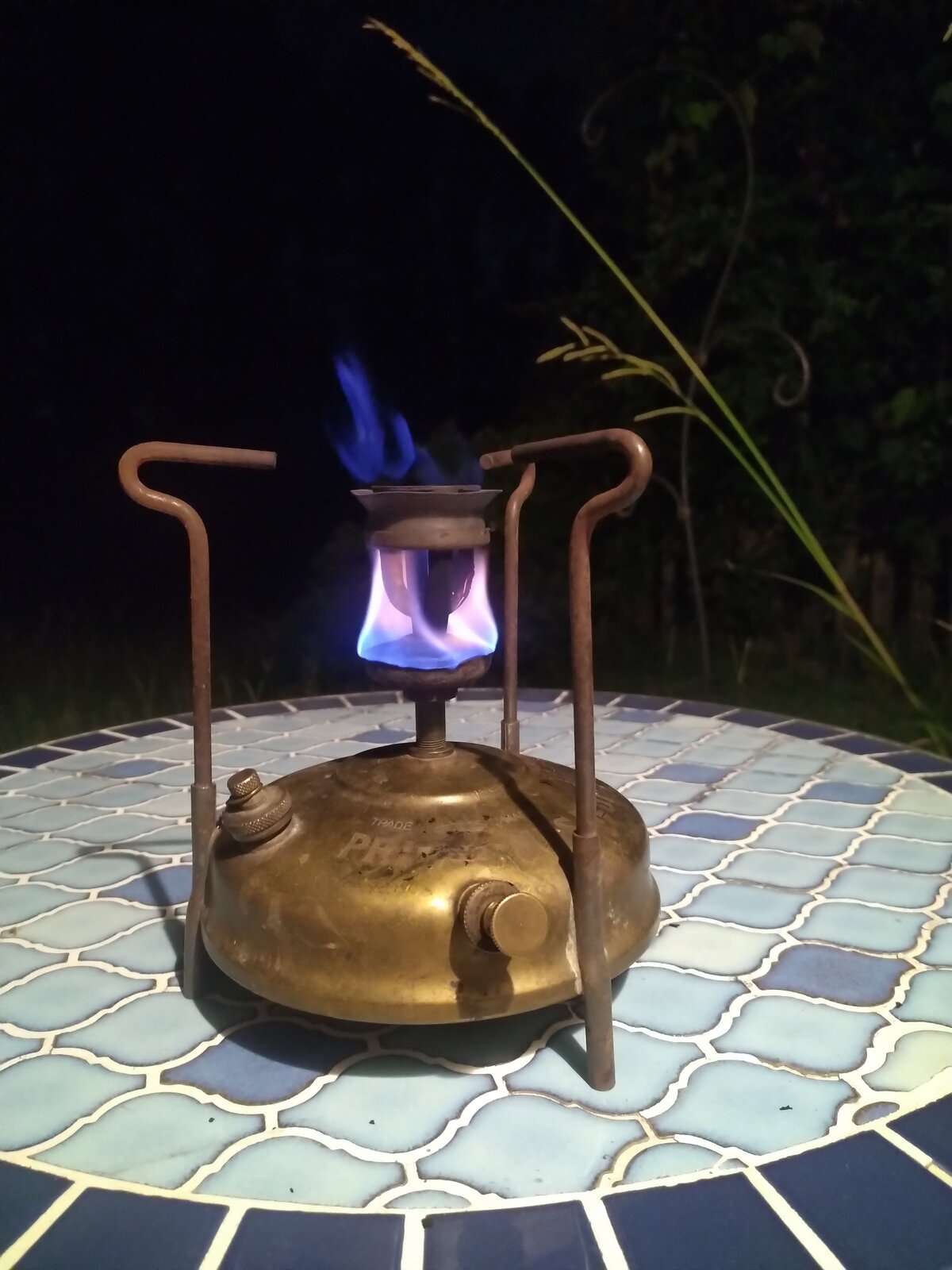

    IMG_20230619_220052.
    If we want to simmer we just release pressure. Want more heat, add pressure by pumping.
    To shut off, just open the valve. Fastest extinguishing stove I have.
    This one is a 1937 No. 51. They're all basically the same. I ran three year old kerosene tonight. I have some pre-Y2K kerosene in the barn that I'll test after I burn this off. I suspect it'll run just fine.
    Can I preheat with kerosene? Yes. I did just that tonight. It created some carbon scale that burned off once the stove got hot. Slight smoke preheating this way. Nothing that can't be overcome.
