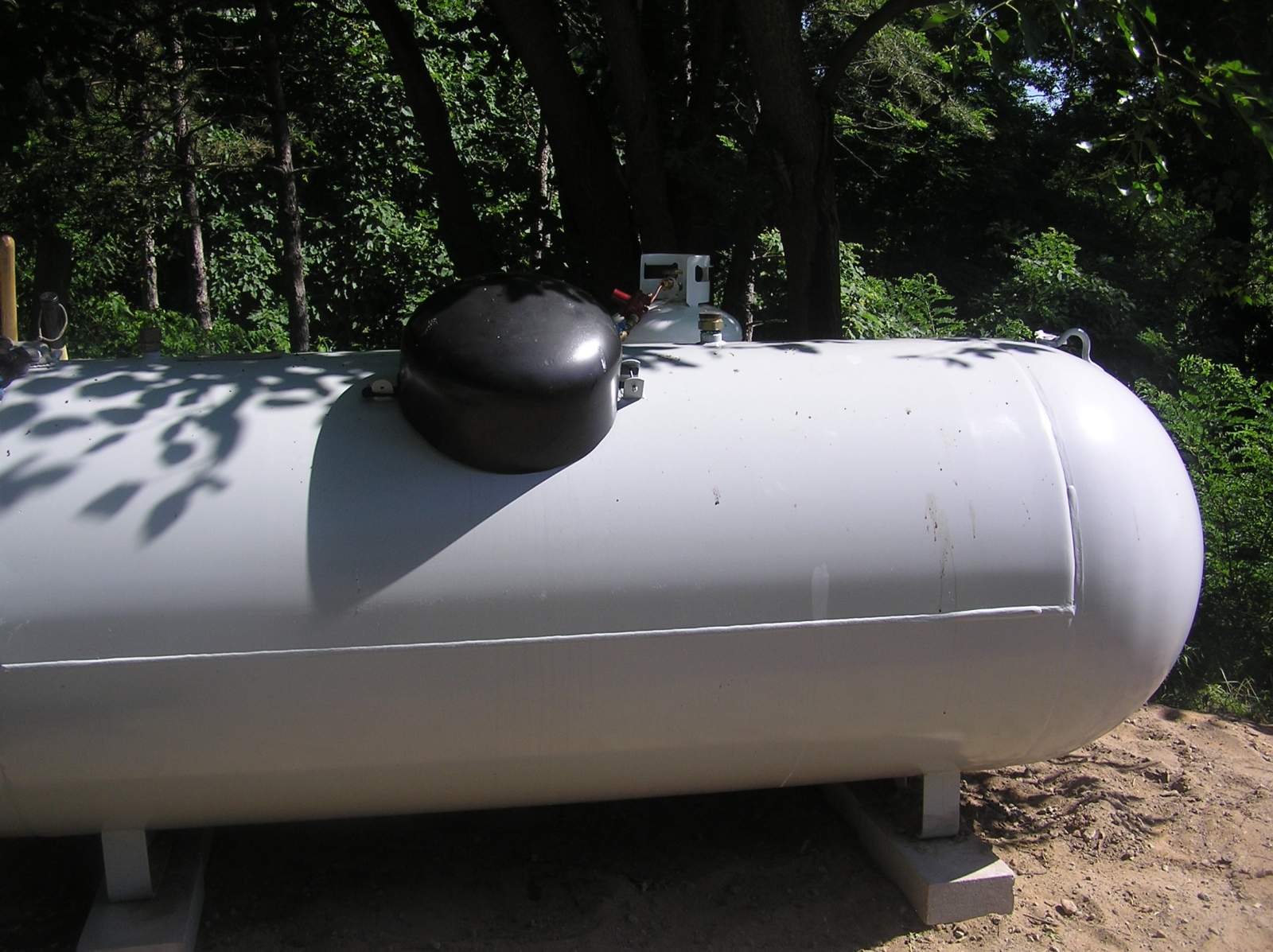

  9. Kingfish
    Kingfish Self Reliant
    here is my propane tank with the tee. Note the 100 pound cylinder behind the big tank. I have a shut off there on that leg. The 100 also has its own regulator as well. It makes using 20,40 and 100 pound tanks a breeze. In my plan a 100 pound tank (23.5 gallons) will last me 52 weeks running the genny for 1/2 hour per week. I only use the 8 k Generac for pumping water once per week and some limited power tool use. I am building a battery bank, inverter and charging system for my 120 volt needs for long term. This gives me 1/2 hour per week of 8,000 watts of 240 volt power. I can go almost 20 years on the propane I have now. If I buy another 500 gallon tank I can use it for one hour per week for 20 years. It goes fast if you run your genny 24/7 . Pump and store water, run your tools during the same time frame. Rationing propane will be a must as will lamp oil, candles, wood , food, and water.

  12. kellory
    I like what you have already set up, but when I see those large propane tanks, I keep thinking what a bomb they would make from such a small piece of lead.
    If it were mine, I think it would be inside concrete walls.

  15. Kingfish
    We are going to build a treated wood fence around the tanks to hide them but everyone's tanks are above ground here. You need to be able to service the tanks, check for leaks etc. etc. We thought about burying ours and chose not to. Defense of the house starts 1/2 mile away. No one will be shooting holes in the propane tanks. If they get that close we lose anyway.
