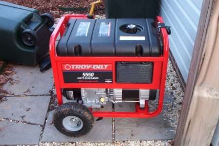

    This is all the stuff I got off my generator-
    TroyBuilt 5550 watt but it also says Briggs Stratton
    8550 starting watts/ 10 HP OHV
    Looks like this-
    IM000494a.
  2. ghrit
    Troy built the machine using components bought for the build. The B&S engine is one of those bought. It will last forever if it's taken care of along the way. Without knowing the mfr of the generator end, there's not much to add, yet. It would be useful to know if it has a generator or alternator, too.
    I have to say that the engine-generator looks exactly like my Sears machine, in fact, so does the frame and gas tank, right down to the wheels. If your question is whether or not it can take a propane conversion, I don't know ---. However, if it can, the power ratings have to be thrown out, it will handle a lot less load.
  3. kckndrgn
  4. Gator 45/70
    You will have to pretty much stand on your head to get the correct information.
    90% of the time the tag is at the bottom of the front cowling.
    The Ventura is the same size on the 10 Briggs American vs the metric Briggs
    This is very important when ordering a kit, Basically one is American 1/4 threads and the metric I think is 4 mm threads
    That's the only real difference.
