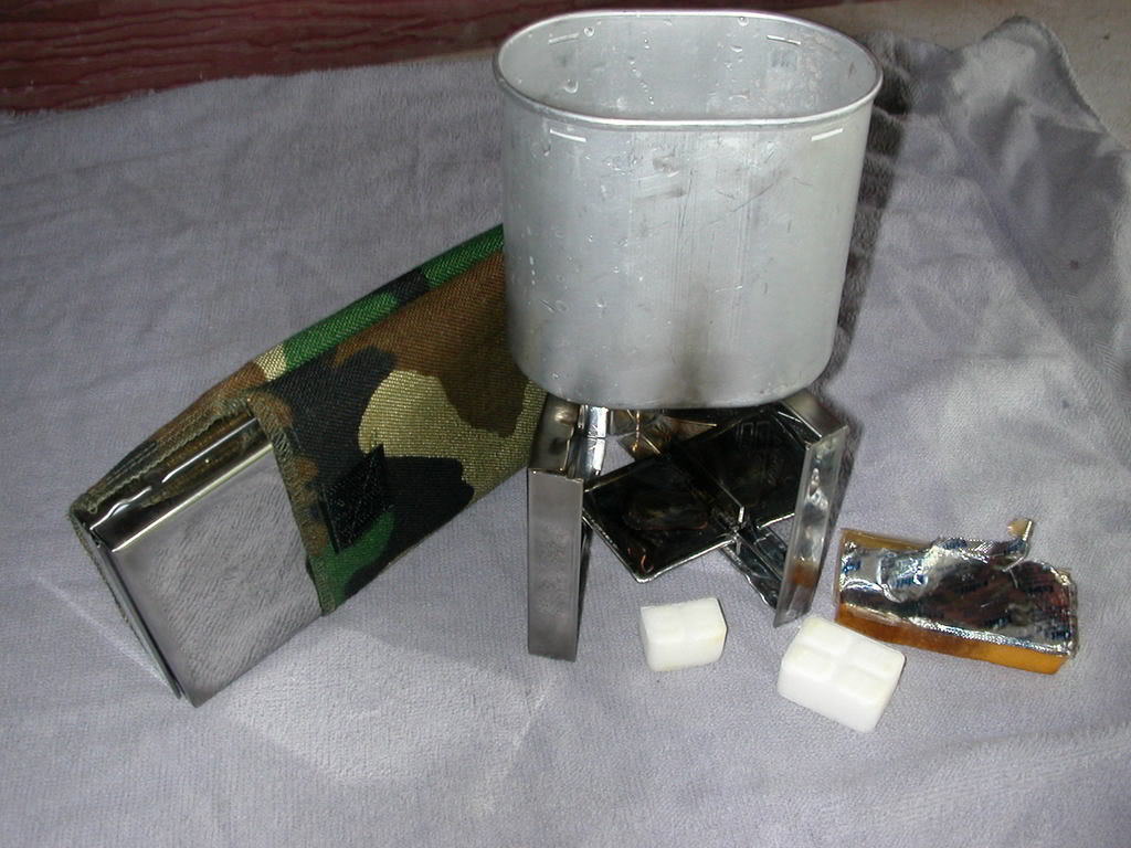

    The Pyro Pocket Stove is made by Pyromid Outdoor Cooking Systems, Redmond, Oregon.
    As you can see in the picture, it comes with its own nylon carry pouch which has a strap on the back for sliding onto your belt. It is made from 26 guage stainless steel sheeting and complete package to include a package of Esbit fuel weighs 6 ounces.
    The Esbit fuel included is 3 of the larger tabs as shown in the picture. I ran a control test with 1/2 a tab as shown. Approximate burn time was 9 minutes 15 seconds. I had a measured 8 ounces of tap water in the canteen cup shown and the water temp reached 175 degrees F.
    Personally, I like the form of the stove, but feel it would be better if it was 24 gauge or thicker. Also if you can tell from the picture it has a small fuel platform which folds down. It warped just slightly during the tab burning process, which allowed the fuel to 'float' about the platform. Heavier metal could possibly help this.
    I bought both these on eBay for almost $13.00 to include shipping.
    In closing, it is certainly sturdier then the Esbit stove and I like the fact you can place it with the hinges into the wind, acting as a wind block. Each person will have to determine their own usage and needs.
