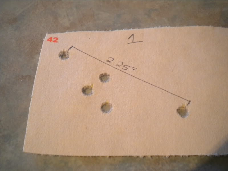

    Group One- 2.25"
    Group Two- 2.38"

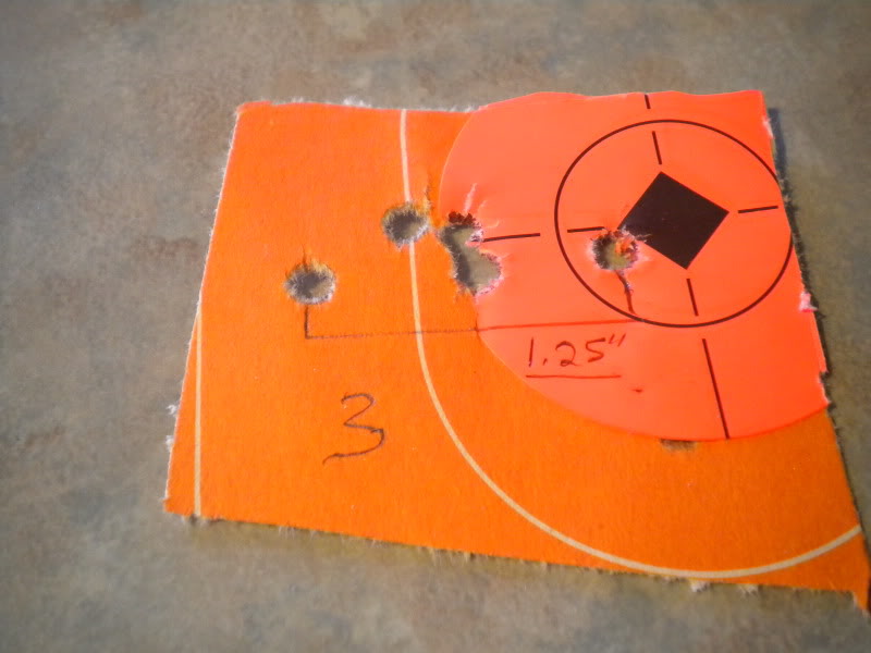

    Group Three- 1.25"

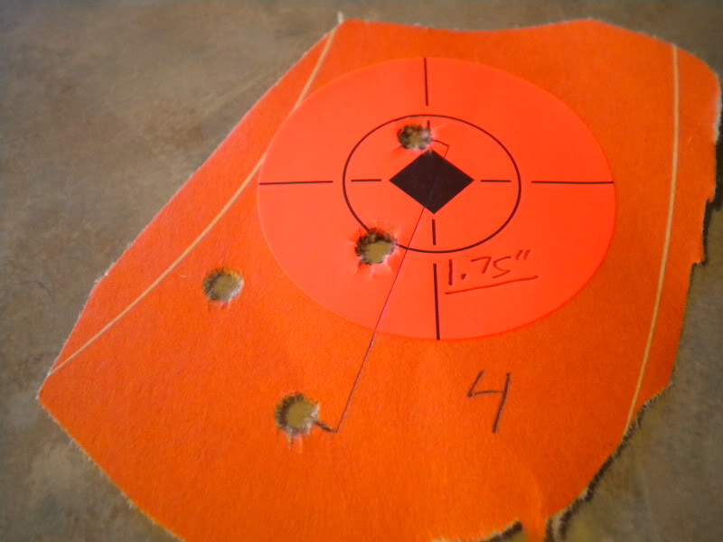

    Group Four- 1.75"
    There are a few things that can be learned here. The first two groups were at the top of the target. I think their more extreme spread is due to the increased elevation. I was straining to work the bean bag to those little black dots. The last pair of targets were lower and at a more natural point of aim. The third target was in the center of the paper (a B-27 man target). This created a more natural "center" through the scope. Of course, I was getting more comfortable with the carbine toward the end. I wish I had more ammo to put on paper, but the steel was calling my name earlier in the shooting session ;)

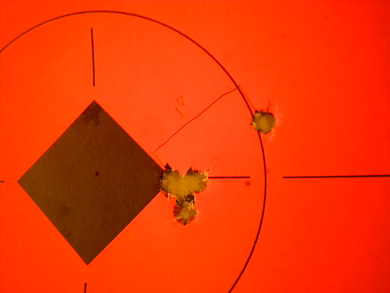

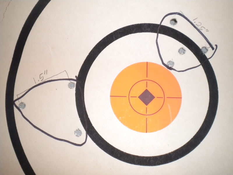

    Well, I decided, for $$ really, to stick with a 69 grain round. I changed out the Dillon sliding bar powder drop with a Hornandy case activated powder drop. It enables me to use my RCBS Uniflow powder measure (or similar) for a more consistent powder drop. Here is the equation that I believe is is beginning to spell success- good barrel + good bullet + a consistent powder drop = acceptable MOA accuracy. The trade off in this equation is time and money. I'm not using match primers, virgin brass, or any other known enhancers. I can crank out about 400 of these in less than 2 hours with real attention to detail. I have some 850 loaded now. Price per 1000 is about .22ea + powder.... I think?

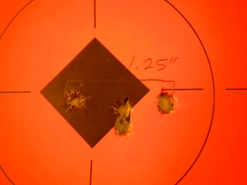

    Anyways... the other thing I confirmed is the grip pod sucks for real accuracy. Here are the results. Pic 1 is with grip pod. All others were off a bipod with American Defense mount.
    Grip Pod:

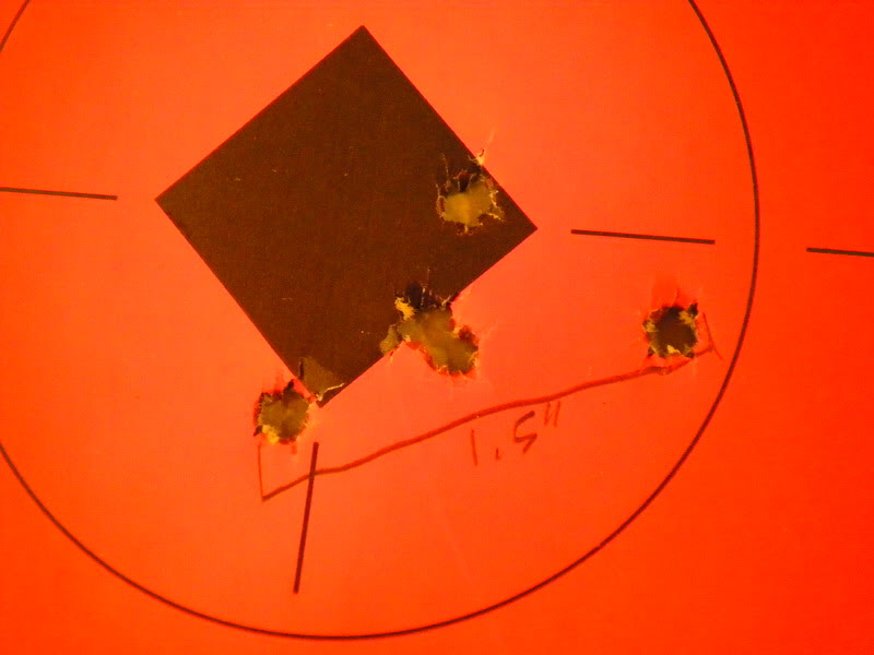

    All the following are 5 shot groups with bipod...
    Discounting the flyer, this group would be .5":

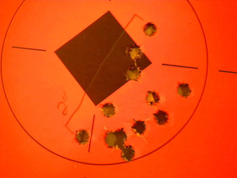

    The next pic was rapid fire. It looks like I can hold 2" groups in rapid fire:
    The first group with the bipod was the best group. At the time, I was spotting for my daughter too. The groups became worse from that point, probably due to my split attention. For reference, the square diamonds are 1" x 1". The center dot on the Leupy 1.5-5x is 1 MOA at 100 yds. That makes it a bit difficult to center the dot with the 1" diamonds IMHO. Consistent sight picture was a bit difficult. With a high power scope, I think the groups would shrink quite a bit. I have another scope I will throw on eventually (need a mount).
