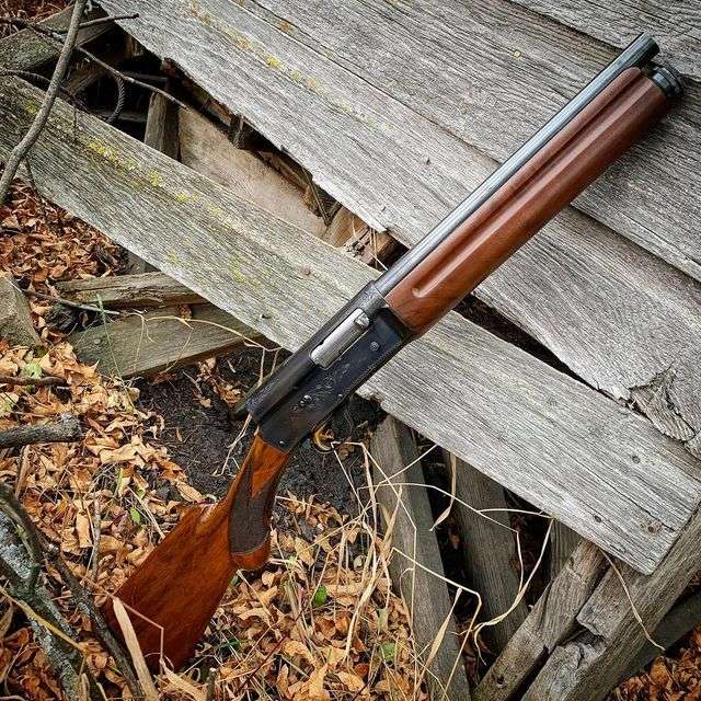

    A-5 SBS.
    Now, this is not my shotgun, it's someone else's Browning A5 cut down to an SBS. The A5 uses an inertial operating system. So does the Model 48 and 1148 Sportsman. I should be able to cut down the barrel to the old, factory length magazine tube and have it function just as good as the original 28" barrels that came with it.

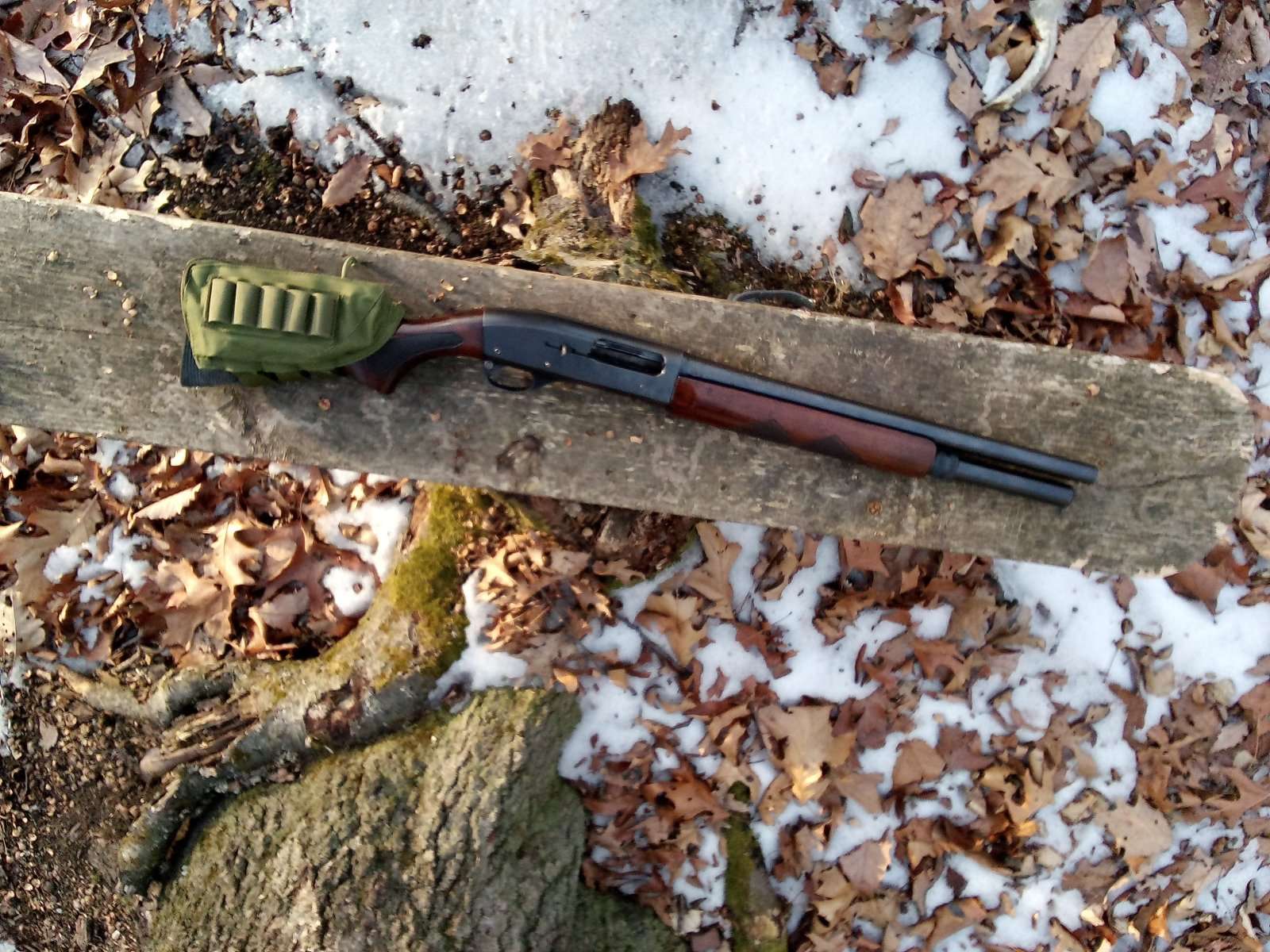

    One of my Model 48's was always a little finicky and not wanting to operate reliably. Last year I kept playing around with the friction ring, to no avail. I'd shoot anything I could get my hands on- from high brass buckshot and slug loads to low brass birdshot. It only shot them one at a time; I had to manually cycle the action.
    Remington Sportsman Model 48 - 1.
    Here it turns out it only needed a really good cleaning, especially in the friction ring area. My online friends cautioned me against cleaning and lubing the mechanism, claiming it will "go full auto" and such nonsense. It turned the shotgun back into the weapon it was meant to be- a semiauto shotgun. I was very happy with the results!

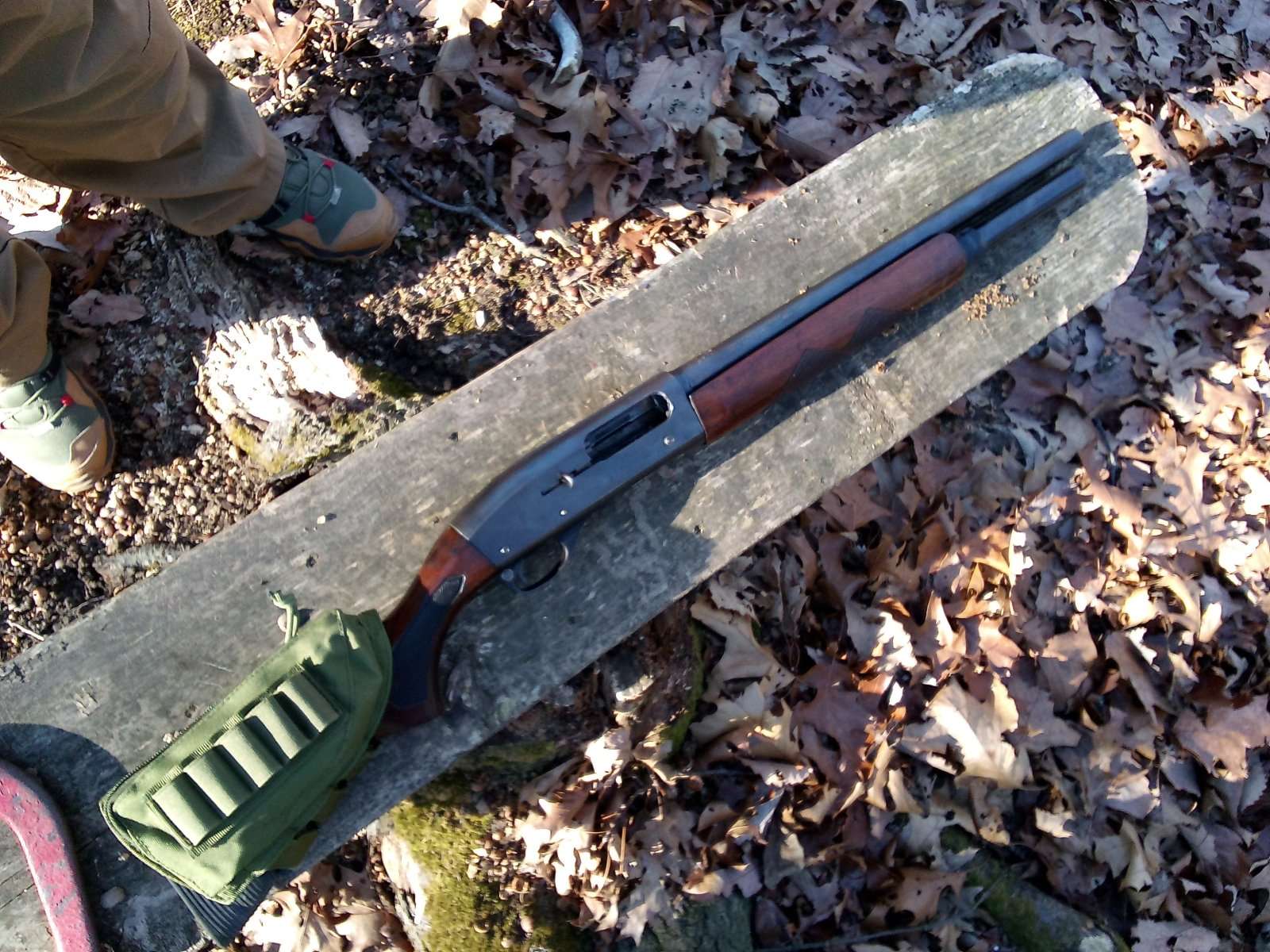

    This is probably the one I will cut down, if and when the rules are revealed to us:
    Remington Sportsman Model 48 - 2.
