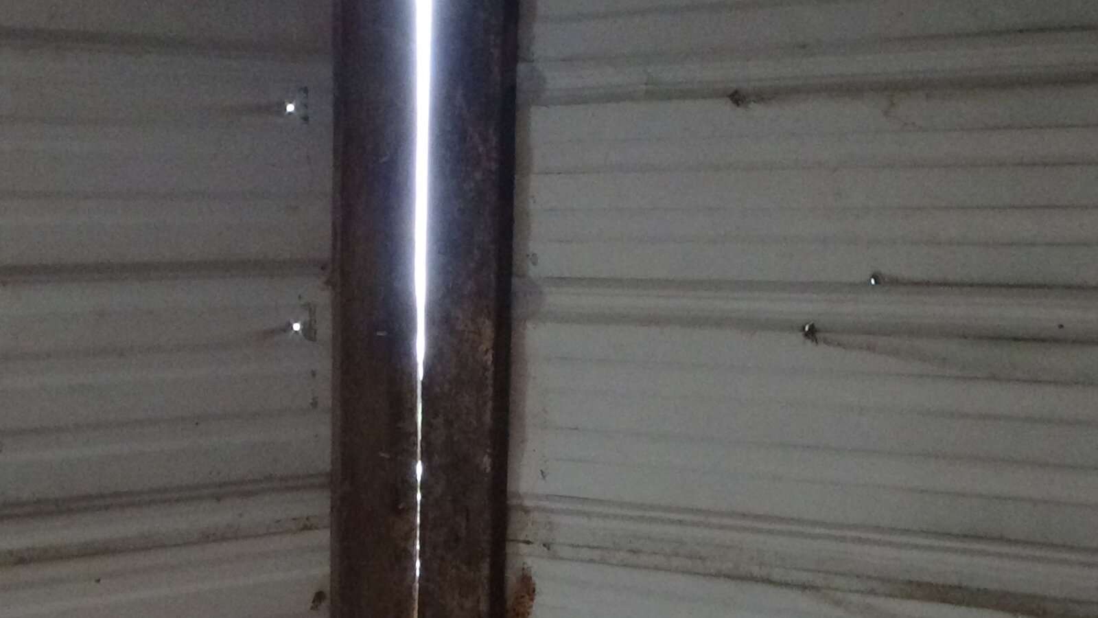

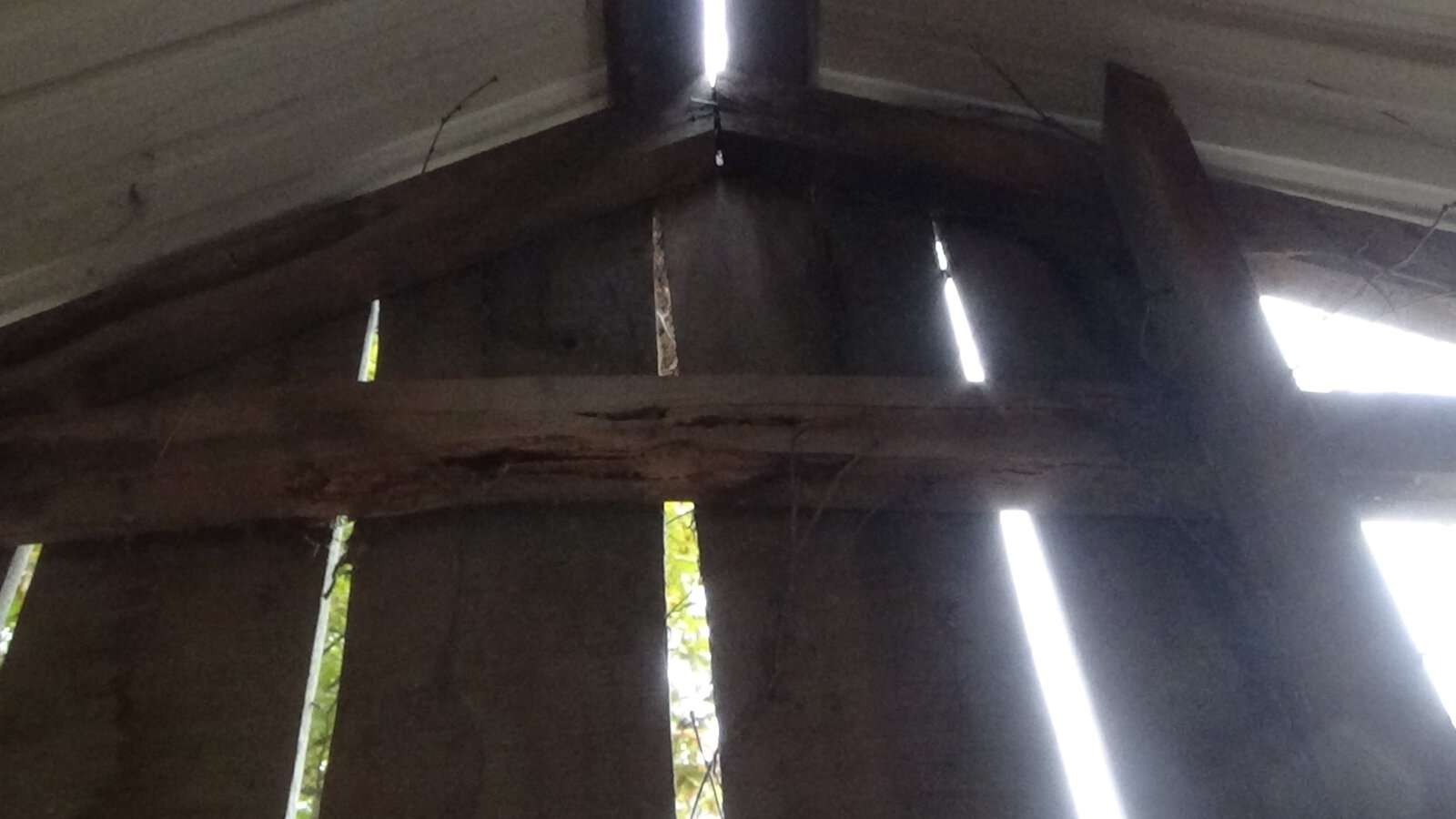

    So Since then I have gotten some wood rot in the peak boards. Still solid enough though to screw a new cap into. DSC00950.JPG

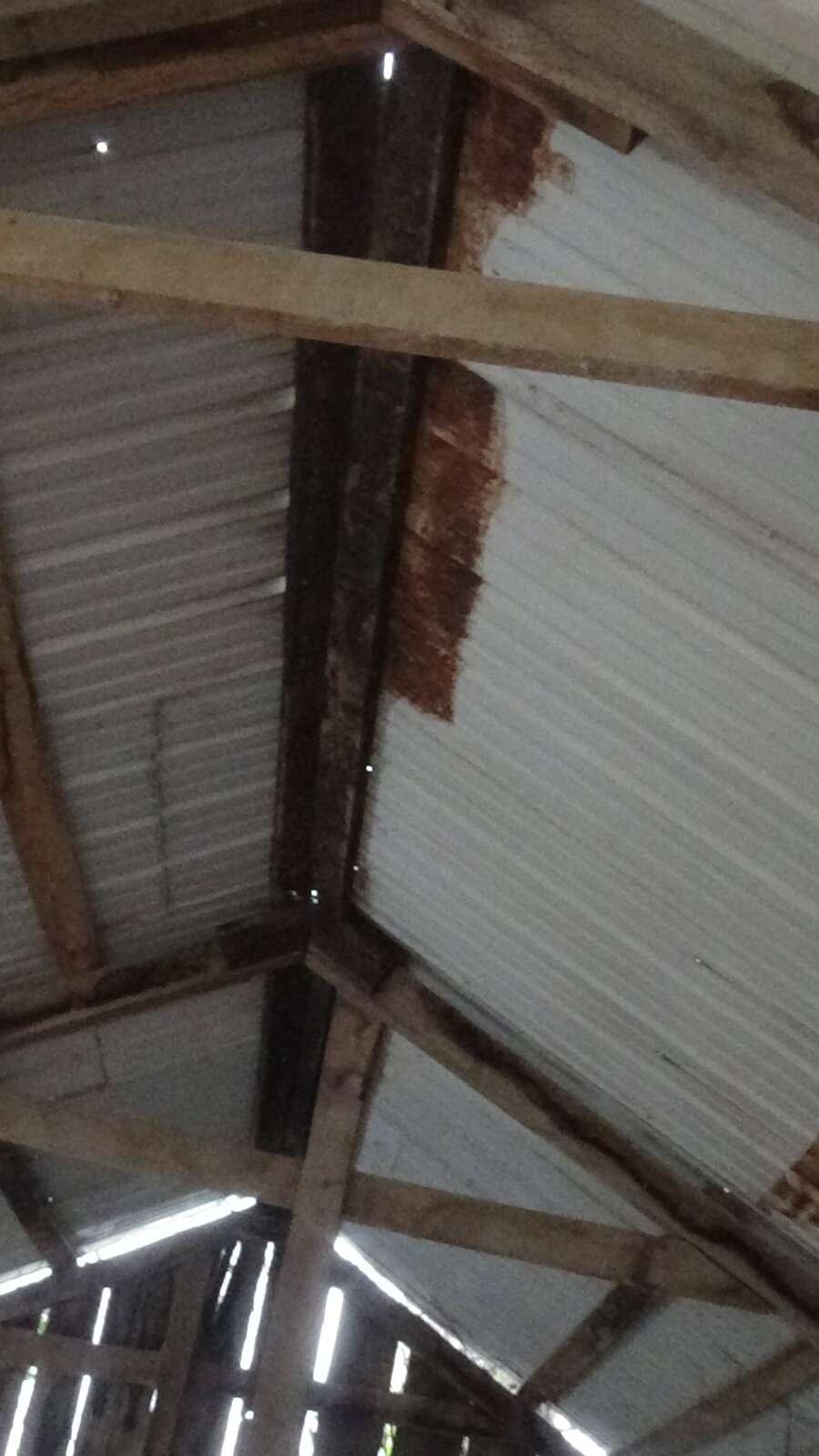

    I must have missed a spongy spot in one the truss 2x4s It rotted out pretty good in middle. Going to fix it today by sistering over the entire end truss.

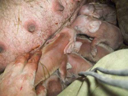

    I spent more than a few nights helping with rough births in the barn as well.

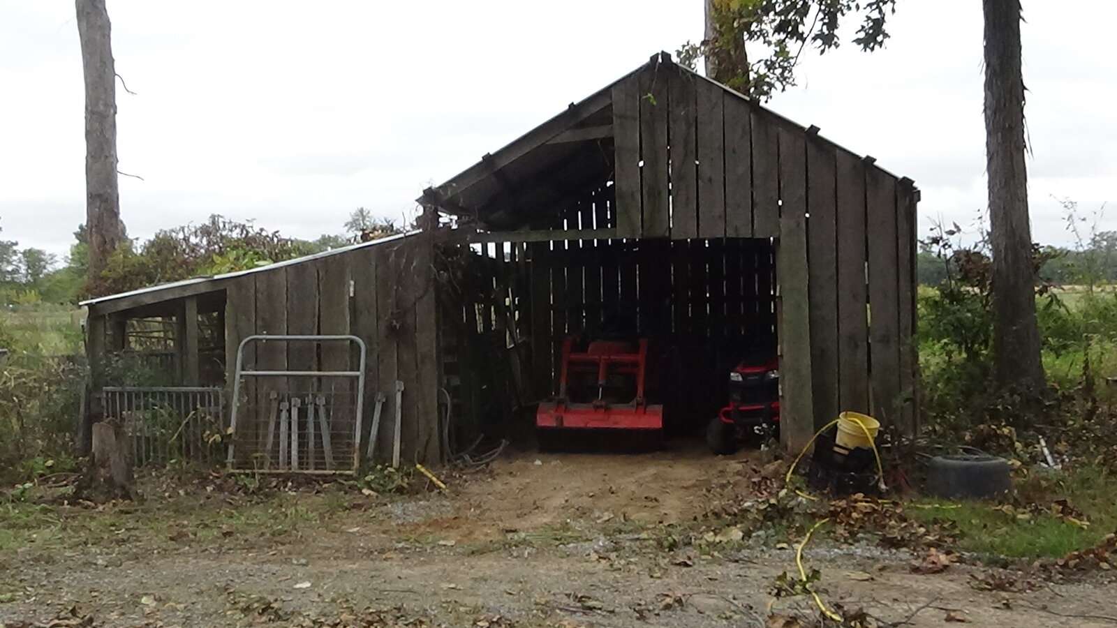

    Sooo it is going to be repurposed into a parking barn for the BX25 and the riding mowers and storage on the walls for garden tools, weed eaters, chainsaws etc. I cut the front out A LOT yesterday and need to buff up the post on either side of the opening and build a header over the top. Get some hinges and build a double swing door and get all of those bats milled and the wall gaps sealed up and yeah a new roof cap built or bought for it. And I might even put some rock down ontop of the very hard packed clay floor. I have old woven steel soft foot hog floors under about 6" of compacted clay that kept the Sows from rooting the whole thing out. Should make a nice parking shed for the next 40-50 years :)

    Drivers and sealing material for when the nail guns blow the seals are good things to keep on hand is pounding nails with a hammer are dirty words to you :) The only rotten part is in that foot or so section. And it is only rotten on the bottom half of that section. I build really basic and simple trusses obviously :) I am just going to build another truss identical to that one and tack it up side by side with the original with screws and make a dozen bore holes and pound pegs through old truss and new and then screw them some more. I use a older Hitachi NR90AE Nail Gun running 180-200PSI and yes I blow the seals on it pretty regularly as it is only supposed to run a max of 120PSI, for driving through oak but it weighs 11 pounds fully loaded and gets heavy fast up on a ladder or scaffold! Can drive 2-21/2 inch nails through the 1x stuff with my much lighter dewalt at 100psi which is great for tacking the side boards up to drill pilot holes for screws. Nailing on the ends of oak is a bad idea, it just splits the ends like driving a wedge between the grains. And then there was that time I slipped and shot a nail through my pinky finger and firmly attached it to a feed bunk frame....... And couldn't reach the cutters to cut the head off the nail LOL. Mrs Krap finally heard me and came to assist and laughed her ass off at my predicament.
