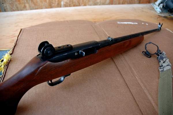

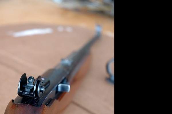

    Here's my 10/22 showing the rear Tech-Sight (and a mighty trophy sage rat :^) Looking forward to removing the barrel band, but need to get before and after target groupings from a bench rest -- maybe by next month...
    201006_SageRat.

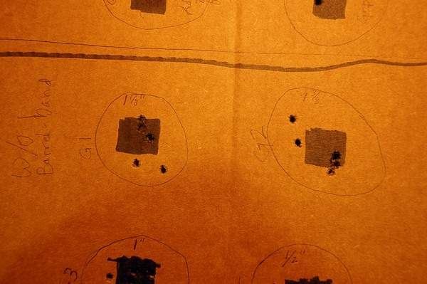

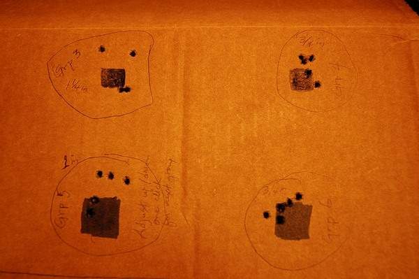

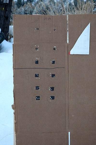

    I was finally able to take the Ruger 10/22 out again and do some shooting to compare performance between "with barrel band" and "without barrel band".
    The setup, although good enough for me, can't really claim any "statistical significance". It was all I had time and patience for. Some of the pertinent items of interest include:
    • There were 2 main groups: Main Group 1 was with the barrel band (5 subgroups), and Main Group 2 was w/o barrel band (6 subgroups). I was unable to use the sling for the 2nd Main Group because the sling was attached to the barrel band that was removed.
    • 5-shots were taken for each sub-group; some shots were almost within the same hole and may be difficult to see.
    • I wish I had sandbags or a real bench rest (I could feel my heartbeat shaking the rifle and had to keep adjusting my position:^).
    • It was about 34 degrees F when target shooting started, and ended at about 28 degrees and a small breeze.
    • If I had thought about it, I could have brought sandpaper and smoothed out the stock underneath the barrel for the 2nd Main Grouping w/o band. As it is, the stock is abutted next to the barrel, but not constrained by the barrel band.
    • The first few Sub-Groups were a little hard to see, but I found a big felt-marker that really helped.

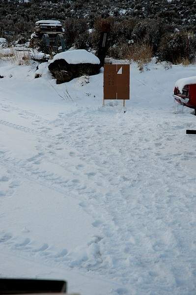

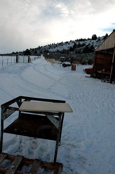

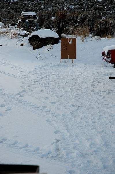

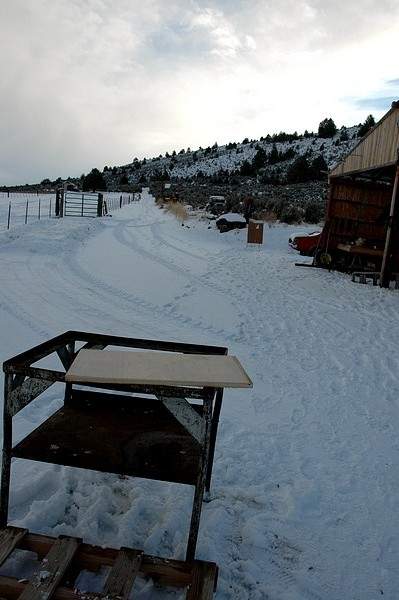

    Here is the Range:

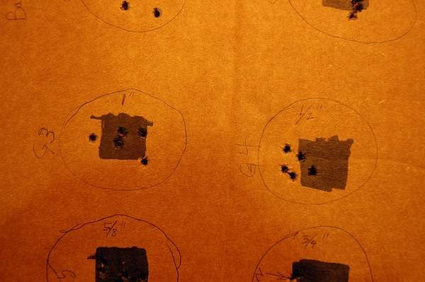

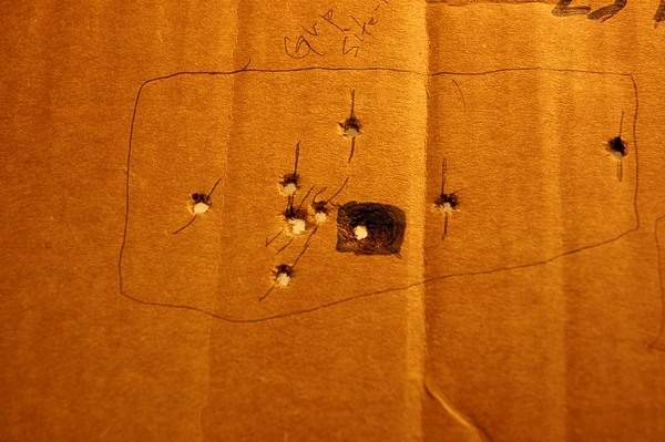

    A couple pictures of the target (note the felt-tip marker really helped being able to see the target):

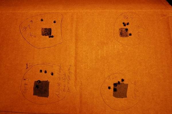

    Start of 1st Main Group w/ 5 sub-groups all using Barrel Band [NOTE: 1st sub-group was to site-in the rifle!!]:

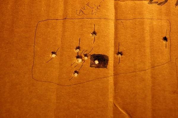

    Start of 2nd Main Group w/ 6 sub-groups w/o Barrel band:
    Comments: The average group sizes are about 1.05 and 0.90 inches respectively (each sample Std Dev about 0.33 in). No significant statistical difference could be assumed, but you can draw your own conclusions by the groupings if you like :^)...

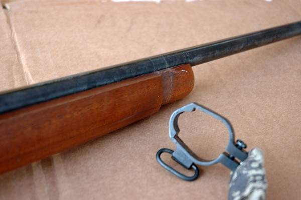

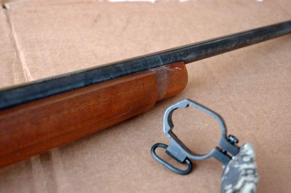

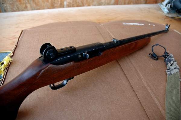

    Rifle:

    The barrel band will stay off - already got some replacement parts that will attach to the wood [winkthumb] Even though there's not significant difference between "with" or "without" the band, I think there could have been if I'd been able to re-mount the sling and file out some of the wood away from the barrel. In the past, the sling has improved my accuracy considerably.
