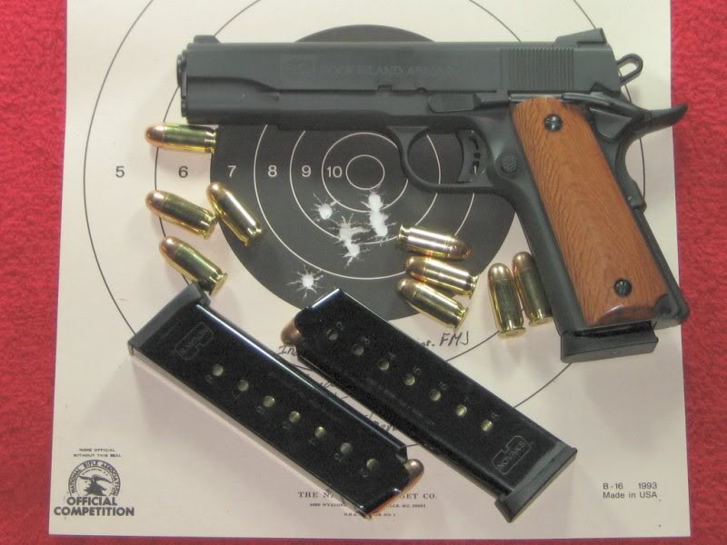

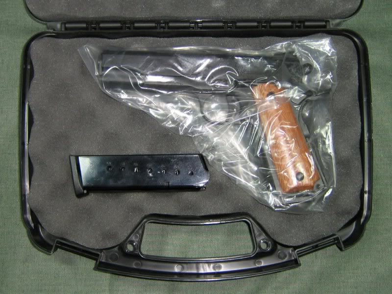

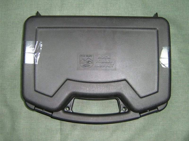

    The Rock Island Tactical 1911 was delivered to James Belz's Great Guns in Burleson, Texas, wrapped in a semi-oily plastic bag within Rock Island's black, clam-shell pistol case.
    Black clamshell Rock Island Armory Pistol Case
    The inside of the RIA clamshell case
    The interior of the case is lined in egg-crate foam padding. The RIA Tactical came equipped with two 8 round Novak blue-steel magazines. At least, that's what I thought. Lifting up the foam to inspect the case for other "goodies", I discovered two more 8 round Novak blue-steel magazines, in addition to a rather Spartan owner's manual, and an envelope containing a fired cartridge casing. I would surmise that the two spare magazines were sent along for the test.

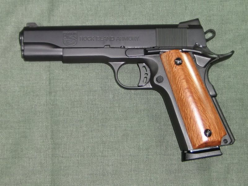

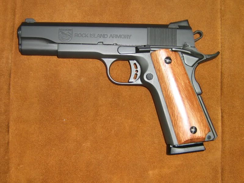

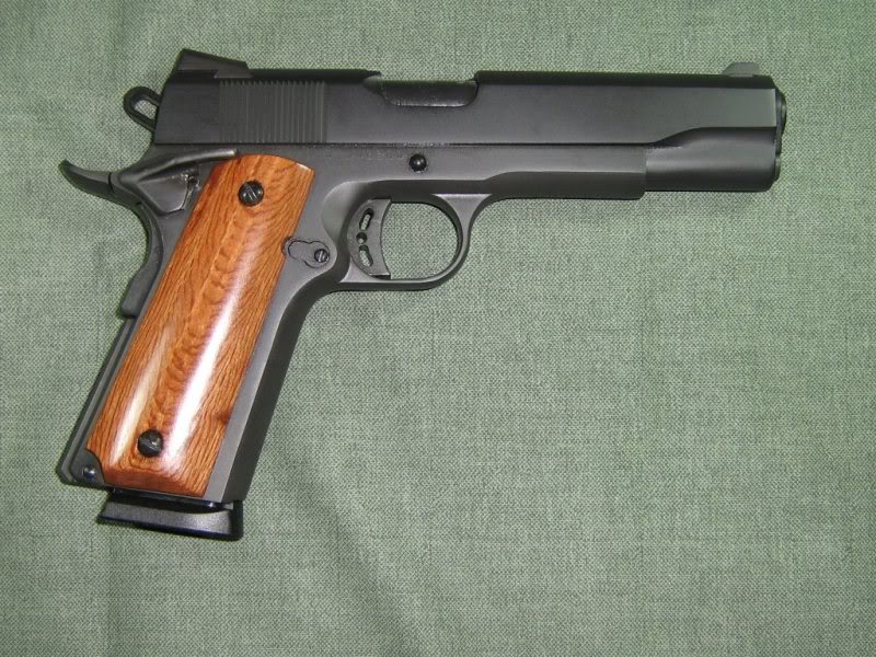

    The pistol itself is a full size, Parkerized 1911 with light colored wood stocks. The finish appears to be uniform over the entire weapon, and all exposed parts (with the exception of the full length guide rod) are similarly treated.
    The slide is embellished with Rock Island's logo and the words "Rock Island Armory" on the left side. The right side of the slide is devoid of any roll marks or lettering. As can be seen in the photograph, the slide also has fixed combat sights.

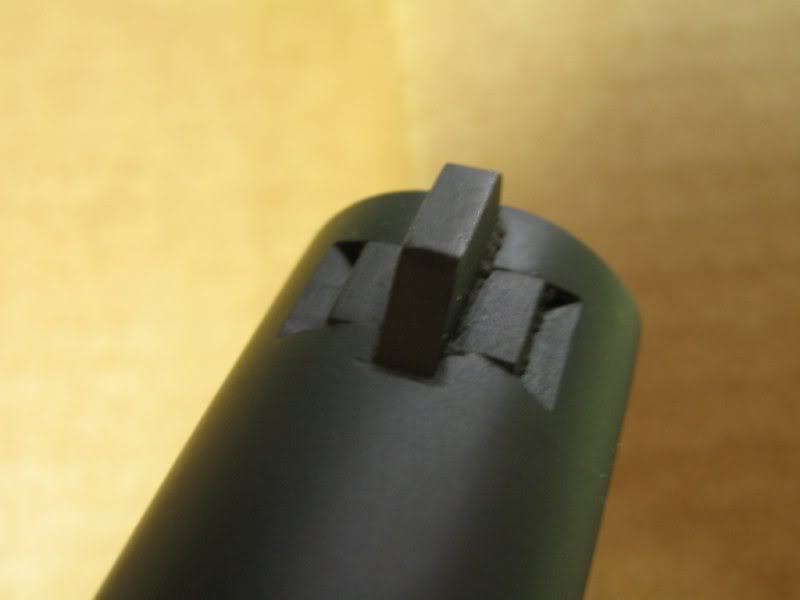

    Front sight
    The front sight is a higher profile design, without serrations or colored dots. The edges of this sight are not "blended" into the slide profile.

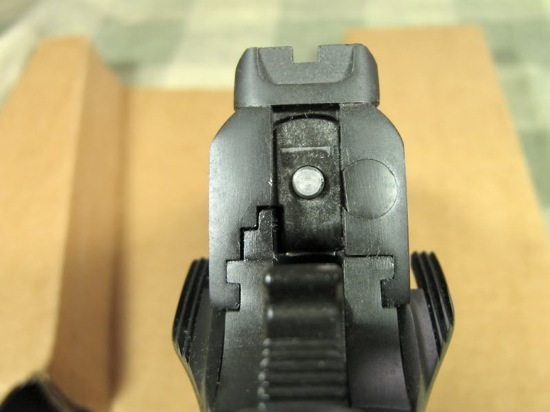

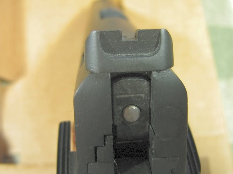

    The rear sight is also a dovetail unit, similar in design to a Novak sight. It does not have serrations on its face, nor any type of colored highlights. The rear sight is not "blended" into the profile of the rear of the slide.
    Rear of slide and frame, showing extractor fit and ambidextrous safety.
    The fit of the slide to the frame is tight, without noticeable gaps, and the internal extractor fits flush with the rear of the slide. The ambidextrous slide safety is serrated on both sides of the unit, and does not protrude from the frame in a way that would readily snag on clothing or holsters. The hammer is of the current rounded shape, and there is a half-cock notch, in addition to the full-cock notch. The pistol is slightly dehorned, for a more user-friendly interface.

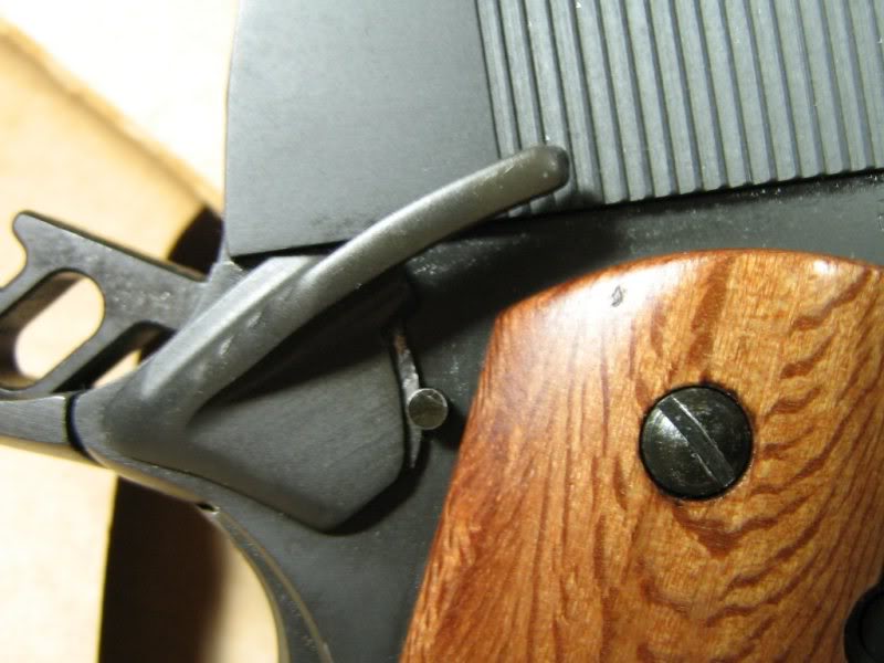

    Right safety panel, showing sear pin retention
    This photo shows how the right slide safety panel is retained by a longer sear pin, which has a cut to correspond with the flattened area of the panel. This photo also shows a close-up of the rear slide cocking serrations. These are small, vertical cuts, nineteen in number.

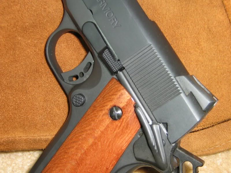

    Left rear portion of slide, showing magazine catch, slide stop, trigger, and left side grip panel.
    The nineteen vertical cocking serrations are apparent in this photo, as well as the checkered magazine catch and checkered slide stop extension. These two checkered controls are of standard size. The long trigger has three cut-outs, a serrated face, and is not equipped with an externally adjustable over-travel screw.

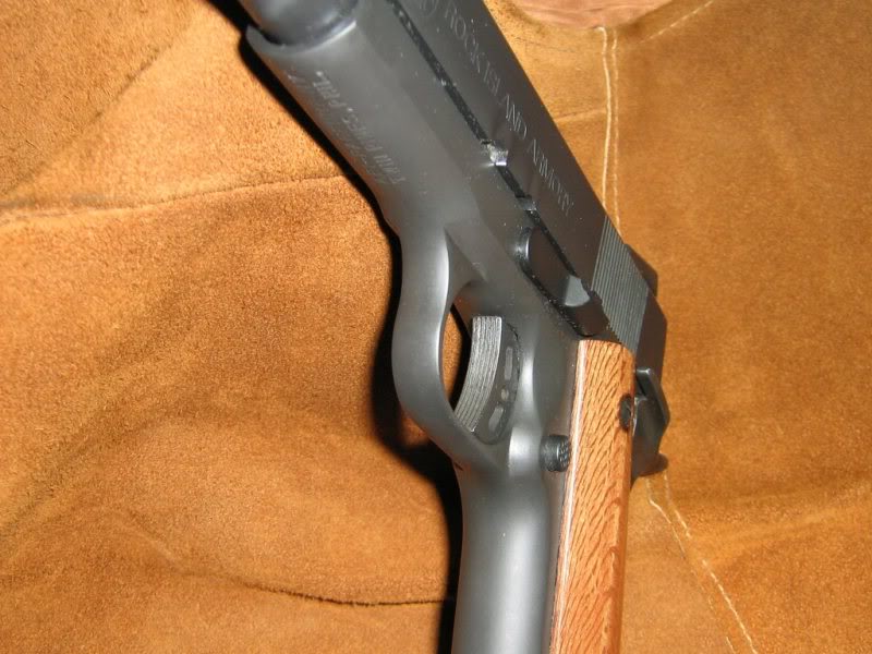

    Trigger face
    Repeated tests with a RCBS Trigger Pull Gauge showed an average of 5 pounds of pull to release the sear, out of the box. Very little take-up is followed by a crisp release. Dry firing confirmed that the trigger release was predictable and positive. The front strap is smooth.

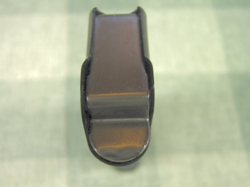

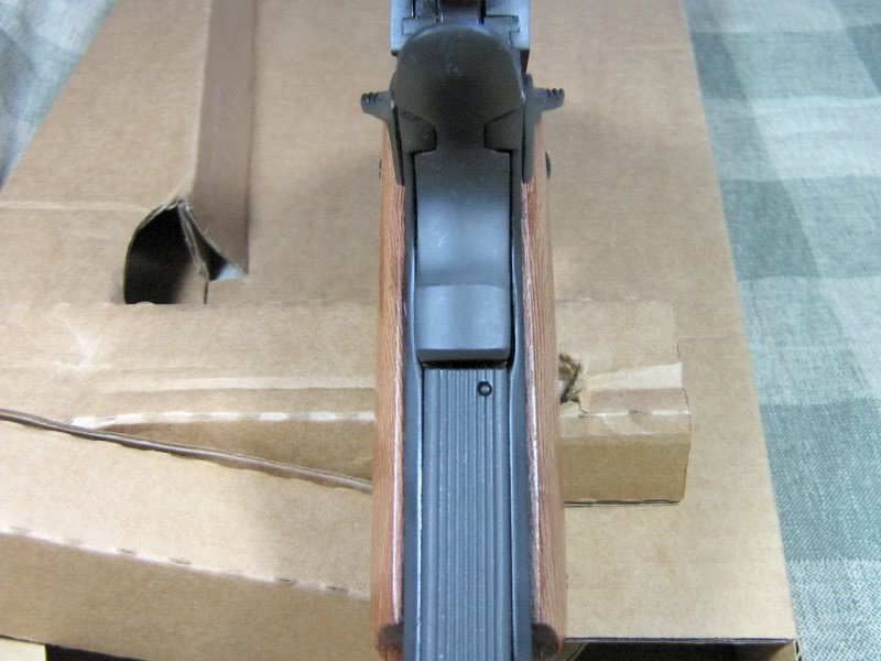

    Mainspring housing and rear of grip safety
    The flat mainspring housing is serrated. The grip safety has a memory bump, and sits slightly askew in the cut-out of the frame. Grip safety disengagement and function testing was positive on the RIA Tactical.

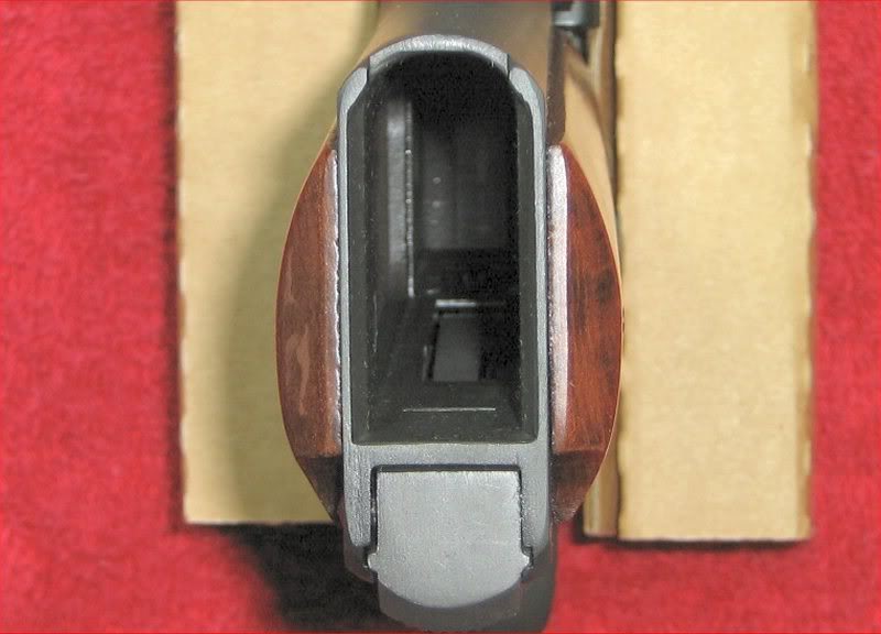

    Magazine well
    The magazine well is slightly beveled and magazine insertion and extraction was positive, with no hang-ups in operation.

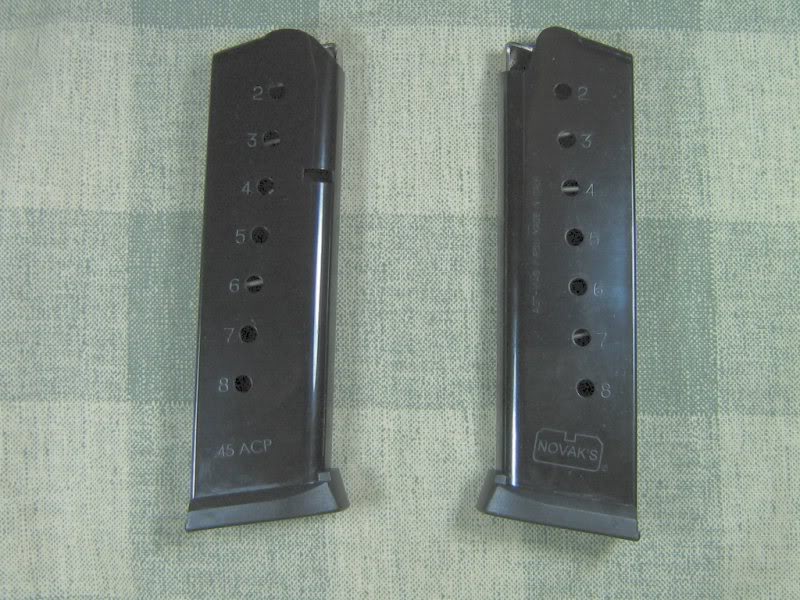

    Left and right sides of magazines
    Stainless steel follower
    The eight round Novak magazines supplied with the RIA Tactical were easily loaded and functioned without incident during range tests. These magazines are provided with polymer base/floor plates, for easier tactical reloads and easier disassembly.

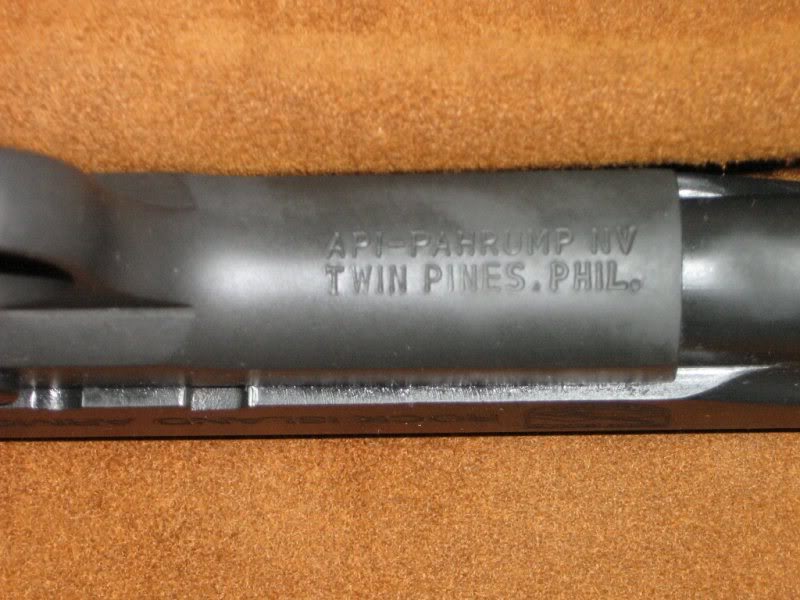

    The bottom of the dust cover reveals manufacturer and distributor markings.

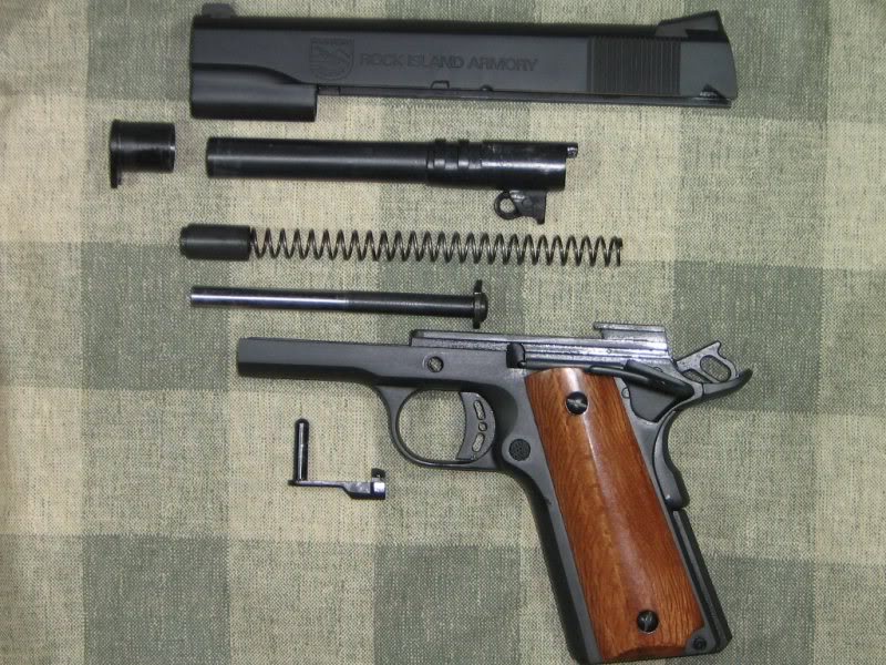

    Disassembly
    The field stripping procedure to be followed with the RIA Tactical .45 ACP is different than for other, full length guide rod equipped full size 1911 type pistols. Making sure that the pistol is completely unloaded, and with the magazine removed, the slide must be moved to the rear (under tension from the recoil spring) so that the slide take-down notch is over the slide stop, at which time the right side of the slide stop pin is pushed, and the slide stop is removed. The slide is then moved forward, off the frame, taking care that the guide rod, recoil spring, and recoil spring plug remain in position with the slide. Allow the guide rod to move back slightly toward the rear of the barrel, so that the barrel bushing can be moved, carefully, clockwise, to release the recoil spring plug and spring, toward the muzzle. The recoil spring plug must be pushed in with a non-marring tool (such as the handle of a nylon toothbrush) in order to be able to turn the barrel bushing. Then the full length guide rod can be removed from the slide, toward the chamber end of the barrel. The barrel bushing is then moved counter-clockwise, lining up its notch with the recoil spring tunnel, and removing to the front. The barrel link can then be lowered onto the barrel, and the barrel can be removed from the slide, from back-to-front, toward the muzzle. (This rather complex disassembly procedure is required, because the FLGR is not compressible with the pistol in battery, or, with the slide slightly pushed to the rear.)
    Rock Island Armory Tactical .45 ACP field stripped
    Unusual design of the rear of the full length guide rod

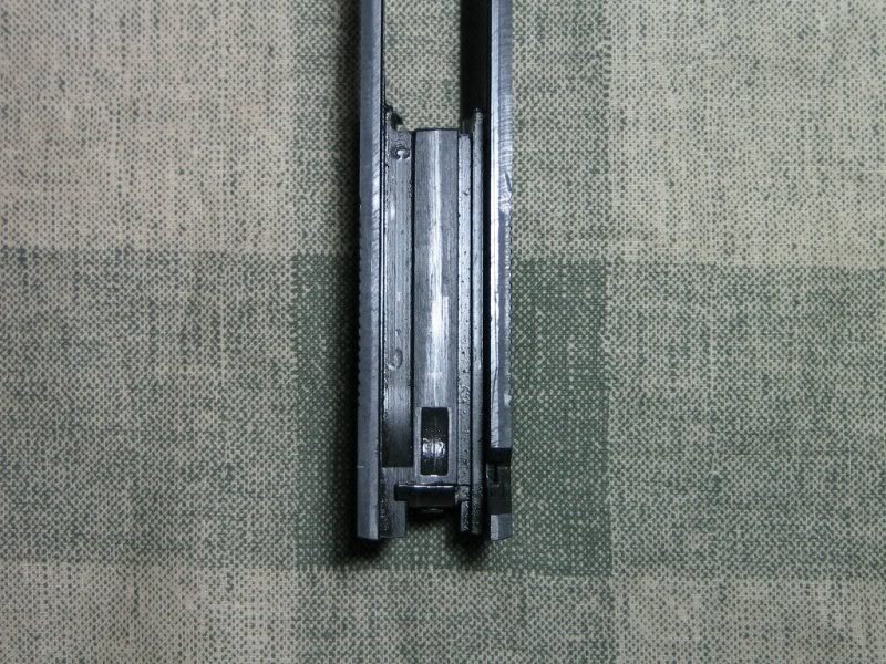

    Inside of slide, showing absence of firing pin safety mechanisms, and slight tool marks.
    Reassembly is in reverse order, except for the fact that the FLGR must be positioned, and secured by hand, to facilitate reinstallation of the recoil spring plug. This is a difficult procedure, at best, because the plug must be pushed in with the non-marring tool, all the while securing the FLGR from movement toward the rear of the barrel. Once assembled, the slide is positioned back onto the frame, the slide stop inserted, then aligned with the take-down notch for final assembly. This is done (as in disassembly) with the recoil spring in tension.

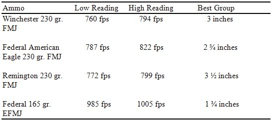

    Trying my best to shoot between gusts of wind, I fired at least 20 rounds of each type of ammo tested, and averaged the best (and most representative) velocities that I obtained. The accuracy results were the best 5 shots of 25 shots taken with each of the factory loads tested. I consider the results to be skewed as a result of the weather conditions and my own reactions to those conditions. I do not hold the RIA Tactical at fault. I do admit that some white dots on the combat-style sights might have allowed me to shoot slightly tighter groups, but I also changed from NRA-type targets to paper plates, midway in the test, for improved visibility.
    According to RIA, their pistols come set up from the factory to fire FMJ ammunition. Due to this, I didn't try any JHP with the pistol during my initial tests, a shooting session with JHP is planned and will be added at the end of this review shortly.
    In all, I fired over 300 rounds through the Rock Island Armory Tactical .45 ACP 1911. During the test, I had 11 failures to return to battery. I discovered that I was using Remington ammunition from two sources, and that some of the rounds from one of those were out-of-spec. All failures were encountered with ammo from this batch. I experienced no difficulties with the remainder of the ammo tested. Ejection of spent casings was positive, though randomly scattered behind, and slightly to the right, of my firing position, most probably due to the fact that the firing pin was a loose fit to the extractor and allowed it to slightly rotate in its tunnel.

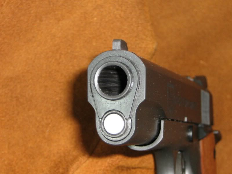

    Muzzle of the RIA Tactical, showing the recoil spring plug and the FLGR
    My major complaint about this weapon is in the use of a full length guide rod, and reverse recoil spring plug. The length of the guide rod makes disassembly difficult, and this could have easily been avoided by the use of standard plugs and a short guide rod. I realize that short guide rods, regular recoil spring plugs, and recoil springs are relatively cheap items, and easily acquired. Unfortunately, a new-to-the-1911 buyer is not familiar with these things, and some of these pistols might be going back to the retailer in frustration. Hopefully, this situation will be rectified in future production runs of this pistol.

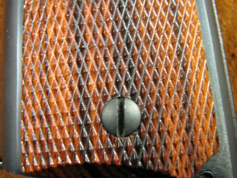

    Wood stocks on RIA frame
    Wood stocks on Colt frame
    In addition, the grip/stock panels do not fill the grip area of the frame, making for an unusually unfamiliar feel when holding and firing the pistol. I realize that stocks are one of the first things that get changed on 1911 type guns, but the "feel" of a weapon, at the retail supply level, does make a difference in a sale or a pass.
