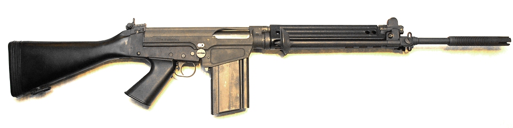

  15. NotSoSneaky
    NotSoSneaky former supporter
    Some are betterer.than others. [seeno][hearno][sayno]

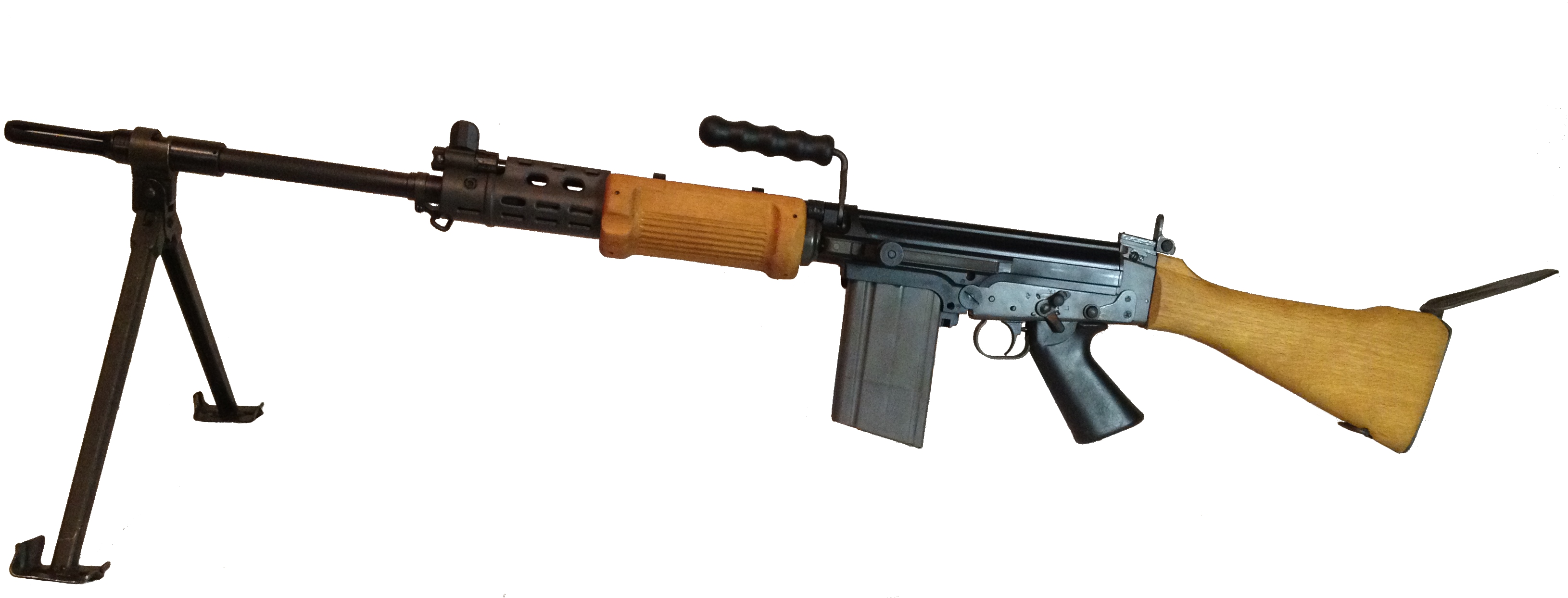

  16. NotSoSneaky
    [OO] Very [coo]
