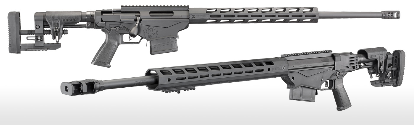

    Does anybody have experience with the Ruger Precision Rifle? First gen models reportedly were sometimes a bit spotty, but it seems like the issues have been worked out. I've wanted one for a while, but wasn't really jazzed since it only came in a short action. Somehow I missed out until yesterday that it came out in 300 WM and 338 LM last fall, and recently in 300 PRC, which lies between the 300 WM and 338 LM in power.
    The field tests and reviews I've read have been pretty glowing with 0.5 MOA results on the long actions, but naturally these are fro publications that get advertiser revenue, which is why I'd like to see if anybody here has flirted with the platform.
    The 338 LM is a few hundred dollars more* than the Savage version, but it has some features I really like compared to the Savage, some of which are listed below.
    What I like about the platform:
    • It's a "tube" gun, meaning that the recoil is sent to the stock in a straight line minimizes muzzle rise and lessens felt recoil
    • It's based on the Ruger American action so it's almost as easy to maintain as an AR including barrel swaps.
    • The trigger is also a Ruger American, which like the action is Ruger's version f the highly accurate but inexpensive Savage 110.
    • The butt stock is AR buffer tube comparable, so you can use other butt stocks like the excellent Magpul UBR and PRS.
    • The butt stock folds regardless of which one you use.
    • The pistol grip is also AR-15 compatable.
    • Might even be the most important advantage - I can get the exact same platform in cartridges from 22 LR through 6.5 CM, 308, all the way to 338 LM, so I can practice with milder recoiling rounds with an otherwise near identical rifle.
    Now, if Ruger can bring this bad boy out in 50 BMG...

    I had a Gen-1 in .308 when they first came out! Accuracy was kind of OK, but it really needed to be broken in, so I fire lapped it in using Tubbs Bullets and ran through the grits until the barrel was properly burnished and then did the regular break in! With 175 gr SMK's it ran pretty consistently under 1/4 Mil out to red line of about 1200 meters! There were some Q.C.issues with mine, but I was able to address them pretty easy and ended up with a slick shooting rifle!
    I sold it and replaced it with a Savage and was sad to see it go!
    Now that they are available in long action, I could see adding another accurate .300 Mag to the arsenal, as the TRG should be kept ready in reserve until it's called for!
    In .338 L.M. I would be very careful, that barrel had better be up to the task or it will never show the potential, something Savage learned the hard way!
    Hits:
    Super smooth bolt with short throw for good scope clearance and rapid bolt manipulation!
    YUGE potential for tuning and upgrades.
    Growing aftermarket support, it's finally getting the respect it deserves.
    Ultra strong action, good ergos, and common mag interchangeability.
    The new long actions take A.C.I.S. mags, which while expensive, rumors are that MAGPUL is addressing this!
    Quick change barrels and they can be adapted to REMAGE pattern barrels super easy!
    Misses:
    Poor Q.C. Ruger was cranking them out so fast that things that normally would get addressed got through, this really turned a lot of folks off and Ruger suffered badly for it! The Action was rough and gritty, the trigger had play, and the bolt had that damn plastic shroud! The Mag Well was too tight, and the coating made it even tighter, the mag release was too tight and it all took a complete disassembly and "De Horning" to clear it up, then re coating in DuraCoat to fix it up!
    Wrong barrel specs, a rifle of this potential should have had a better barrel right from the start, mine was the standard 20 inch spec .308 with tanker brake, it should have been a R-5 at 24 inches and a much better brake! Accuracy potential was not what Ruger claimed for this caliber, Properly chambered and broken in, mine was only ever a 1200 meter rifle on a good day!
    Barrel wasn't crowned all the way to the threads and it had a gap between the end of the threads and the back face of the brake which made carbon build up really quick and a bugger to clean!
    The Chamber was pretty rough, while it didn't chew up the brass, it was sticky and had lots of tool marks!
    All in all, I was disappointed, especially at the purchase price, but after addressing it's issues, it became a super star performer!
    Ruger SHOULD have done all that at the factory and then some, especially at that price!
    By the time all was said and done, it cost almost what my SAKO TRG cost, and only just kept up with a standard Tikka Super Varmint ( different caliber's) but a .308 shouldn't cost that much!
    With a custom match spec REMAGE conversion from Douglas Barrels, the rifle exceeded Rugers claims of 1600 Meters, but cost $500 more on top of the purchase price!
    I would be leary until I had a chance to inspect one closely and got a good feel for it. I would inspect it's barrel and chamber closely and also make sure mags fit properly, lock up easy yet securely, and drop free with no effort! I would expect the trigger to be crisp and to break super clean, and the bolt to feel like it's running in bearings ( Like a Tikka) and I would be highly critical of the barrel specs!
    For a .300, that better be a 26 inch barrel or longer to the face of the crown, and not the end of the installed brake, it had better be a 1/10 or faster twist ( 1/9-3/4 ) and R-5 rifling!
    For .338 L.M. it better be a full 30 inch barrel, R-5 rifling, beveled chamber lip, and 1/9 ish twist!
    Both barrels better better be air gauged and require minimal break in, and the chambers need to be almost match tight!
    If I found the Rifles met those specs, I would be impressed and would prolly add the .300 to the mix! for .338 L.M. I would look elsewhere unless Ruger has really stepped it up!
