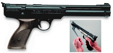

    On some pistols the front Sight post may be bent. I also shoot Pistols and Rifles Competively and sometimes the problem is ME! (I'm a Retired USMC Recon Scout Sniper) Try using these diagrams and/or get an Air Pistol to see what's happening in the absense of Recoil. Ric
    <TABLE class=conh cellSpacing=0 cellPadding=0 border=0><TBODY><TR><TD width="100%" height=17> AVANTI 747 Triumph Match by Daisy </TD><TD vAlign=top align=right>[​IMG]</TD></TR></TBODY></TABLE><!-- // content header--><!-- content --><TABLE cellSpacing=0 cellPadding=10 width="100%" border=0><TBODY><TR><TD vAlign=top><TABLE cellSpacing=0 cellPadding=5 align=left border=0><TBODY><TR><TD align=middle>[​IMG] </TD></TR></TBODY></TABLE>One Year Limited Warranty
    AVANTI Model 747 Triumph
    Single-pump pneumatic with side pump lever;standard bolt action. AVANTI's finest match-grade pistol. <!-- special note -->An adjustable piston in the single-pump pneumatic system for consistent velocity maintains pinpoint accuracy, shot after shot. Also features an adjustable trigger and match-grade choked steel barrel. This is a no-nonsense match pistol
    <!-- // special note --></TD></TR></TBODY></TABLE><!-- option --><TABLE cellSpacing=0 cellPadding=4 width="100%" border=0><TBODY><TR><TD class=dhead width="55%">Item Description</TD><TD class=dhead align=middle width="15%">Caliber</TD><TD class=dhead align=middle width="15%">Max Velocity</TD><TD class=dhead align=middle width="15%">Price</TD></TR><!-- item option --><TR><TD class=bgrey>SIGHTS: Blade and ramp front, open rear with windage and elevation adjustments
    SAFETY: Manual crossbolt trigger block
    GRIP: Molded woodgrain checkered; with contoured thumb rest, left-hand grip available
    BARREL: Lothar WaltherTM rifled high-grade steel barrel; crowned, 12 lands and grooves, right-hand twist. Precision bore sized for match pellets
    WEIGHT:2.35 LBS.
    LENGTH: 13.5 IN.
    TRIGGER PULL: Single-stage, adjustable; 1.0-4.5 lbf. (4.4-13.3N)
    SINGLE SHOT </TD><TD class=bgrey align=middle>0.177"</TD><TD class=bgrey align=middle>360 ft/sec</TD><TD class=bgrey align=middle><STRIKE>$159.95</STRIKE>
    $129.95</TD></TR><TR><TD class=bgrey colSpan=2>Ammo | Accessories Item#:DY747Triumph</TD><TD class=bgrey>[​IMG]</TD><TD class=bgrey align=middle><FORM name=frmBuy711 action=https://pyramydair.com/cgi-bin/cart.pl method=post><TABLE cellSpacing=0 cellPadding=0 border=0><TBODY><TR vAlign=center><TD><INPUT type=image height=20 alt=Buy width=25 src="http://www.pyramidair.com/i/buy.gif" border=0 name=add></TD><TD> Buy</TD></TR></TBODY></TABLE>
